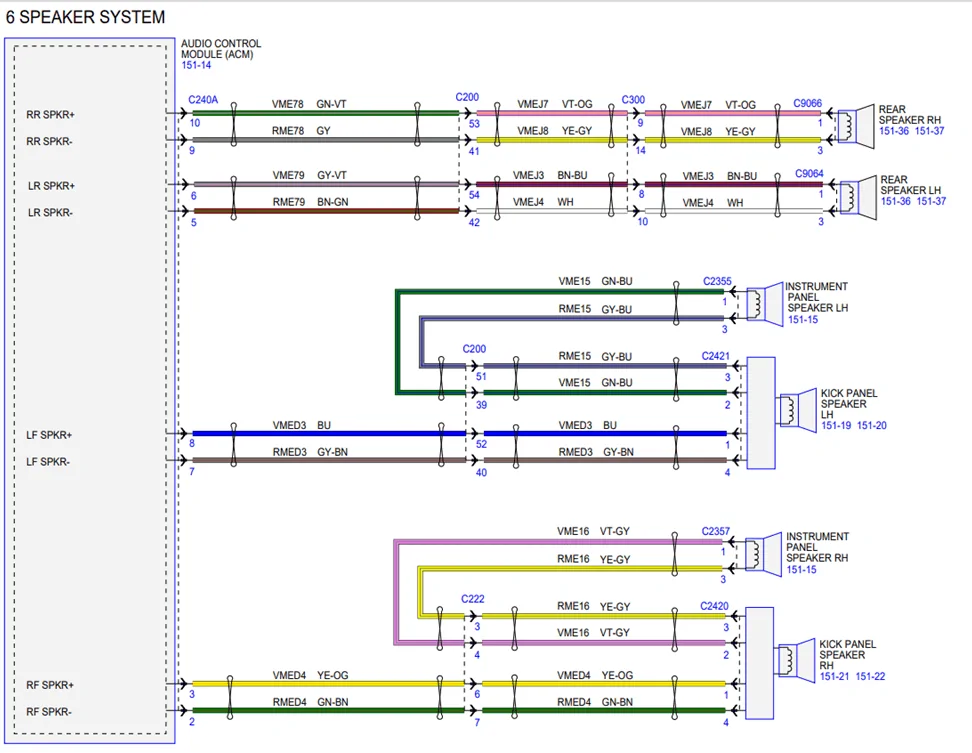

Tried to find a thread related to my issue, I’ll post it here.
I replaced dash and roll bar speakers with 4” kickers. Swapped speaker wires for dash/ roll bar, so if I fade full front I have kick panel and roll bar speakers. Full rear is now dash only. All good. Until I replaced the kick panel speakers. By removing the factory kicks and the 4 pin connectors, now I have no roll bar speakers. Where do I go from here? Thanks
Trying to figure out how you did that you would of had to run additional wires to either the kick panel speakers or the dash speakers, the dash speakers and kick panel speakers are wired in parallel

ATX
2021 Bronco Sport
Yes, the wires for both roll bar speakers run on drivers door sill. For drivers side I just directly swapped dash and roll bar wires. For passenger side I had to run jumper wires to and from passenger kick panel speaker. Everything worked fine until I replaced the 6.5” speakers. How is that 4 pin connector wired, I guess that’s my question
