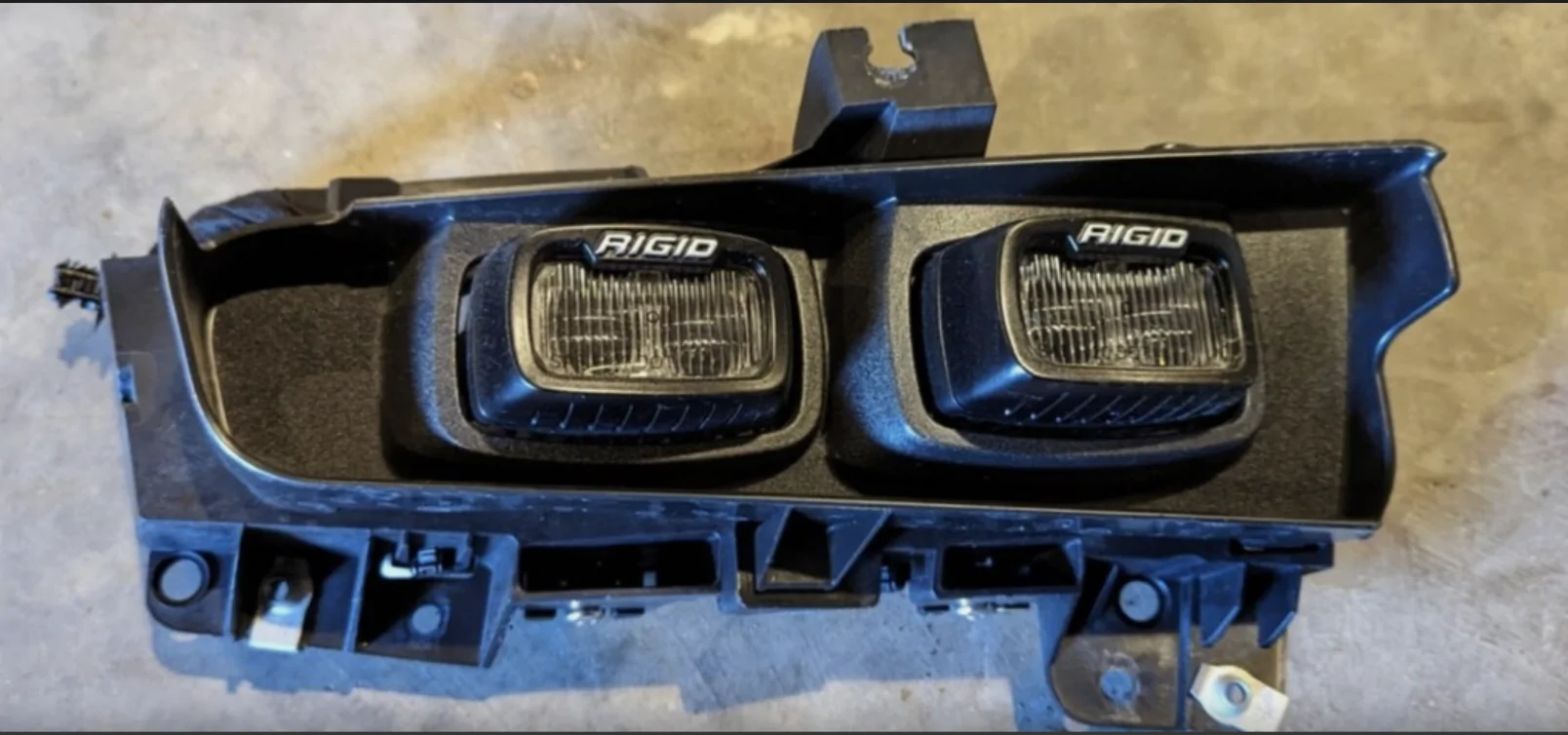

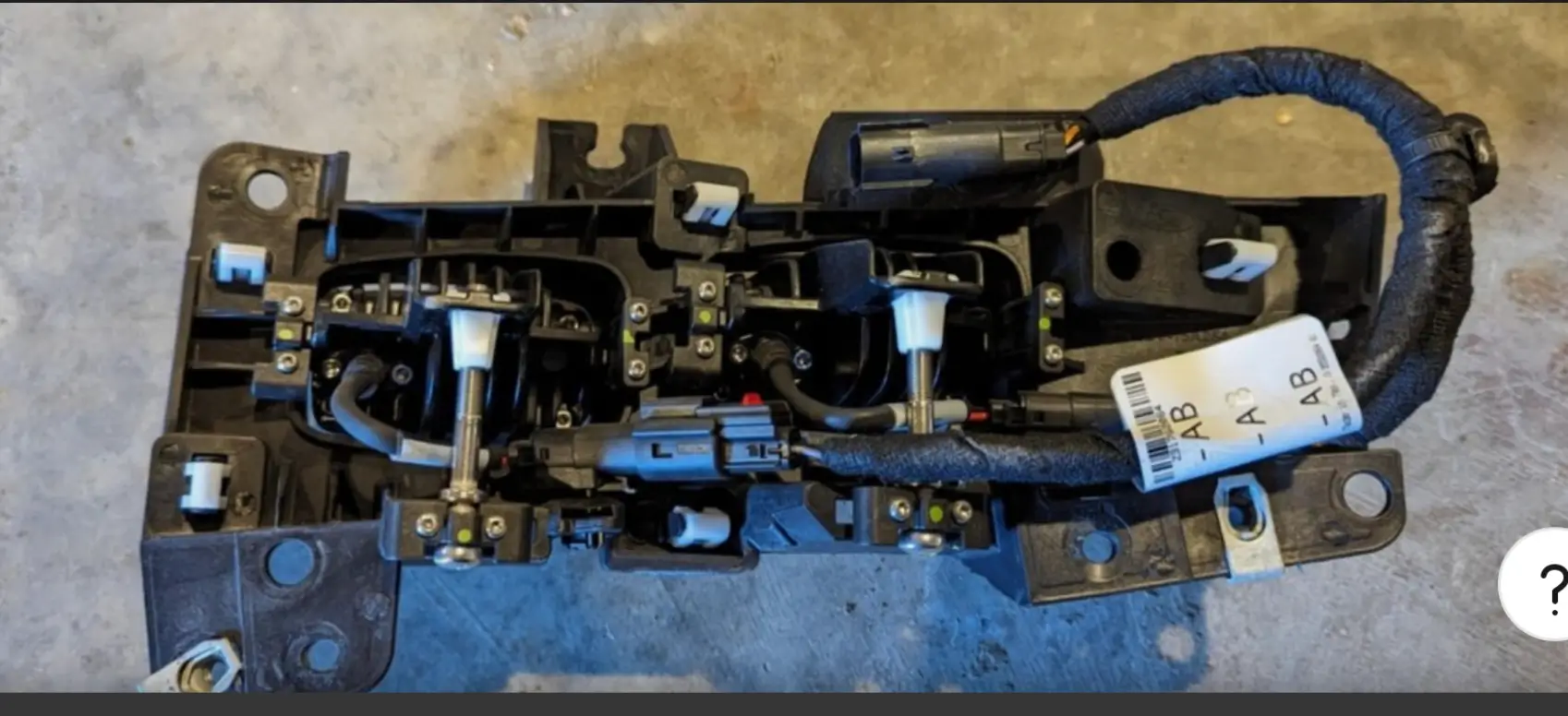

... well if you are moving the light from the outside... there are a lot of moving parts and nuts/bolts.
May need to provide a little more of what's going on? Believe it's just a couple of fasteners to remove the back cover.

Those fasteners to remove the rear cover over the fogs is a major PITA. There's probably a specific tool to remove them easily. I think I used angled needle nose pliers (big ones) to get them all out and I still ended up destroying one. But yeah, once apart, the lights are held on by a few small screws. Easy enough to tighten.
You're the first I've seen mention the issue so might just be a built on Friday thing.

Hey Q1 - Thanks for the reply and illustration. Greatly appreciate the visual... I was just wondering if there was just like 2 set screws for tightening LMAOOOO cant be that simple. Anyhow, appreciate you!
