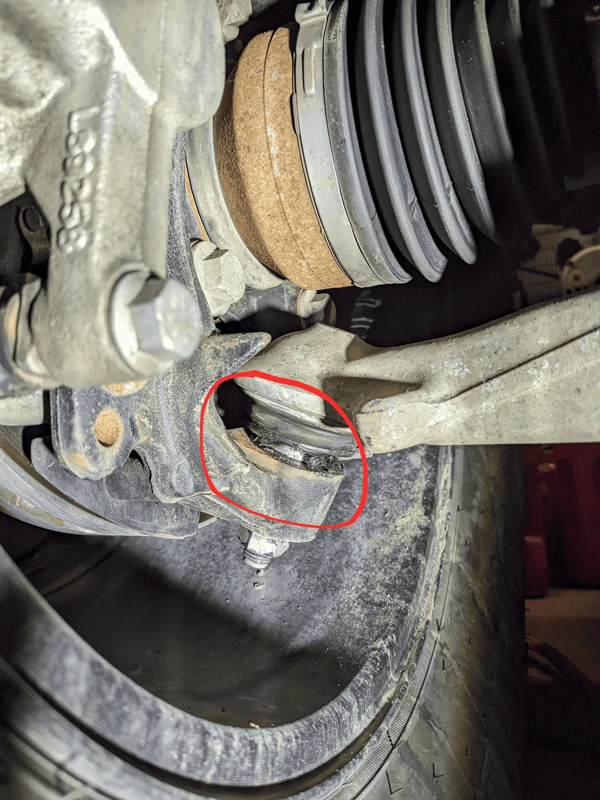

You have to replace the whole lower control arm as it's non serviceable :( Looked into that one before.
OP, take it back to your dealer. Good luck with it 🤠
@Maury I’m with Felix on this one, that entire section of the suspension is damaged and needs to be replaced, now.
I also see that you actually wheel, so I would not go wheeling until that is replaced. Why? Because your obviously shady ass dealership will try to snake out of owning the damage and blame you.
I know you’ll miss this next Moab trip, but the consequences will be much greater and costly.
Like someone said, make them order the parts and call you once they arrive. I’d also try to stand in the bay while those idiots do the install work. Up to you if you want to try getting them to give you the ordered parts then to go to an off-road shop that specializes in suspension work. In fact any shop that does suspension work can do a better job than what I see in that pic.
Good luck and don’t ease up on them. Be professional, but be firm.

I'll follow the advice of getting it addressed by the dealer (hoping they don't mess up anything else...), making sure it's a one-day thing.
Thanks all for the feedback!
