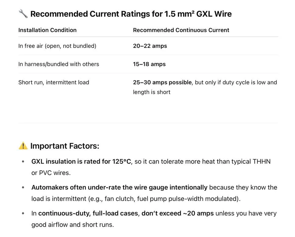

Most factory wiring uses TXL, SXL or GXL insullation, with GXL appearing to be the most common. All are rated to 125C or 257F. So a wire could feel hot but still be safe. I ran this by an AI client and it says the upfitter wiring would dissipate 8.7 watts per meter at 25.7 amps. No wonder Heretic experiences heating!
The Baja Designs S8 40" light bar would be well within the rating of the upfitter wiring. That means no need for a relay and all the extra wiring.
If you decide to go with the Heretic light bar I'd recommend their wiring kit. Then you could connect it to any of the upfitter switches. I'd recommend 3-6 because they're 10 amp and leave 1 and 2 for something that draws more current.
