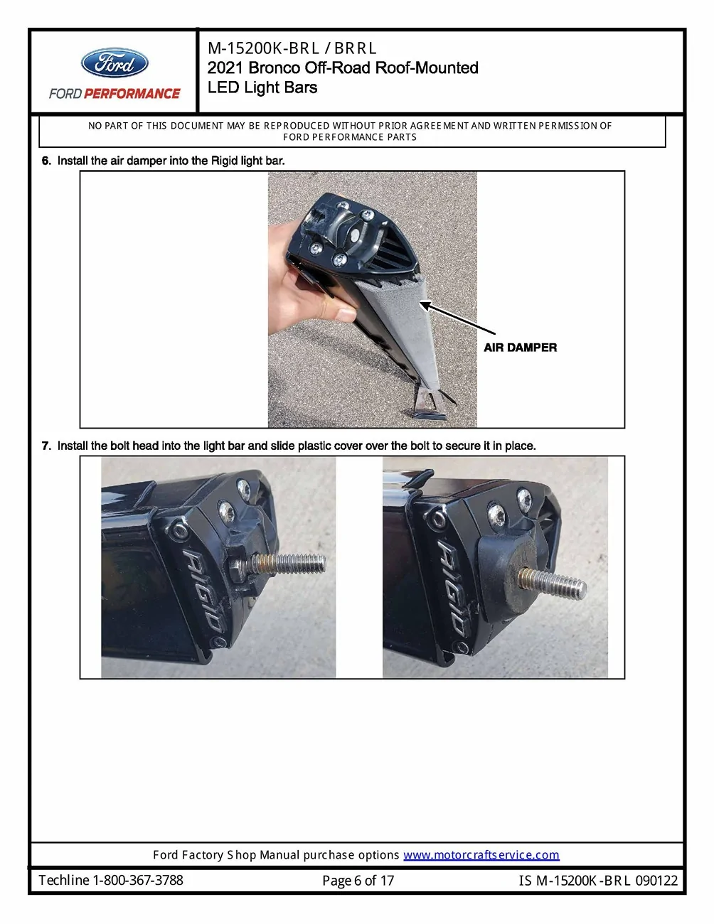

Air damper totally eliminated the whistle.
Ford Bronco Lightbar whistle fix suggestions Air Damper
I added another strip of molding on the center fin and angled the bar upward.
I think it helped, will drive around more after dinner.
How much is damper?
