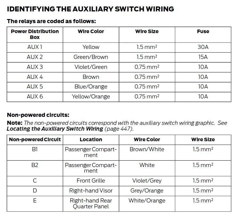

Ford lays it out pretty clearly, the size of the wiring and the amperage/fuse rating of each switch:
Ford Bronco Light Bar & Ford wire harness. settings
According to this all the wiring is 16 AWG/1.5mm2 within the vehicle, meaning you can hook up any of the Non-powered circuits throughout the vehicle.
As this shows the actual switch wiring is different as three of them go to 18 AWB/.75mm2 and it clearly states which switches can handle which amperage based on the fuses.
Most light bars are under 30A and if yours is over 15A, then you should only attach to the Aux 1 switch, (I believe this is different for the Raptor, where they would use Aux 3 as the 30A switch/fuse)
While lower gauge wire can handle higher amperages, 16 AWG in auto applications is fine for between 18 to 30 amps for 10 foot lengths.
Look at it in another way, do you really think Ford's Lawyers would let them "cheapen" out on wire sizes, especially to light bars at the roof and the bumpers where Ford sells accessories for and have it cause fires for improper wiring?
If I was running my own wiring (and I have on other vehicles) would I use lower gauge wiring for my 40" light bar, yes I would and have, but if you look at the wiring harnesses that come with these lights, my suggestion is use equal or lower gauge wiring.
For my Bronco, I will be using the pre-wiring provided with the Aux Switches, this is a gift, if you every had to run your own wiring before.

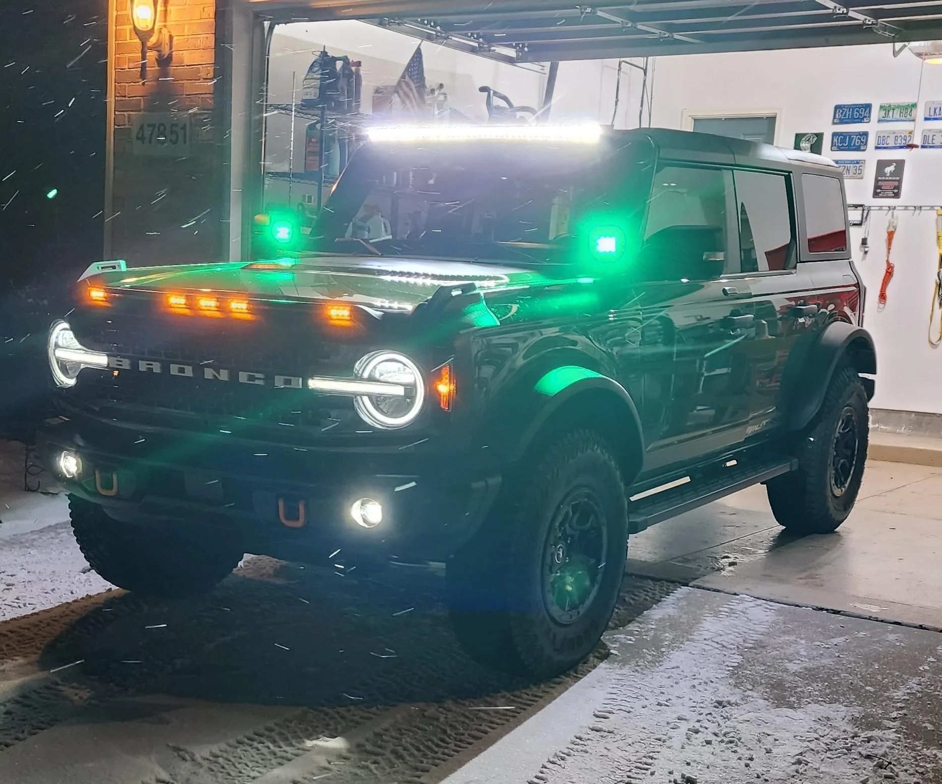

For what it's worth, my 46" 210W light bar is using 17.5 amps. AUX switch 1 (as noted) can handle up to 30 amps with no problems... and I haven't had any. The AUX switch setup system that Ford cleverly setup comes with its own relays and fuses throughout the vehicle. Very convenient and thoughtful indeed. A job well done by Ford. 👍
Ford Bronco Light Bar & Ford wire harness. 20231127_181628
