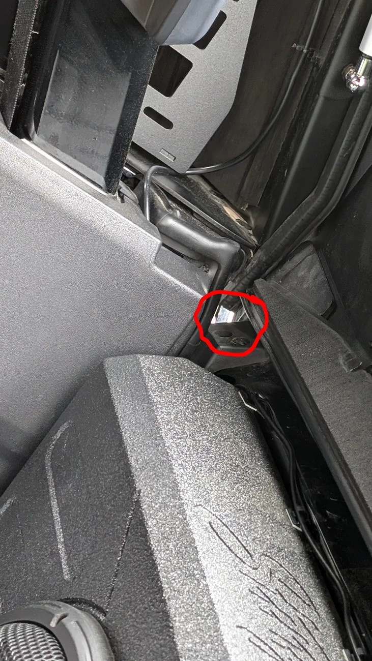

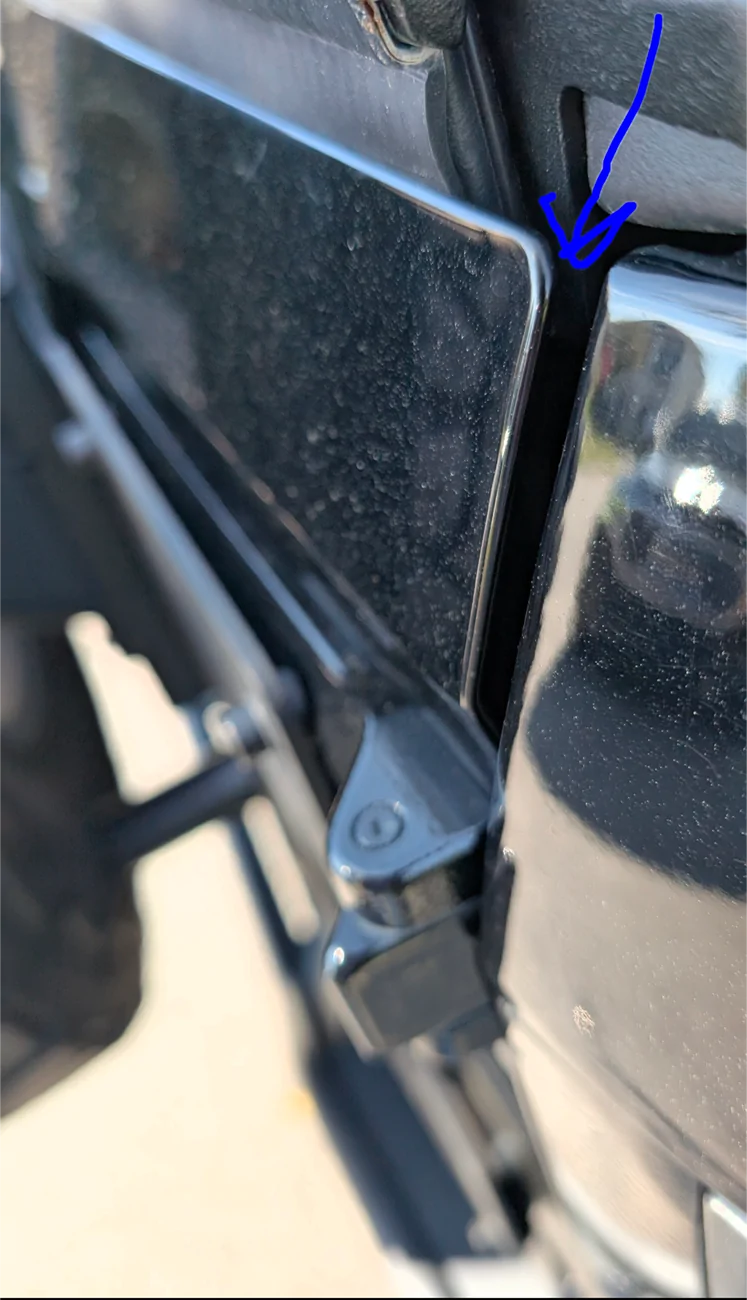

Problem we are having is there is a gap that water is seeping in. Below are the best pictures I could take. I can definitely layer some automotive grade gaskets, but I'm hoping there is something out there made for this issue. Any ideas?

Wanted to compliment your daughter on her Bronco. Looks great in all black. The gap is present on all Broncos. But the OEM HT has a "lip" gasket on the glass that seals against the tailgate. Her Bronco has an Armadillo HT. You might want to reach out to them to see if they have an "official" part. Otherwise you'll be left concocting your own seal.

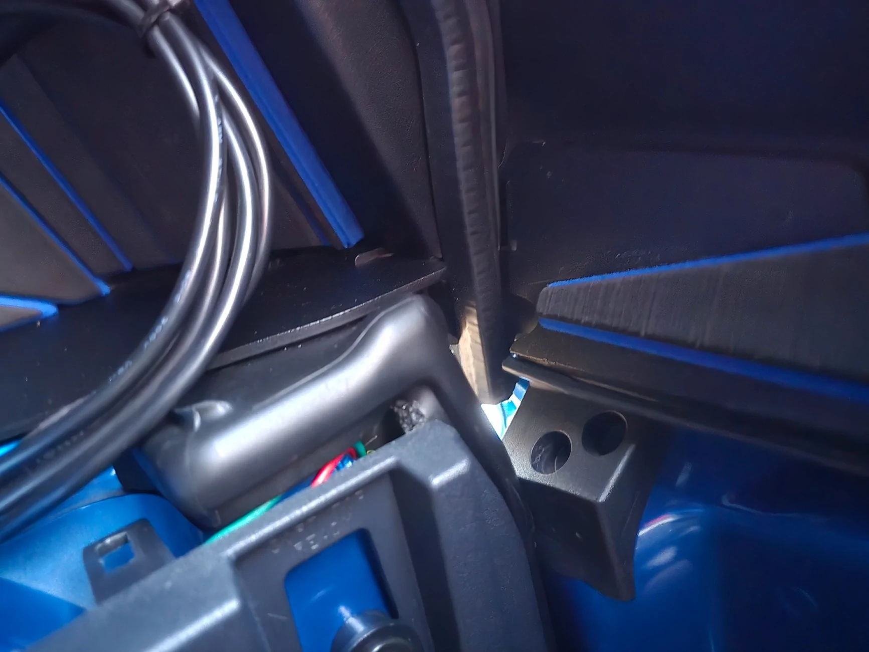

Yes, that is the "lip" gasket that I refer to on the OEM HT. The Armadillo HT that the OP's daughter has doesn't have that.

I have a Rallytop and the gap isn't that big, but it still leaks
I just layered some small pieces of weather stripping there. The leak isn't 100% stopped, but it went from big puddle in the back to a few drips when it rains.
