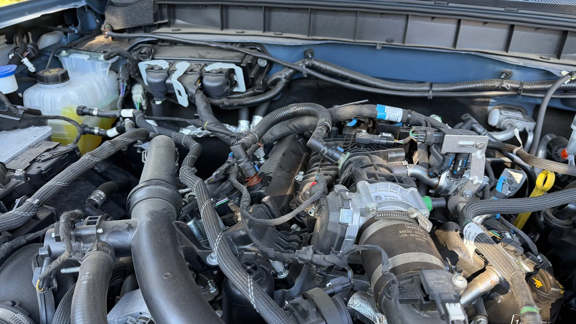

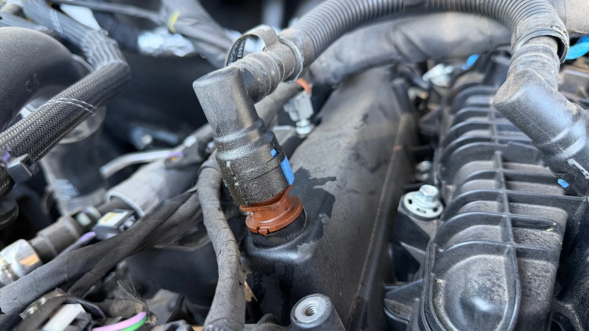

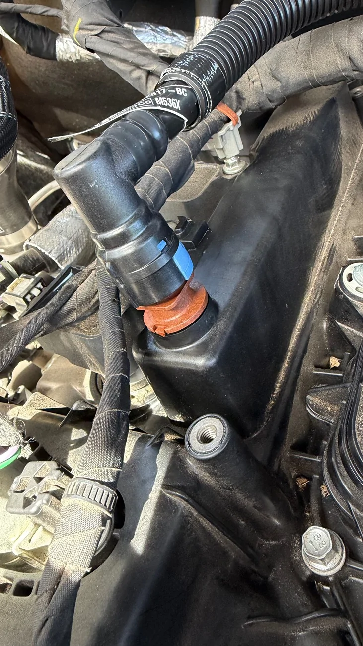

Just wrapped my third trip of Spring/Summer on my 2025 Badlands SAS at 15,000 miles. I opened the hood and saw this.
Before I bring it in, does anyone know what this problem is called?

Hit it with some brake or carb cleaner and see if it comes back.

Looks like a warranty trip to the dealer for a new purge valve to me.
Kudos to Ford however for putting it right there on top for ease of access, as the PCV is certainly an important component that does wear out (clogs) over time. Not 15,000 miles kind've time, but someday kind've time. I've had cars where the $15 PCV cost $800 to get to...

I drove over today and scheduled for Monday. They're ordering a new hose ahead of time. TBD, but I expect that should take care of it. Will update when I know more.

Looks like a 2.3??? which is known to have leaky baffles maybe Radium has the alloy one for Bronco also need catch can dirty side at a min
It’s a 2.7 (sry, I should have stated earlier). But noted re: baffles

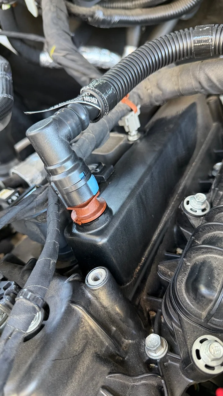

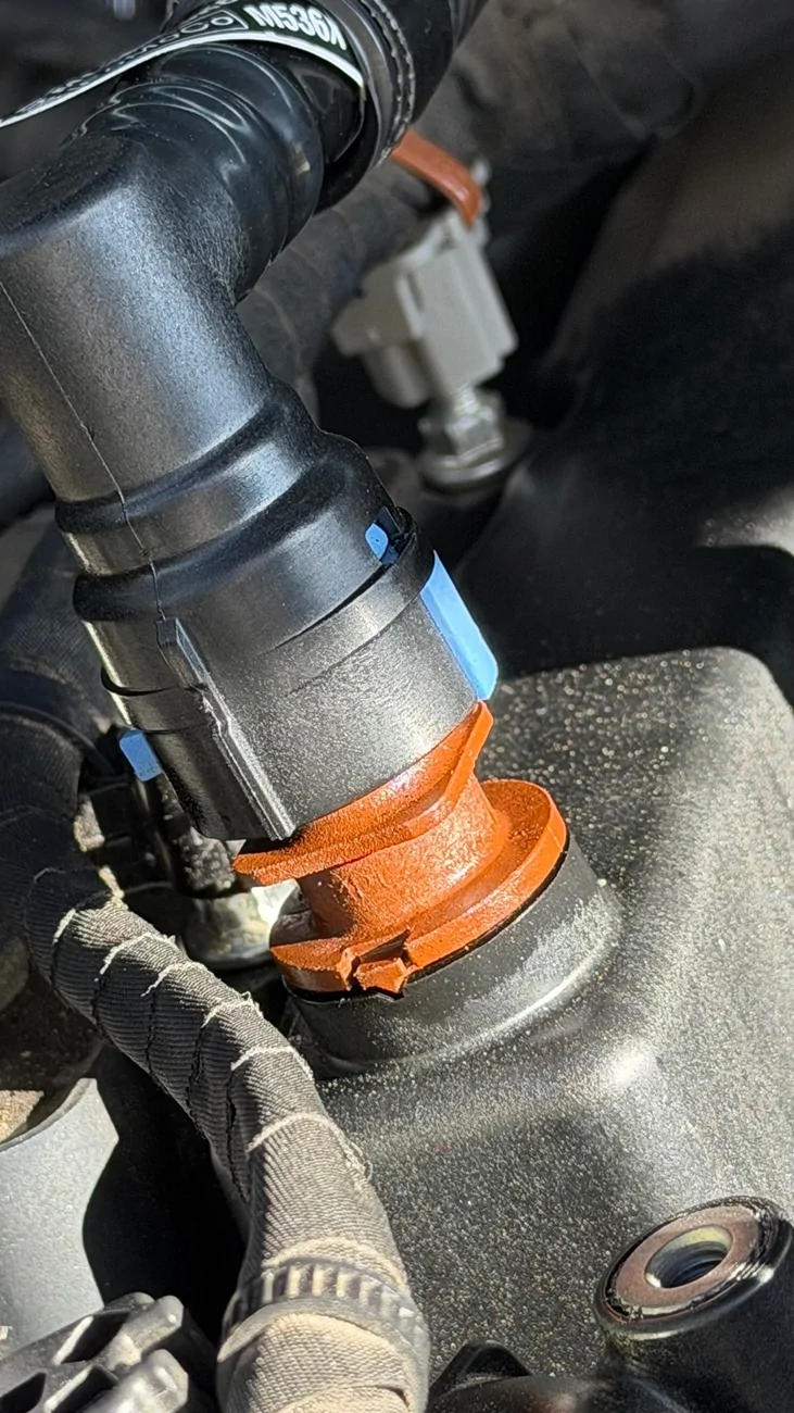

Update:
Just got my Bronco back from an overnight at Ford.
They wrote:
Inspected for leaks at engine and confirmed only leak present at top of valve cover PCV hose from intake manifold to passenger side valve cover. Checked for TSB/SSM, found nothing related. Recommend recommended to replace PCV hose and recheck. Performed replacement of PCV hose after cleaned of oil, residue, found no further leaks present.
I now have a new hose which looks to include a clean fitting.
While at Ford they also completed the following recalls/updates:
26S09C infotainment screen blank (seeming already installed but listed at nhtsa and on my ford app as incomplete)
26S30 front seat height adjustment bolt
26P04 Powertrain control module software update
PCV hose, and software updates took a day. Front seat adjustment bolt recall took a morning.
Truck is good as new again.
