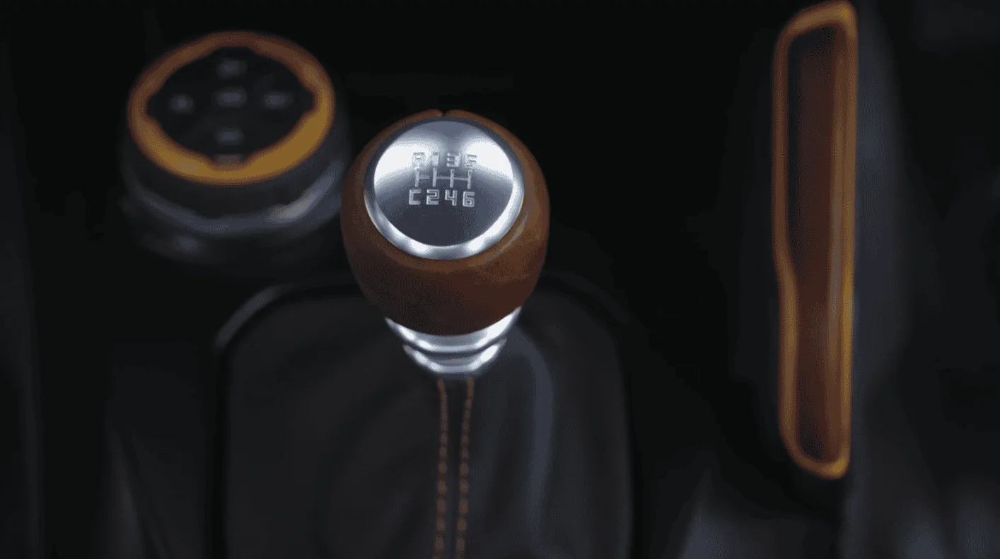

I am not sure of the synchronization or lock-out mechanism Ford will be using with Bronco, however, with my 4WD Honda Civic, 6spd manual transmission, the crawler gear (They called it "Super Low" or "SL") had a mechanical lockout. and also synchronization.I’ve owned MTs but never with a crawler gear. Does anyone know if you can shift from crawl to first while moving? Or do you have to come to a complete stop before shifting over and up to 1st?
Good info. That makes sense on the RPM ”lock” - I’m interested in the clutch less application. You don’t mean that the truck will idle in C without the clutch engaged, right? That would be very interesting... do you just mean you can feather it more easily before stalling? Or that you don’t need the clutch to shift to 1 from C?I am not sure of the synchronization or lock-out mechanism Ford will be using with Bronco, however, with my 4WD Honda Civic, 6spd manual transmission, the crawler gear (They called it "Super Low" or "SL") had a mechanical lockout. and also synchronization.
Meaning, the vehicle had to be somewhere between 500-800 rpm (idle was ~700 rpm) and at a vehicle speed of between exactly 0-2 mph in order for you to be able to manually enter SL. At any rpm or speed over that, you could simply not synch the engine speed to the SL gear and you were entirely locked out. That was also a mechanical in that SL was in the same location "on the knob" as you see in your image above, however, in reality, SL was about 3" further left from 2nd instead of 1/2" (note: It was a 6-speed, not 7-speed, so "6" in Bronco is where the Civic's Reverse was)
For Bronco, i'm expecting the more modern approach that has become tried and true.
- Vehicle speed must be between 0-2 mph
- RPM must be at or near idle
- lift the ring below the shift knob to manually disconnect the pin blocking the gate
- Additional pressure leftward or downward (depending on what gear is "above" SL to engage the synchros.
- *Guessing at this one* Ford has touted the SL not needing clutch application or some method of smooth roll off from a stop. Could simply be a function of the 95:1 crawl ratio (assuming 4.7 gearing), i'm not sure.
If it’s like other transmissions with a granny gear there is no issue shifting from the straight cut first gear to the spiral cut second. It is shifting down into first while moving that is where the problem is. You can rev match but the gear is so steep that it is a pain so it is best to be stopped or at least almost stopped. That said, if you are rock crawling and you need to downshift into first you probably already had to stop anyway.I’ve owned MTs but never with a crawler gear. Does anyone know if you can shift from crawl to first while moving? Or do you have to come to a complete stop before shifting over and up to 1st?
