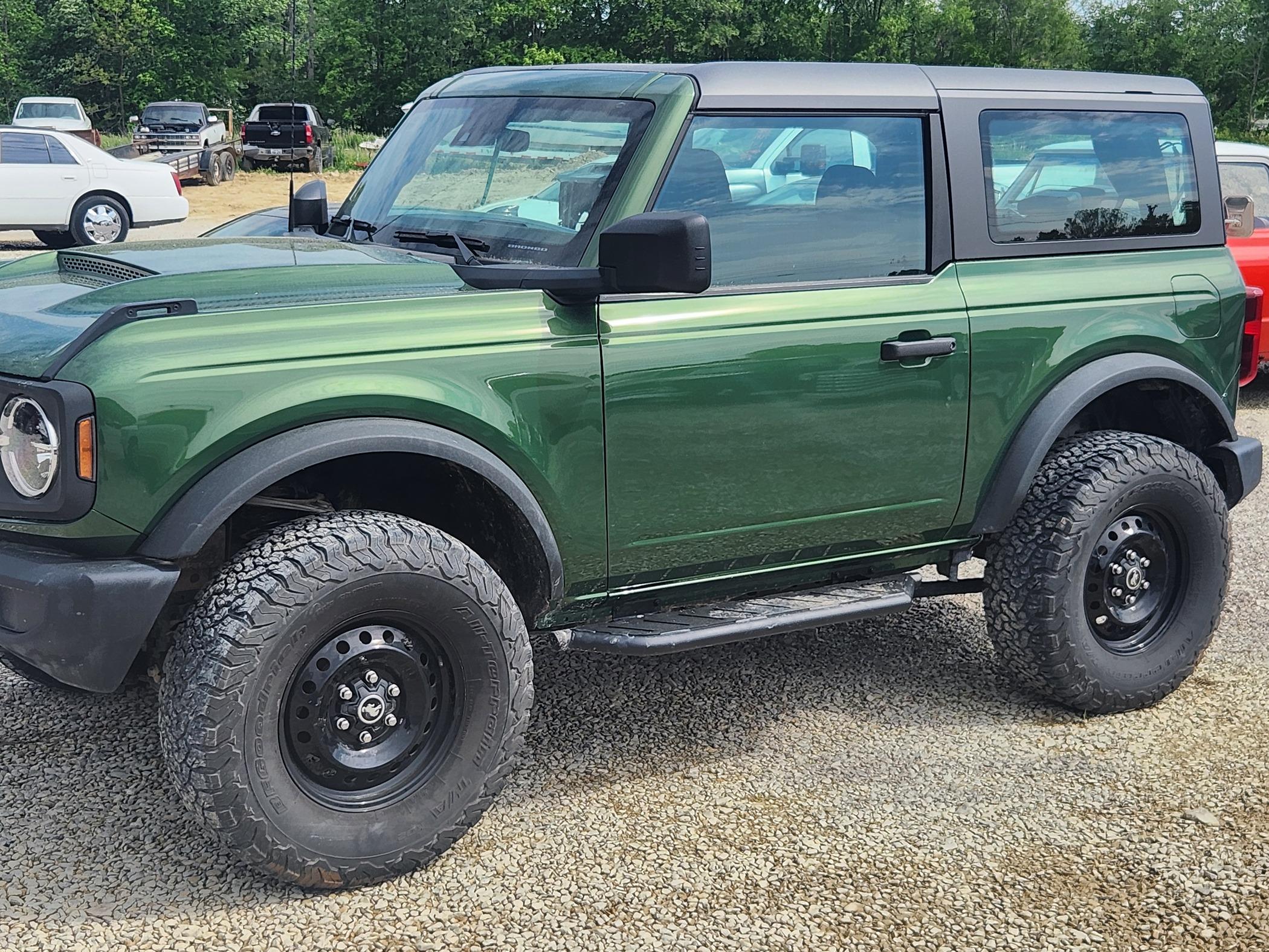

I run BFG Trail Terrain T/A tires 285/70/17. Fills out the wheel wells nicely for a 2-dr.

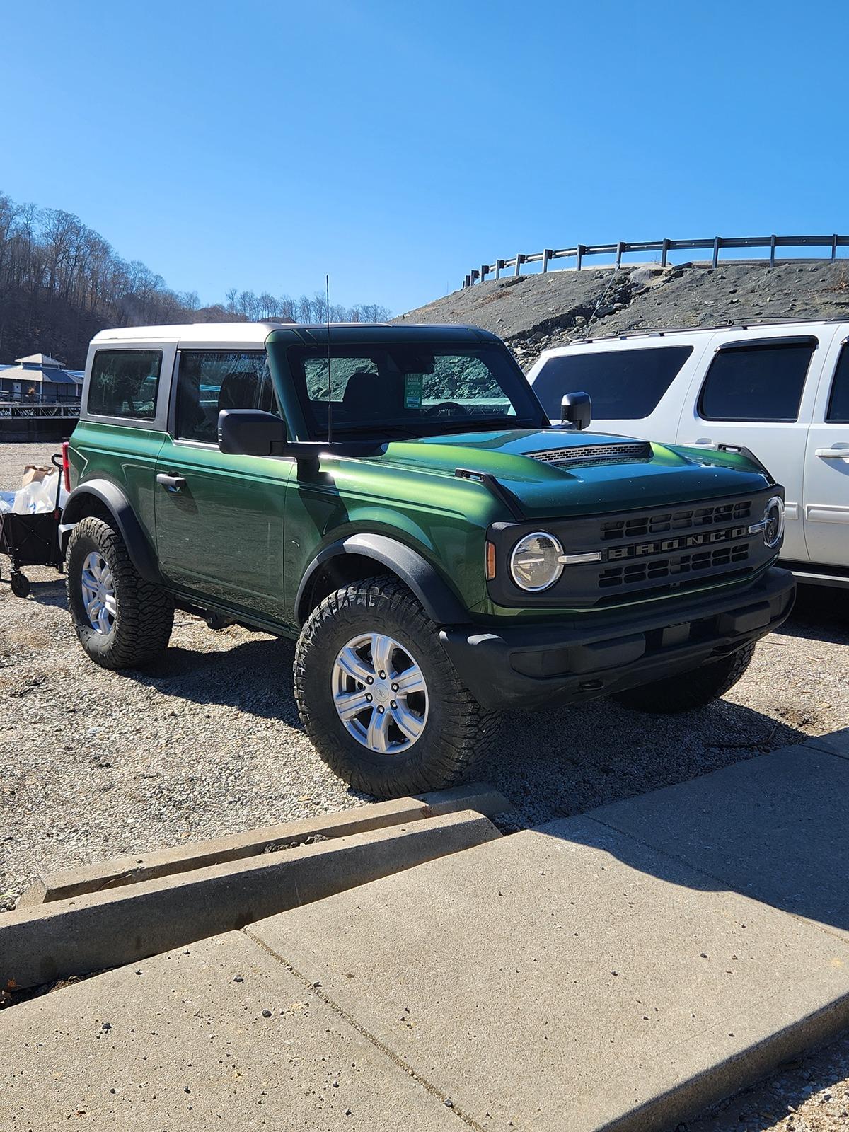

I went with 285/70/17 on my stock BD with no problems but have since installed Bilstein 5100 set for about 1.5" of lift. I have K02's and like them a lot, not a lot of road noise.

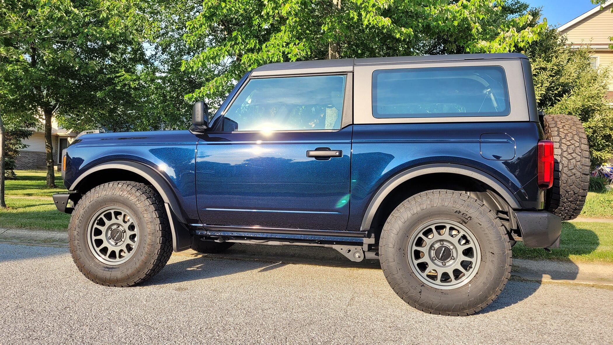

I run 35 x 11.5 - 17 (34.4") . I removed the crash bars.
No rub in normal street driving, very light offroad.
Wish I had a some lift, just for better visual perspective.
Methods +35mm offset.
