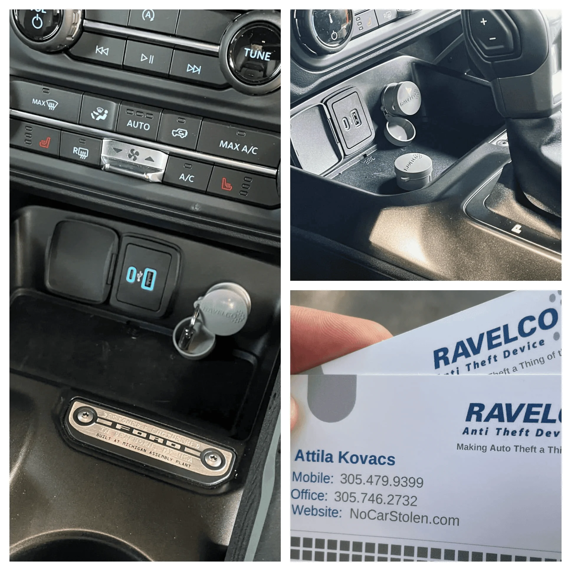

Dave, I'm glad that you admitted the red herring. A kill switch, whether a proven system or a home-brewed concoction, won't prevent a vehicle from being towed and hacked for parts. That wasn't the premise of the thread. The thread was discussing kill switches.
Ravelco is a proven system. It isn't cheap. I have no affiliation with the company or the installer. I posted the image as a member of a local FB group just had it done. I thought it was a clean install and their cost was about $600.
