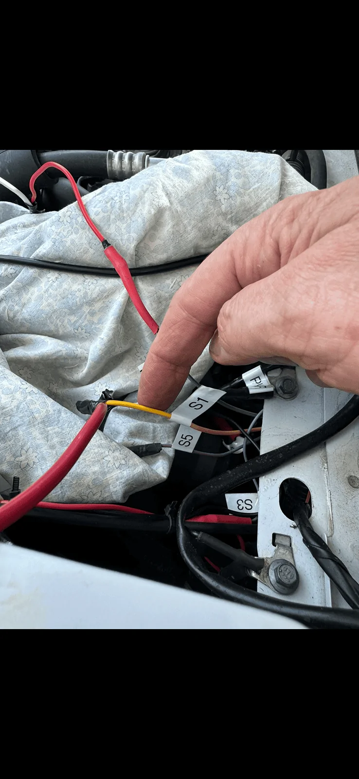

Yes needed some input from anyone please. Just purchased the new KC Gravity Titan 50” light bar. I chopped up my wiring harness like Taylor from KC did on his video “Complete Wiring Guide for your Gravity Titan Lightbar” and used option 3. Well the Amber switch (white wire) to Aux 2 worked great. But when I connected the (red wire) to Aux 1 it worked great as well. I turned the switches off and turned my Bronco off, I then went to disconnect the s so I could do a more clean install. White wire came off without a hitch but when I went to remove the red wire, it was so hot I could barely touch it. Even had that burning throbbing feeling for a couple of days. So not sure if the 50” White light option is to powerful for the Aux 1 switch? Or maybe the wiring size is too much, meaning the red wire is a good 4x bigger that the yellow Aux 1 wire on the Bronco, could there be so much power going through the red wire and when it gets to the tiny tiny yellow wiring it can’t handle the power load. Going to attach some specs of their light bar and specs of the Bronco Aux switches and also post a picture of the red wire connection to the yellow wire. So any input would be helpful. I did order a new wiring harness in case the Titan bar is to powerful for the Bronco Aux 1 switch and I’ll just go with the old school wiring option. But that kind of defeats the purpose of the Aux switches.

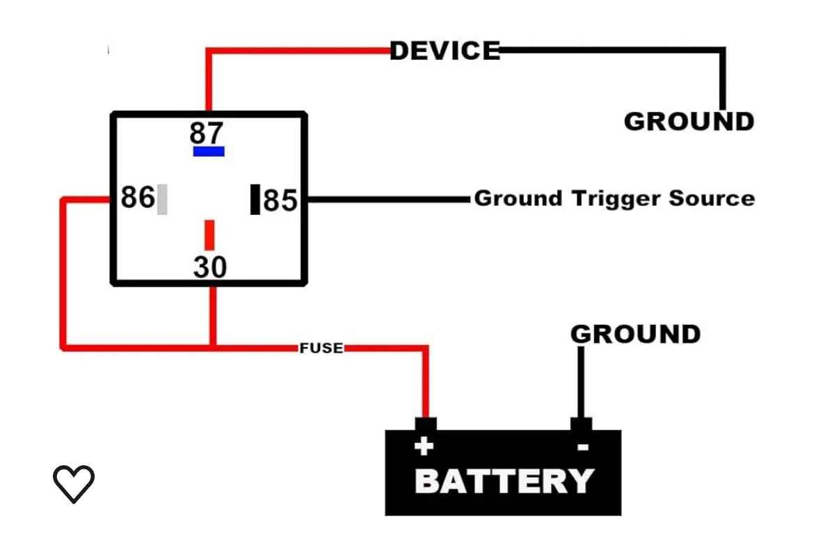

Relays are pretty easy, you can follow a YT video if you aren’t 100% sure how to do it cause they are all the same more or less.
Something like this will work then you can use your upfitter switches as intended.
https://a.co/d/hXq8dEM
Ford Bronco KC Titan Lightbar IMG_2927
Edit: Do a bit of research on the relay and if another one is recommended go with whatever is recommended, this was more an example of what to look for and I’ve never used that particular one, just wanted to give you an idea of what to look for.

I used the option 3 on that video where I ran the white wire to Aux 2 and the red wire to the yellow wire Aux 1 and grounded the black wire to the ground on the frame right above where the wires to the Aux Switches are located. Both lights worked but the yellow wire that was connected to the red wire got very hot and would burn my fingers just touching it. So again I think this new light bar might be too powerful for the factory Bronco Aux Switch 1. Going to try it again and this time ground it to the battery but doubt that will matter. Just want to go with a clean look in using the Aux 1 instead of drilling a hole in the dash. I also did reach out to KC and was given this same video and some other advice but still had the same problem. But just reread his message to your ping, in the video for option 3 they remove all the supplied relay and fuse from their wiring harness and only have the white, red and black wires left. Now option 2 they leave the relay and use it with a secondary switch system like a switch pro or Auxbeam which I don’t have. Do you think if I leave the relay on like option 2 and wire the white to Aux 2, Yellow to Aux 1 and the red to battery positive and black to battery negative, again a big newbie to wiring.

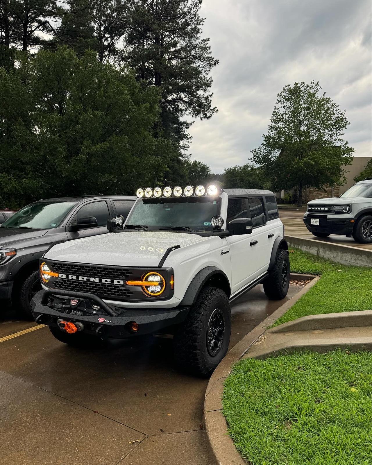

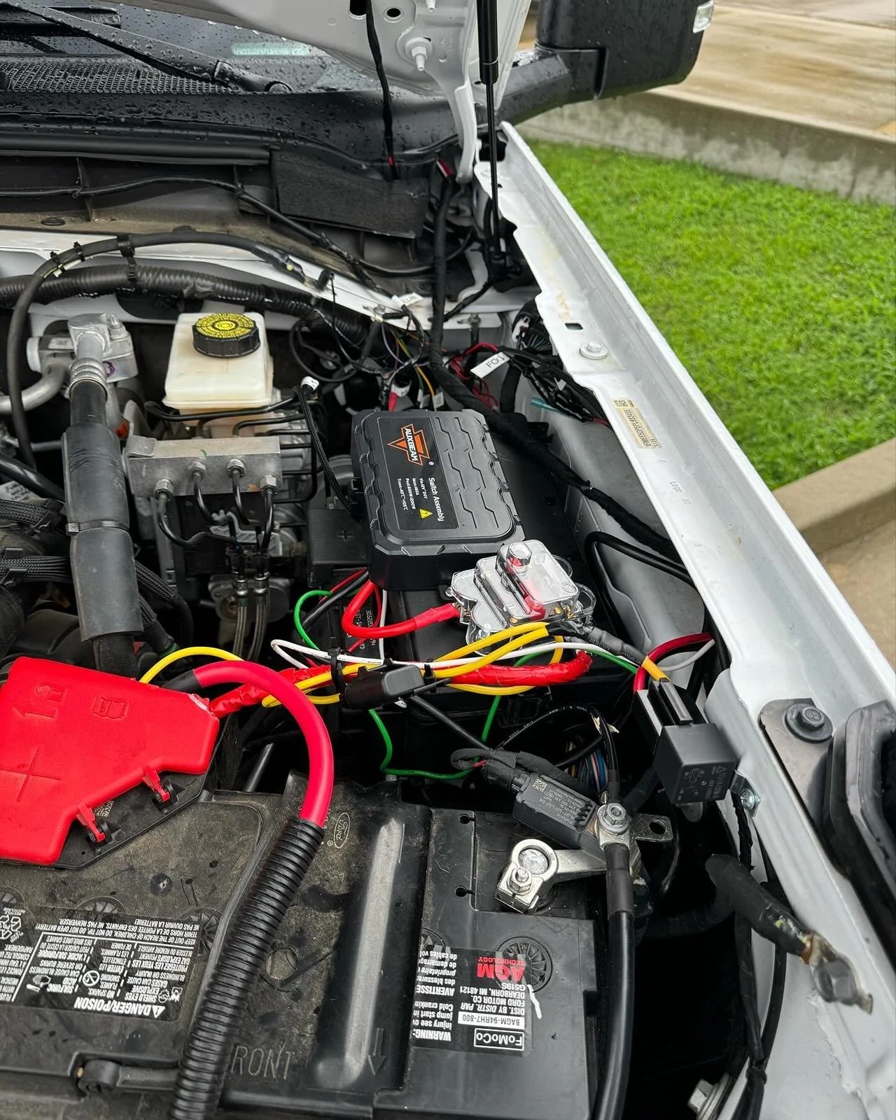

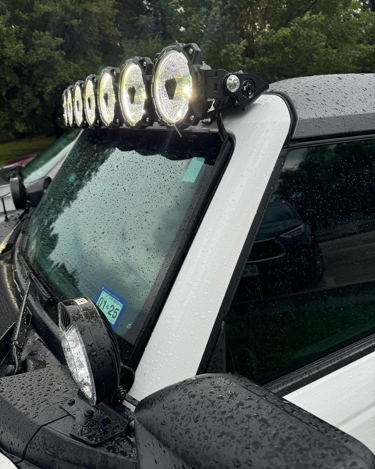

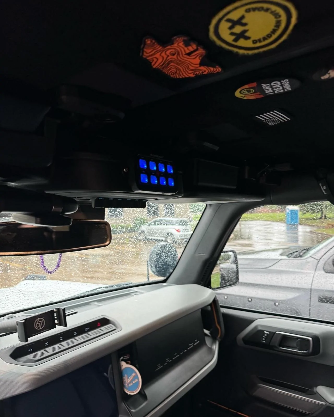

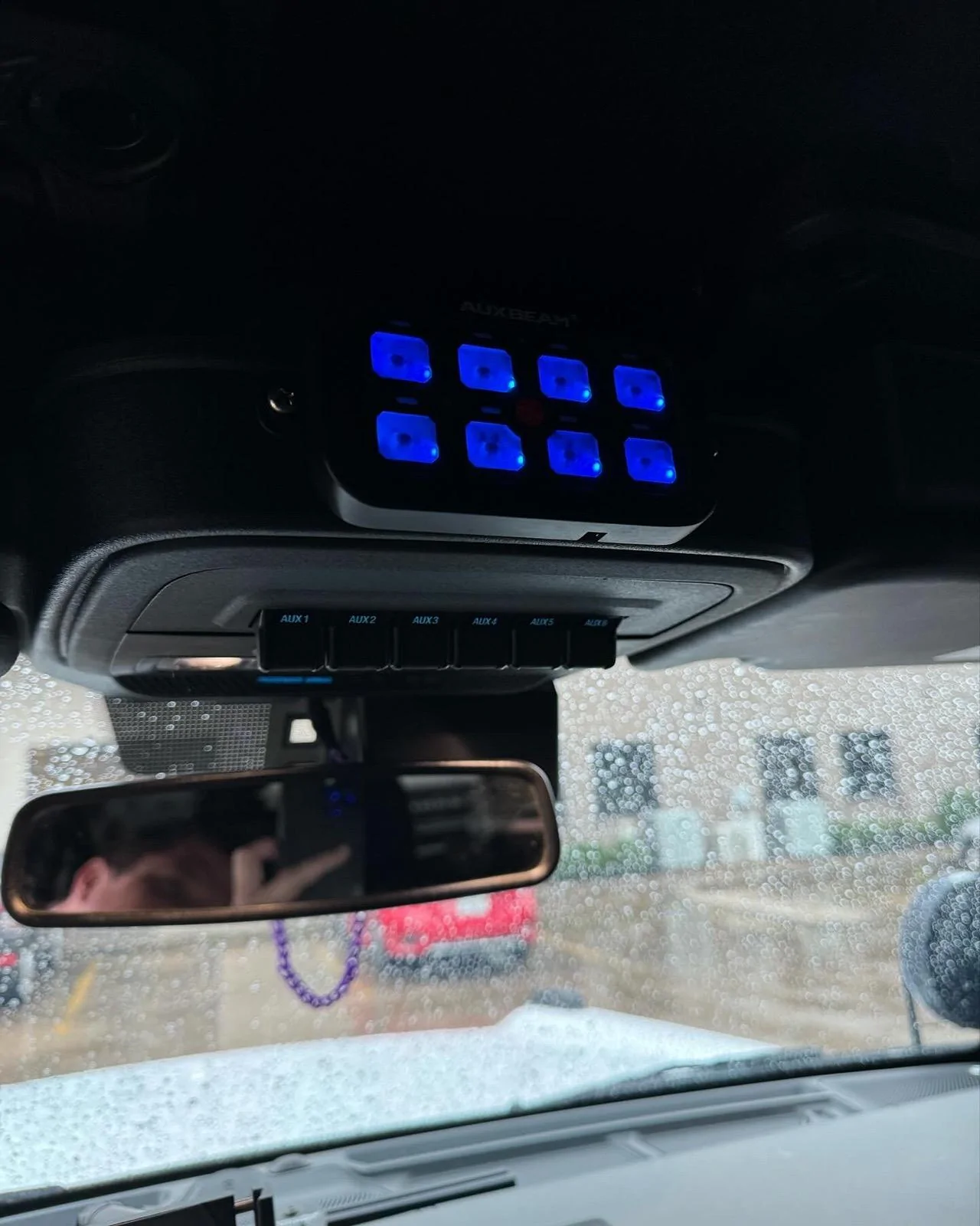

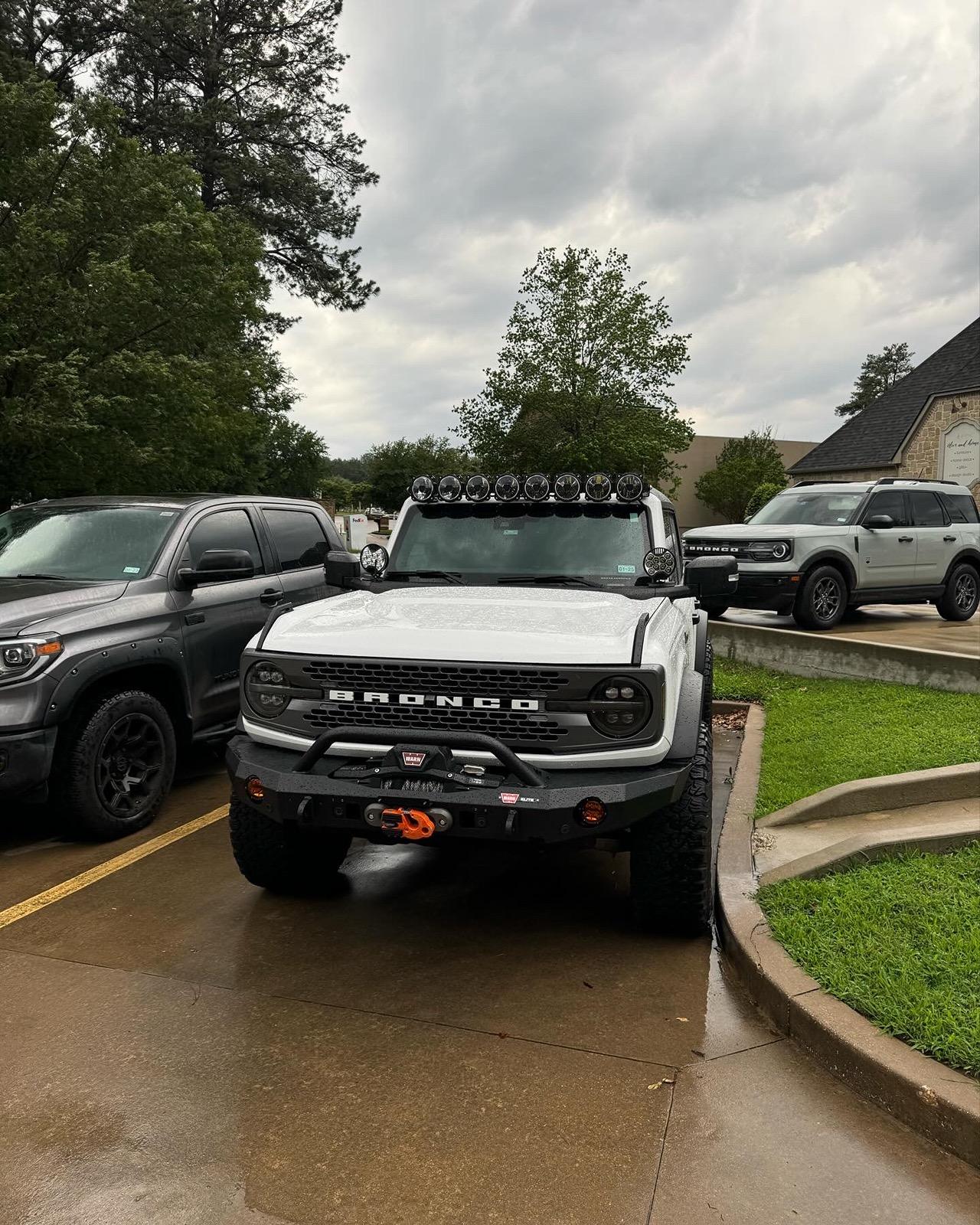

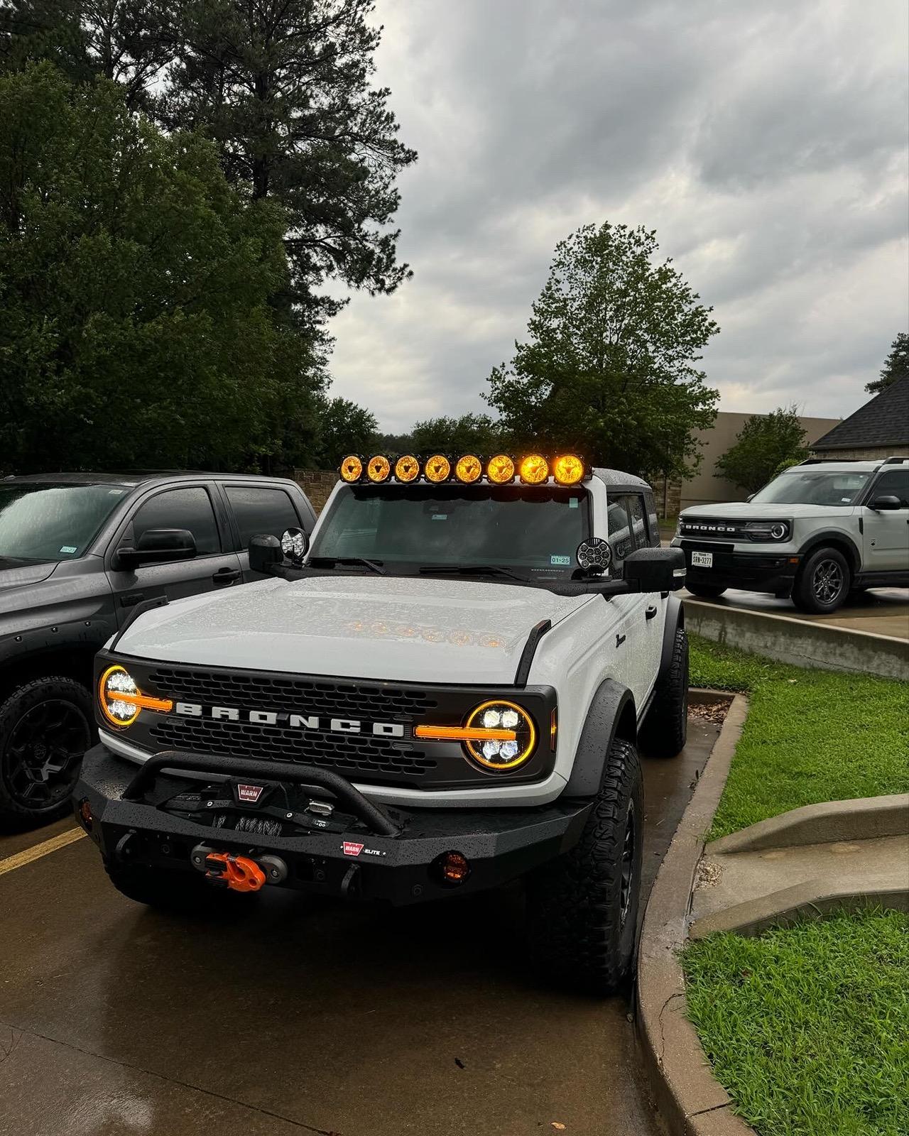

Update: I got the KC Titan Lightbar installed, still wasn’t able to install it to the factory Aux switches. Appears that the lightbar is to powerful for the Aux switches so I ended up installing a Auxbeam switch panel system and was able to use option 2 of KC’s wiring choices. Now I have like 16 accessories switches which is a bit of an overkill unless you want to be a mall crawler. Still had to drill a hole on the inside on the upper plastic trim surrounding the factory Aux switches but at least all my accessories switches will be in one general location. Not a 100% satisfied with my wiring but I’m new do maybe I’ll clean it up in the future. Posting some pics but nothing really in detail of what I did.

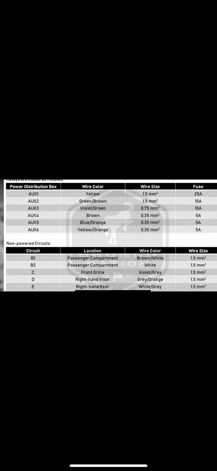

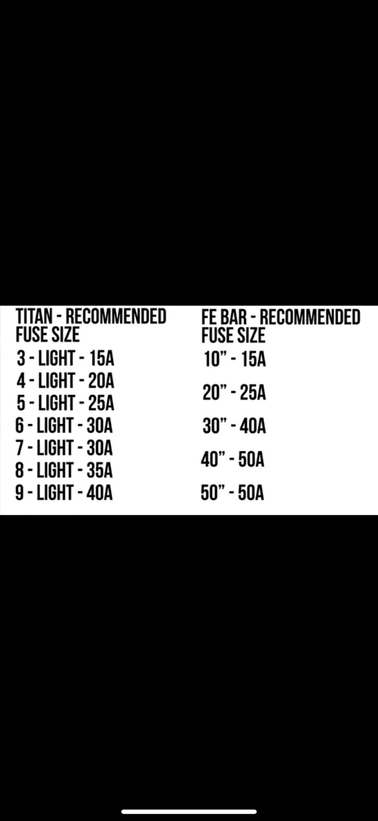

I currently have the pro 6 wired up to aux 3 of a bronco raptor.
wire is 1.5mm and relay onboard is at 30amps
in theory this set up should work and not have any issues as the white light on the gravity titan is drawing 24amps while the amber is on a separate circuit with less than 5.
i would like to switch out the pro 6 to gravity and wire in the same way using onboard power and the reduced harness described in config 3.
my question is did op have a separate issue as his relay was only rated for 25 amps or another issue with the splice points?
Again in theory the onboard power wire at 1.5mm thick should be able to be chassis wired with a rating up to 30amp and I should be able to just swap out the pro 6 for gravity and rewire to the same onboard contact points above passenger a pillar and under glove box.
Hey just bought my Titan, and was wondering did you just run the new auxiliary wires through the drivers side pillar, and then have it connect into the auxillary box from there?
