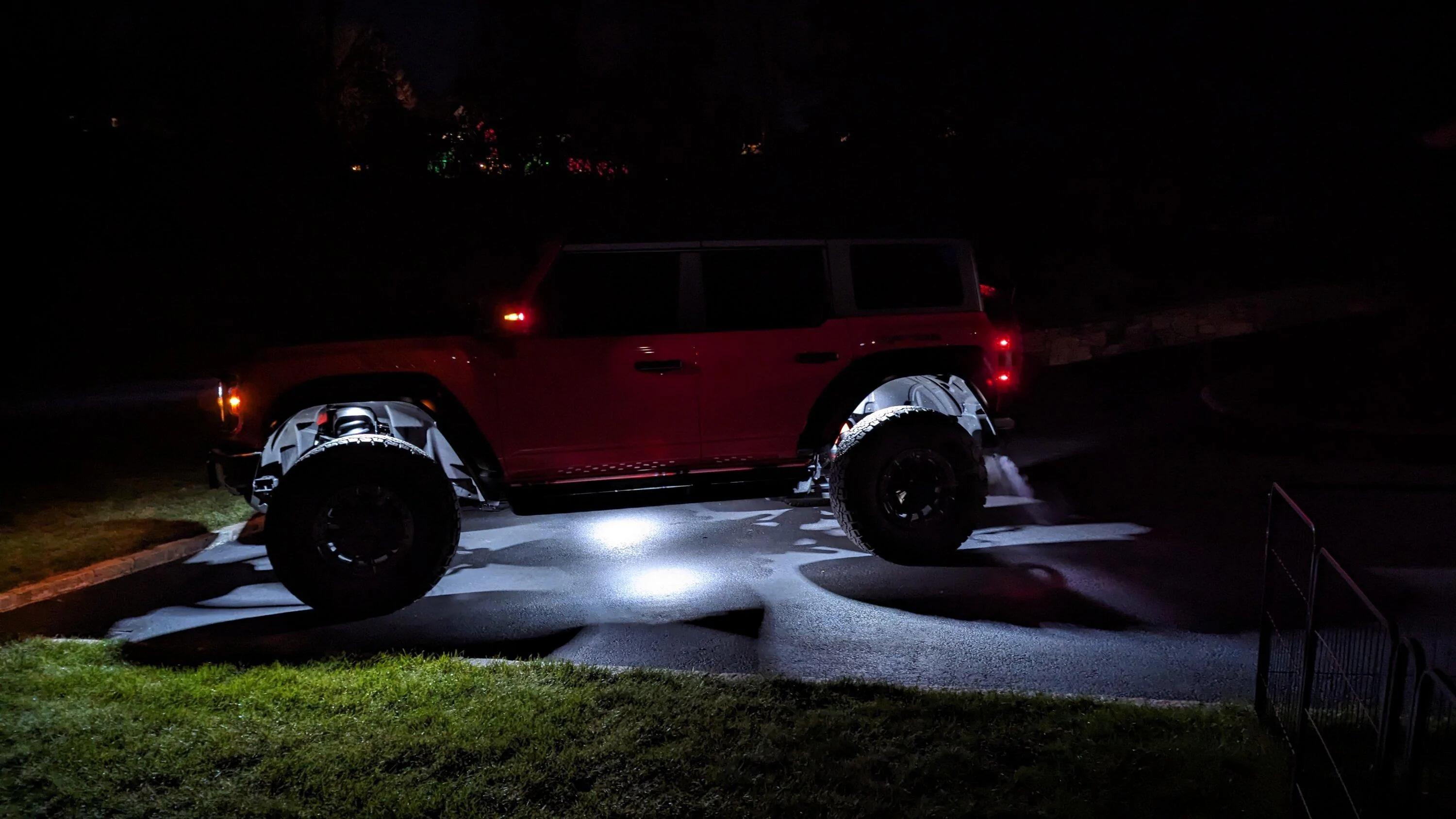

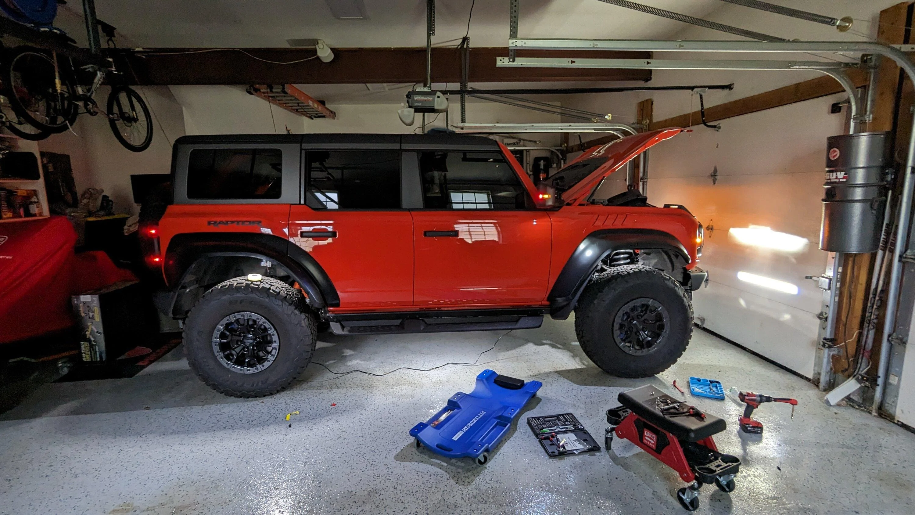

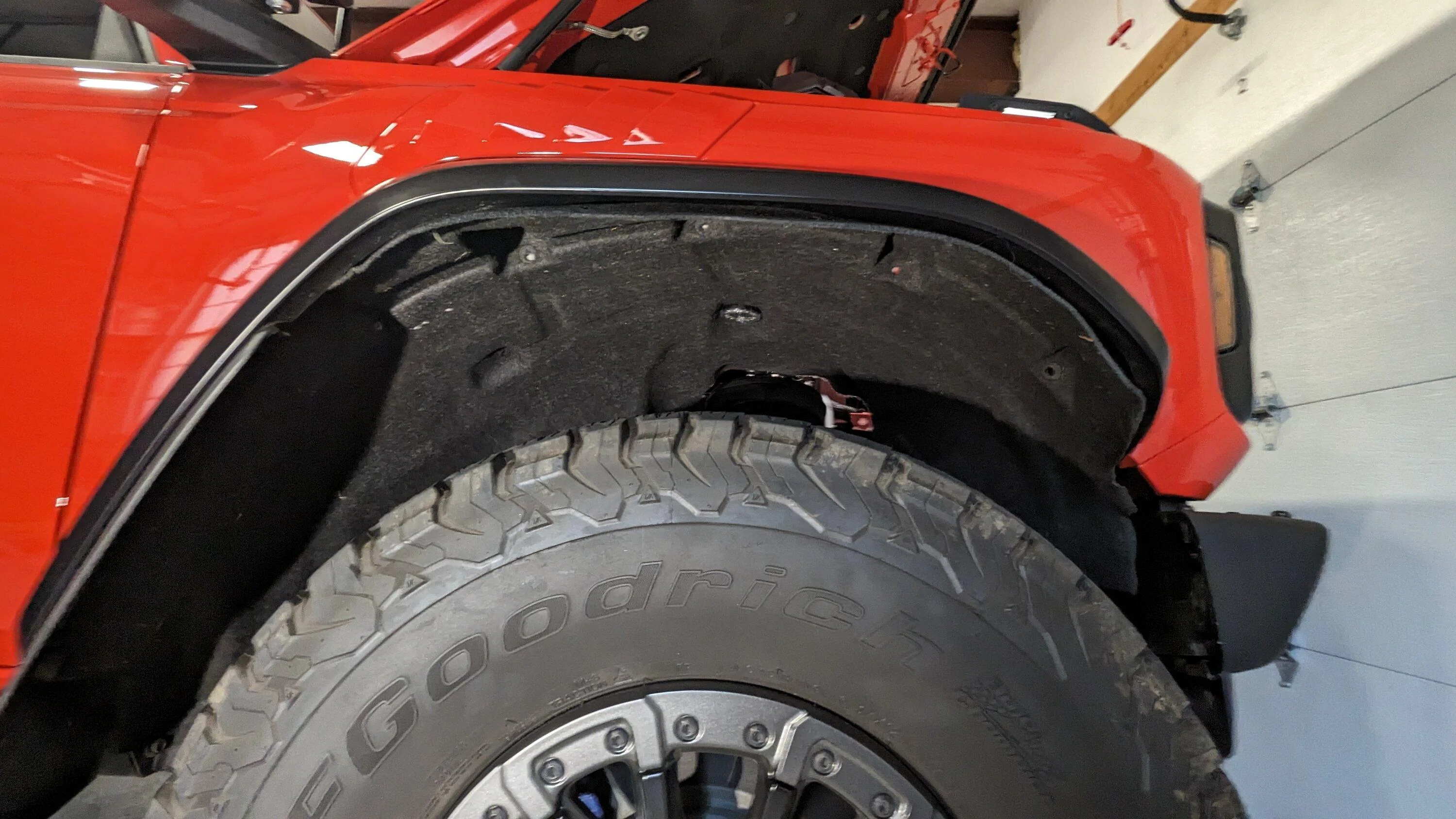

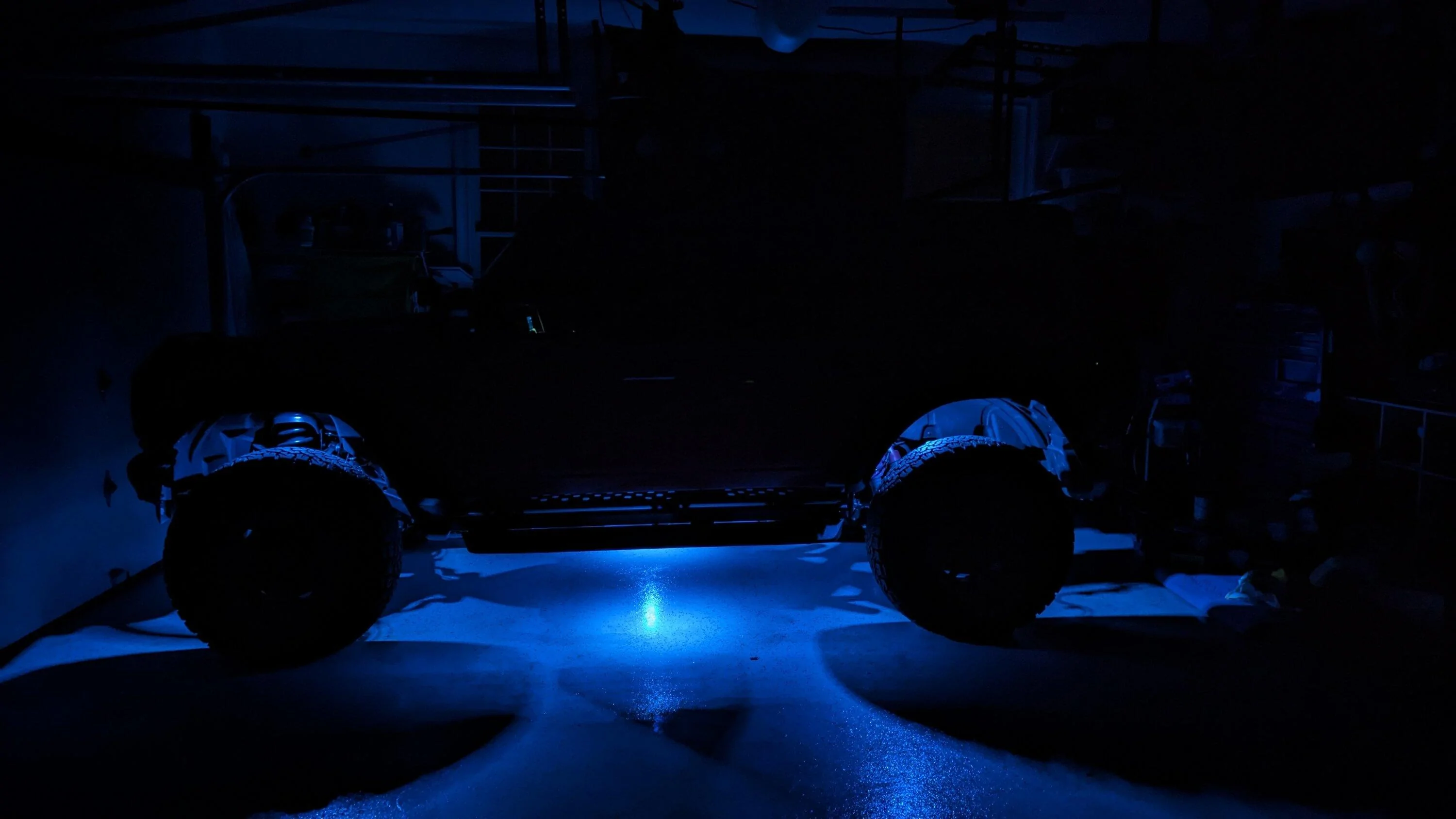

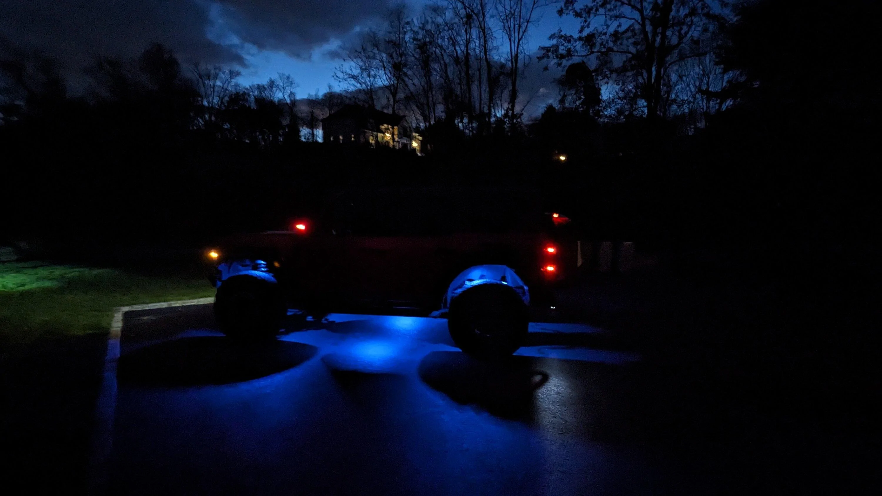

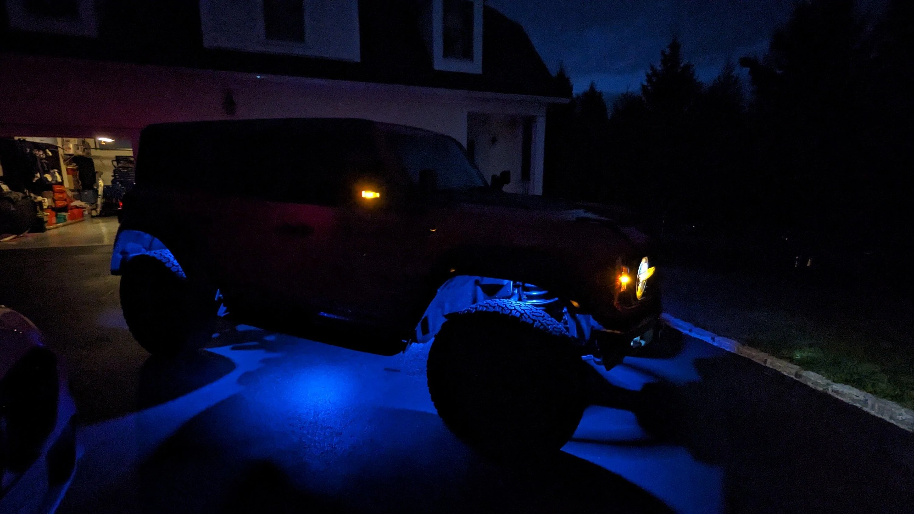

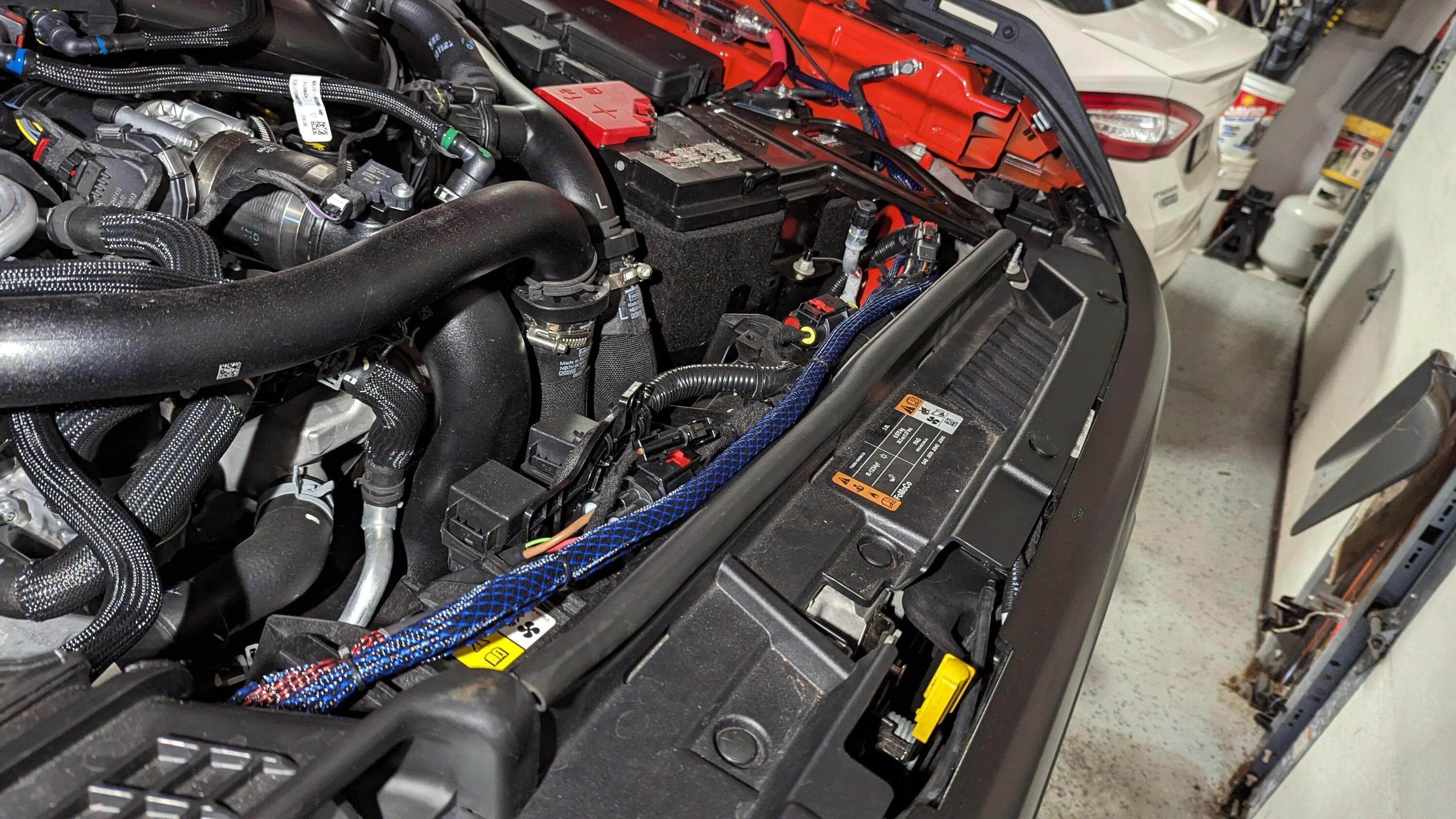

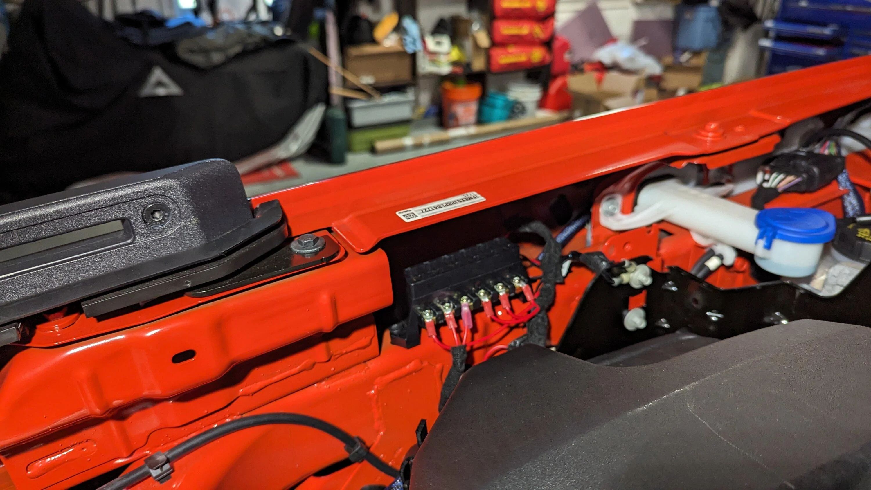

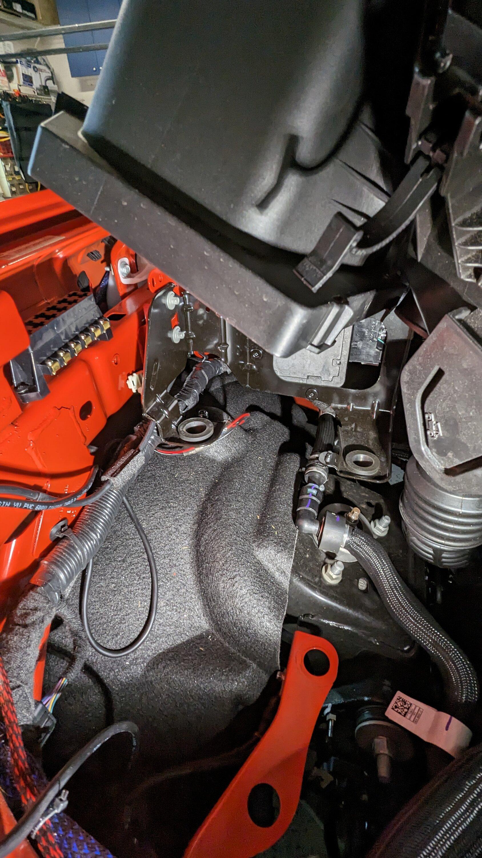

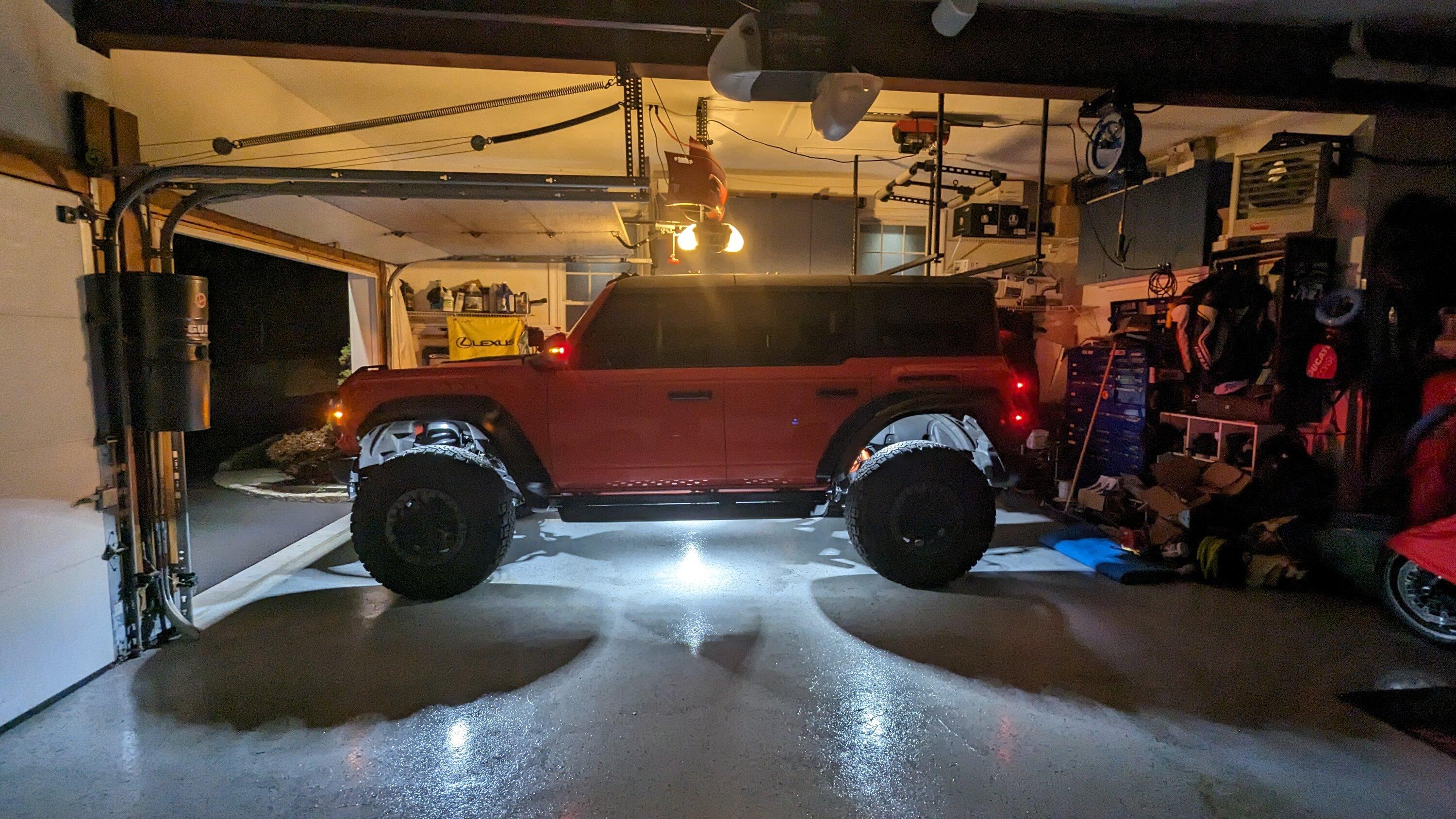

Spent the day Saturday working on this. It took the better part of the day. Clear white is too bright for my needs I think right now. Decided to swap out to the blue lenses for now. 6 light kit, reasonably happy with the placement of the lights so they aren't completely visible in the wheel wells. Wired up to Aux switches but still used the KC Buss bar included with the kit. I did however consolidate the grounds on each side from 3 into 1. Oh and if you mount the buss bar on the passenger side - the drivers rear wiring from KC (5m) wil be too short and you need to extend it. I actually ended up extending the 3.5m and left the 5m on the middle light.

For function or just for looks?

If I can overcome my fear of f-ing up my truck and getting out onto some trails - I guess function, but for now - I was bored and liked the look.
