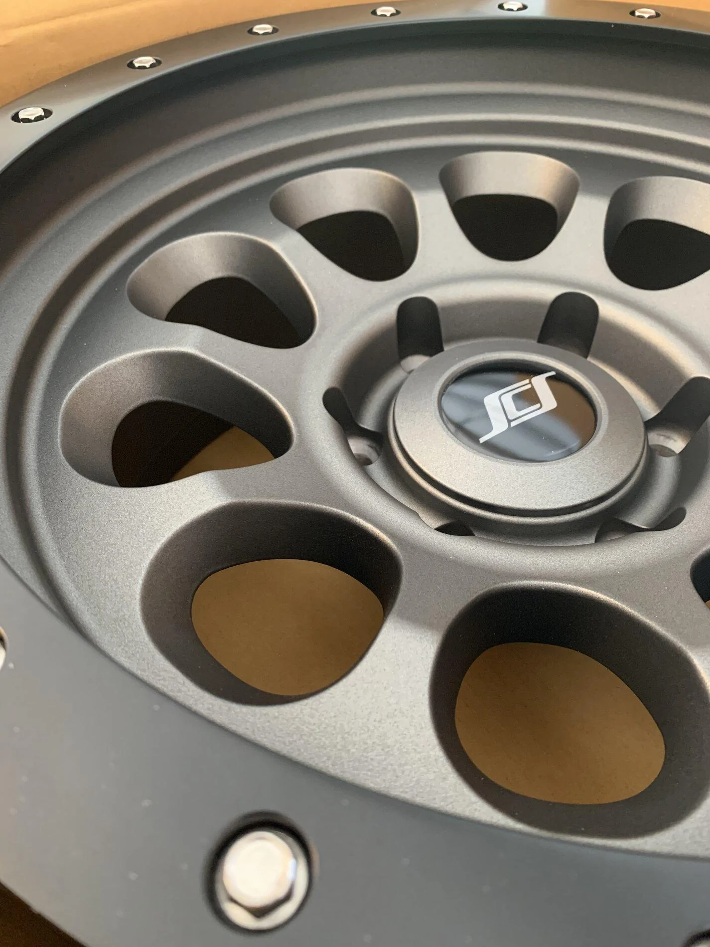

I love SCS (Stealth Custom Series) wheels. Am considering the Ray10's for the Bronco. They are typically made for Toyota but the bolt pattern is same as the Bronco. Only issue is the center bore size, I think a center ring adapter should do the trick. Now figuring out the offset...I am also considering Method 310 Con 6, maybe Fuel Revolvers or American Racing Baja. I want to go for a retro look on Bronco.
I looked at the sizes and the Bronco has a 93.1 mm wheel hub and the Ray 10s have a 106mm wheel center bore. Just need 93.1 to 106mm Hub Centric Rings.
Question: does it matter if you get nylon or aluminum on hub centric rings? I figure the metal is stronger but I have never felt with them before.
Nylon is fine.
As @JCAntimatter noted, Nylon would work. In fact most of the Hubcentric rings we carry are actually plastic.
This is due to the purpose of the hubring is not to carry any load, simply to help during installation to center the wheel onto the the studs. Once the lugs are tightened down the hubring serves no purpose.
