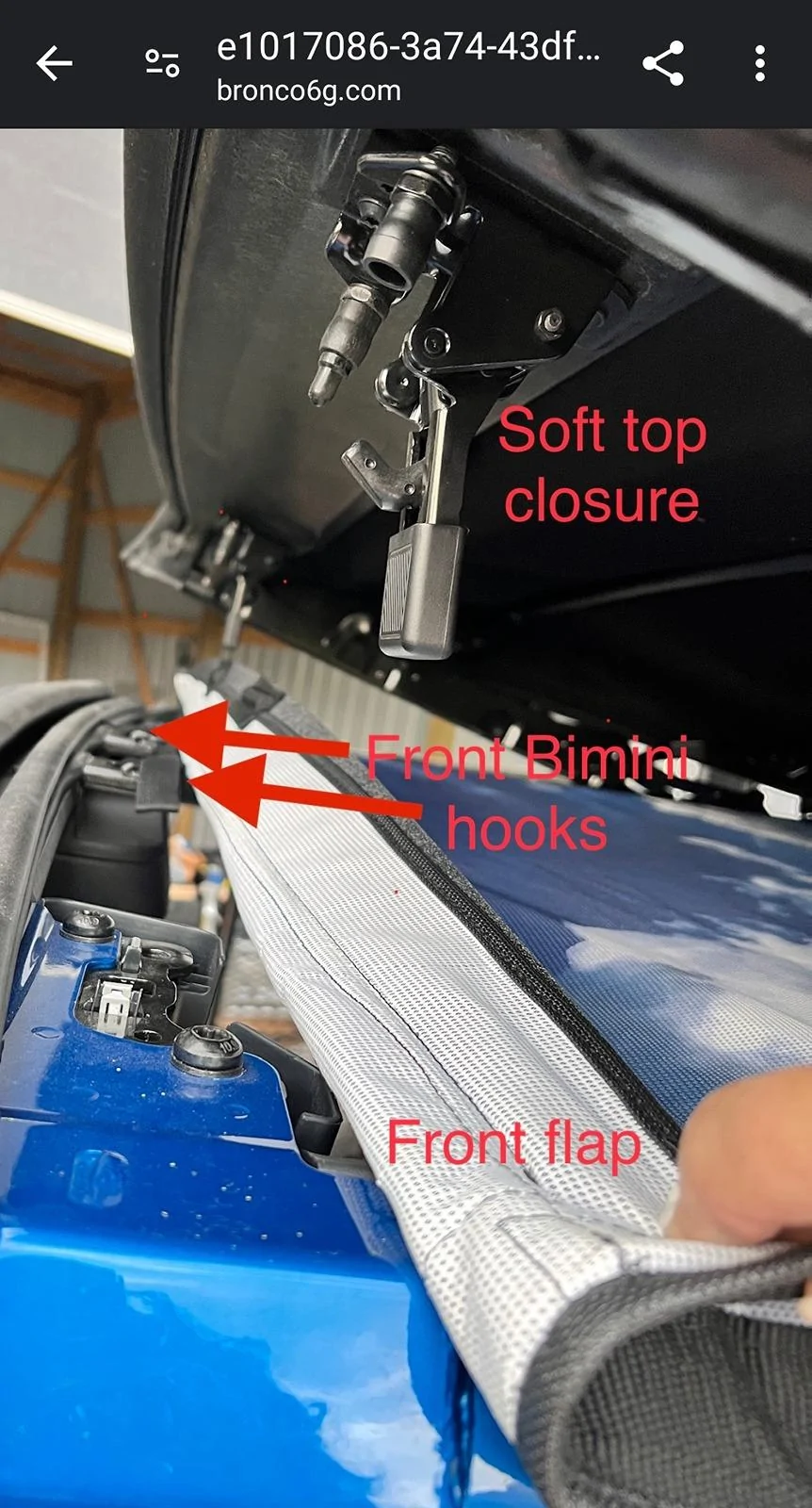

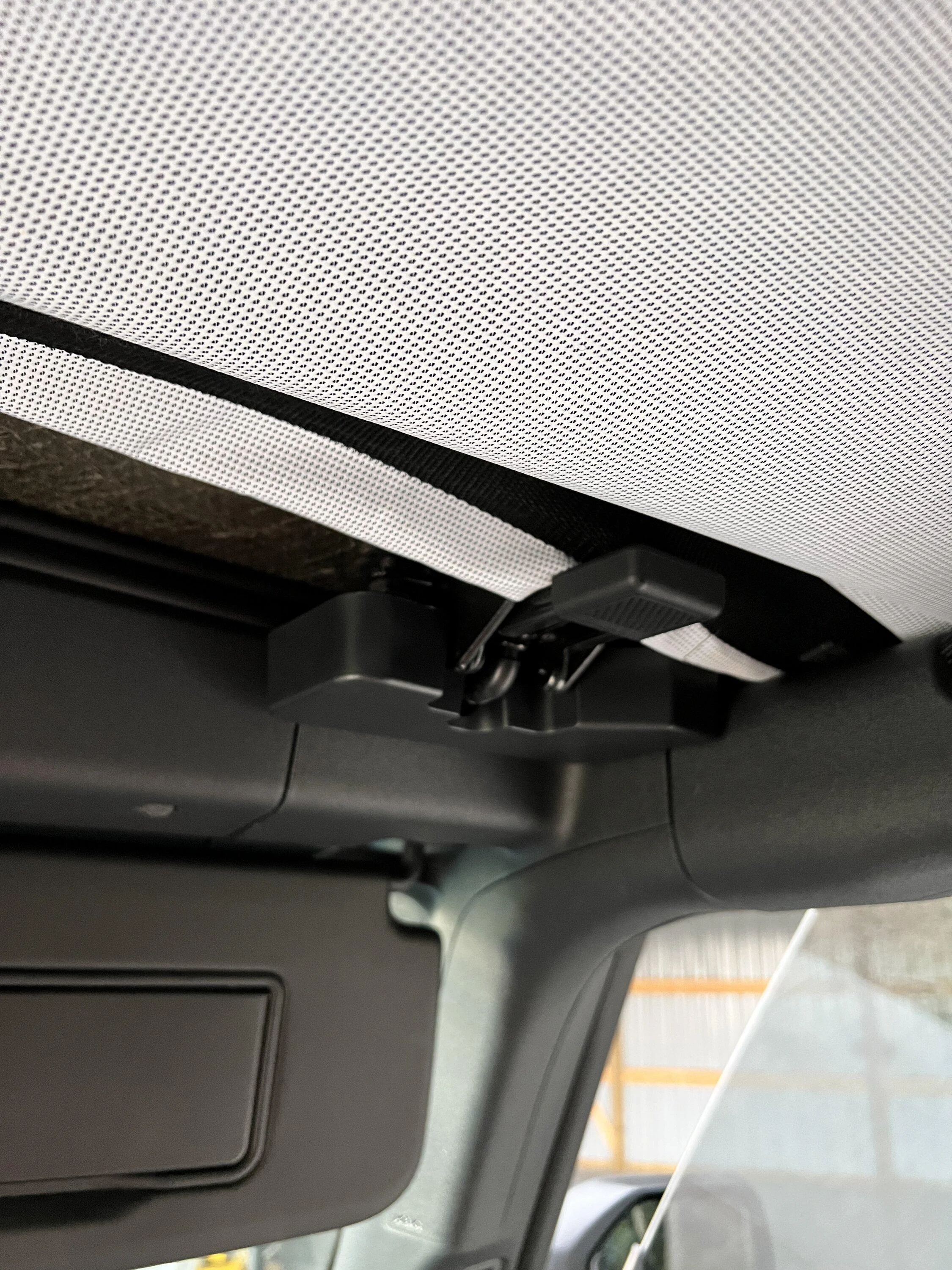

Hmmm, the OPs photos seem to have the hooks coming from underneath, and are missing the hard plastic, allowing it to easily fold back without unhooking. I don't see how this is the same design at all. On mine, the hooks go over the top of the hard plastics and I am having to unhook and remove a couple inches of Velcro to get it to fold back. Just want to make sure I am doing this right.

The design with the hooks on the bottom was changed about 2 years ago. Putting the hooks on top of the strip created better aerodynamics.
Looking at the pics the top needs to be shifted forward more. The nylon edge needs to be tucked into the windshield channel a bit more.
To release the hooks push them forward rather than trying to lift them. When pushed forward they will pop open.
Hope this helps.

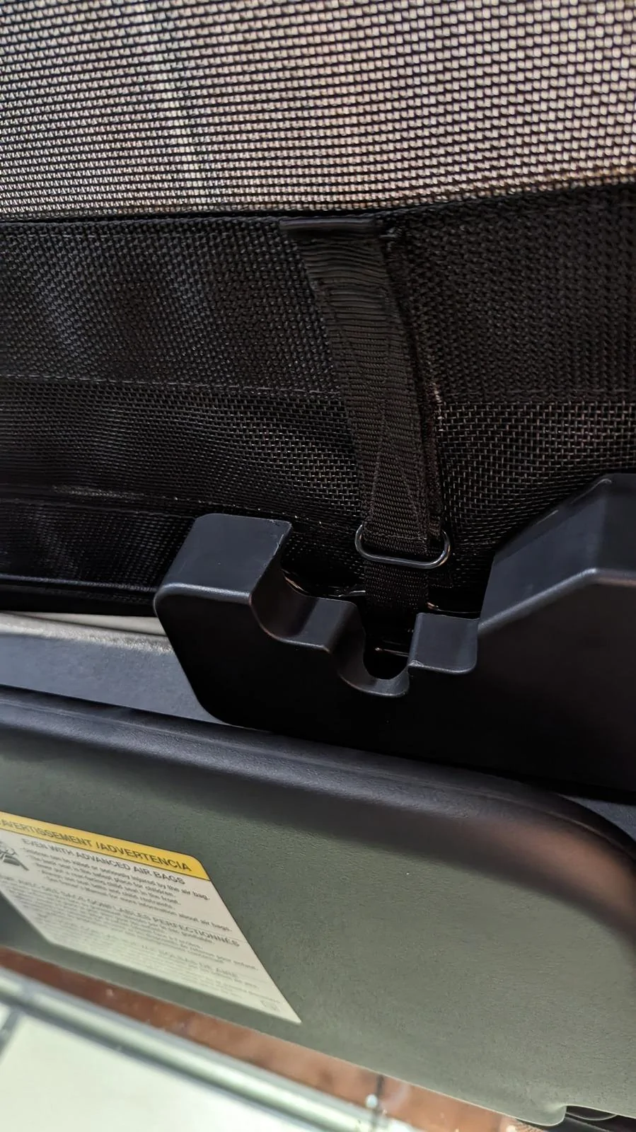

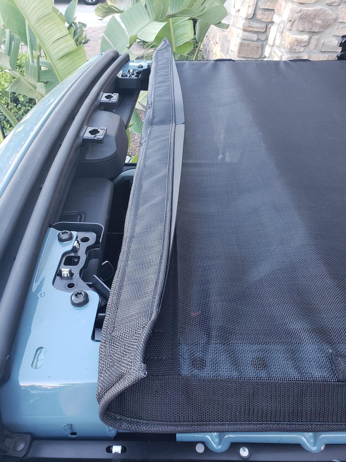

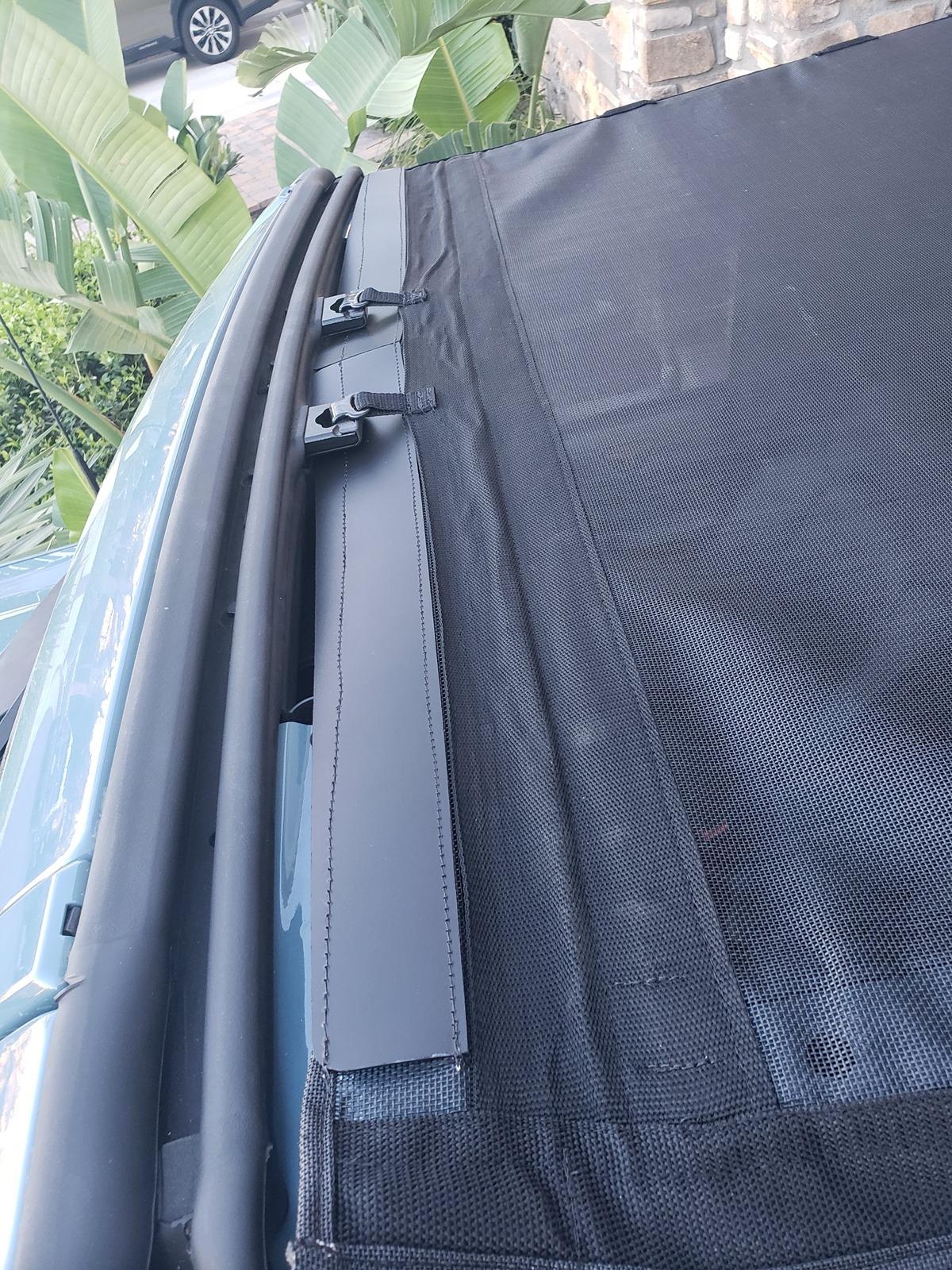

I added two Velcro straps to the front edge of the Bimini top. They tie down the plastic flap to the striker plates. Before I made this modification, it would flap and make noise at high speeds. The straps solved that issue.

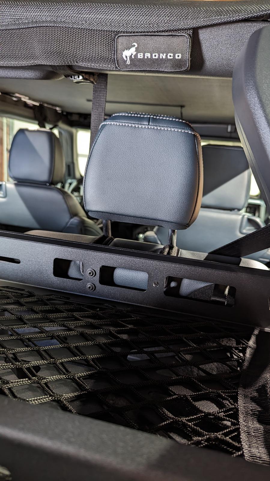

I also sewed a Ford patch on top of the Jtops logo and added a Bronco patch on the back to make the sunshade look like an OEM accessory.

It's one of the best accessories I've purchased for my Bronco. I LOVE this Bimini top!
