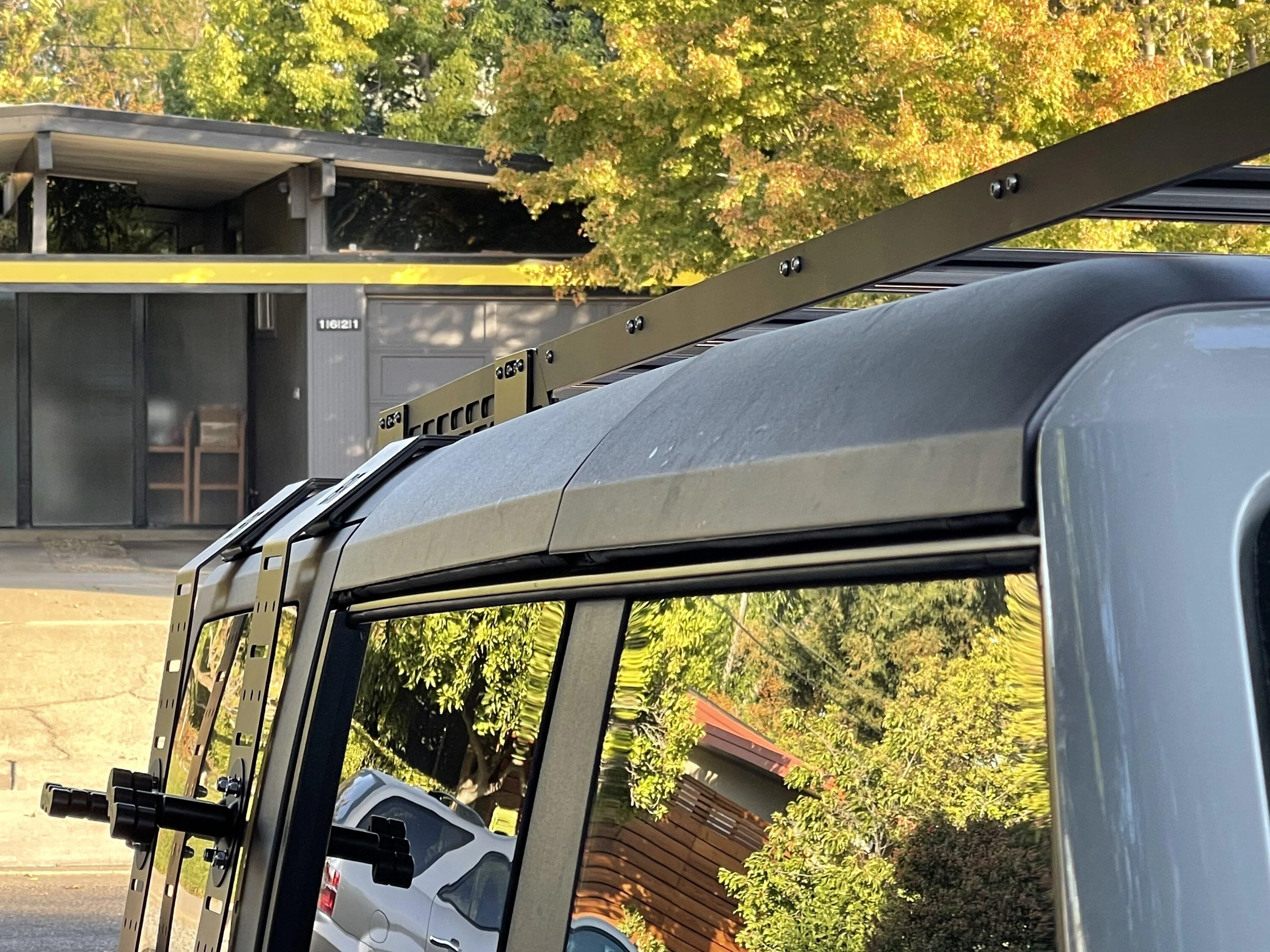

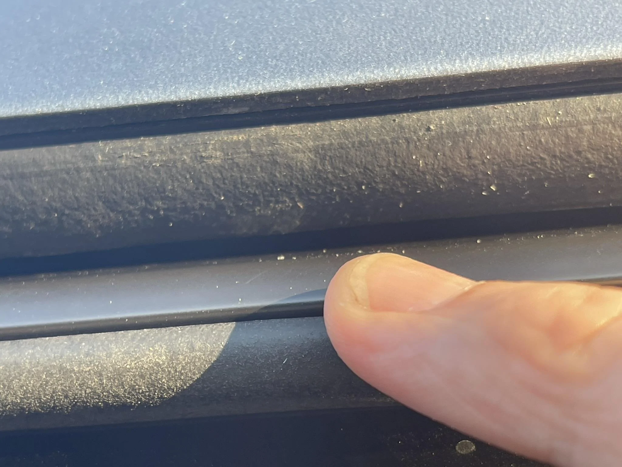

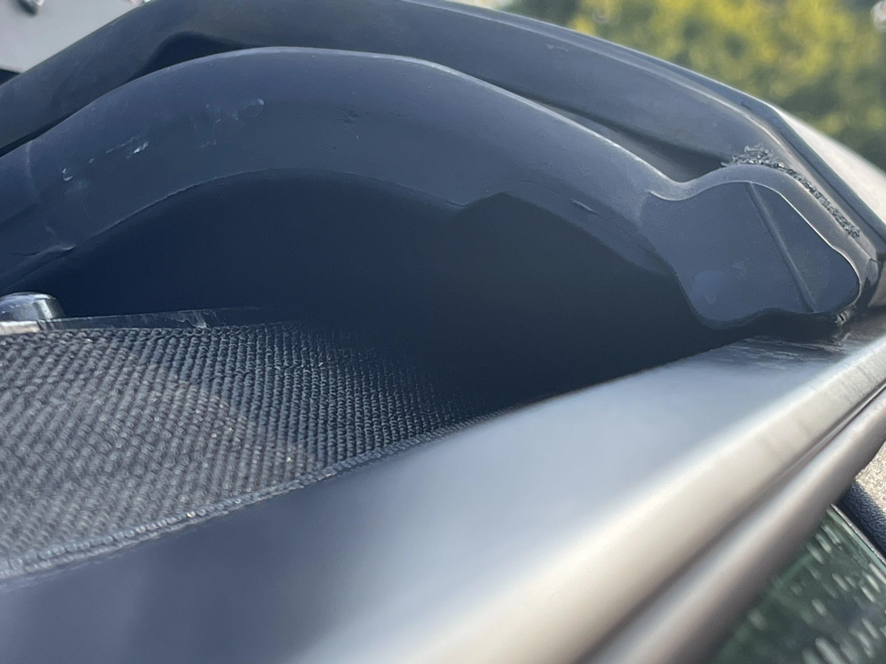

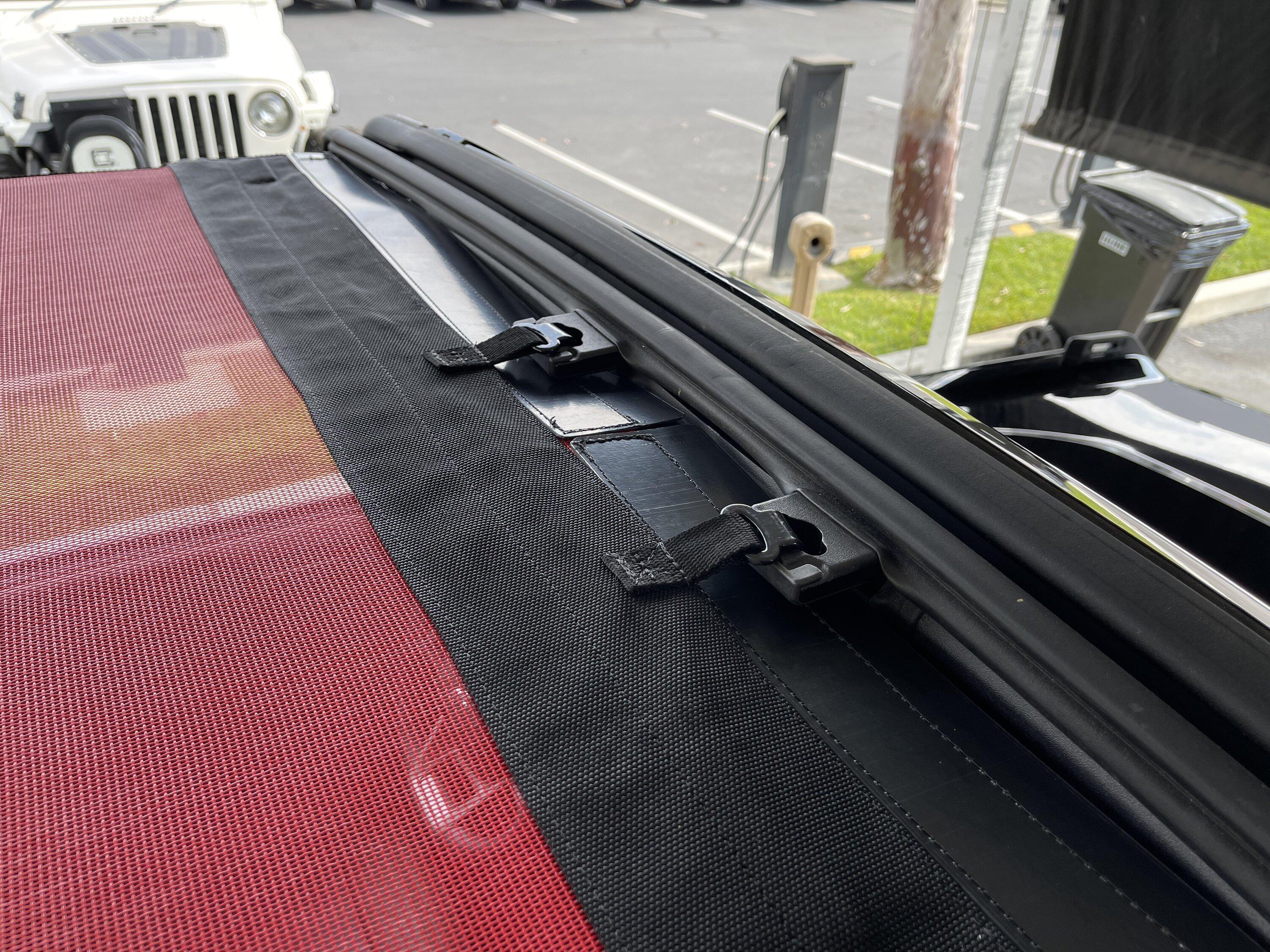

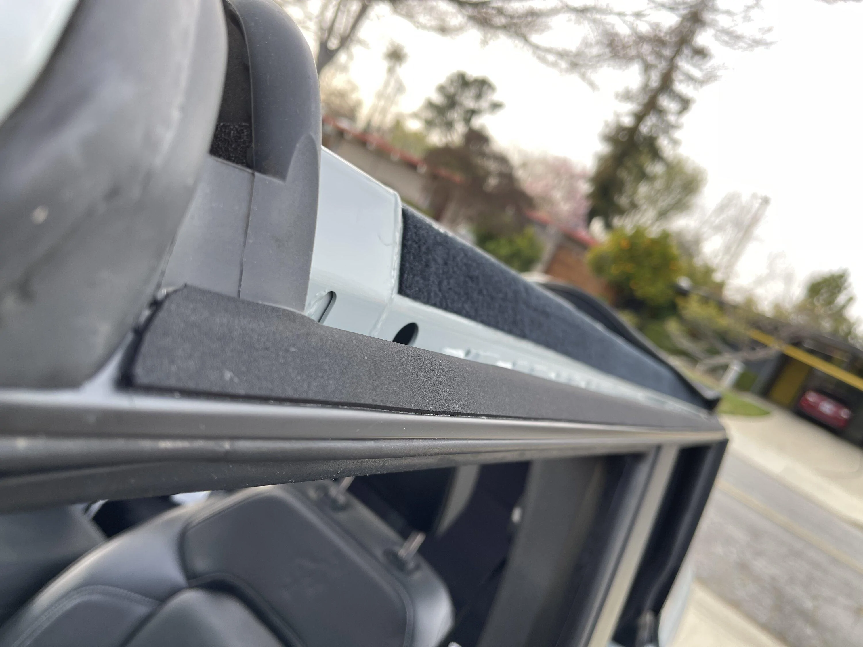

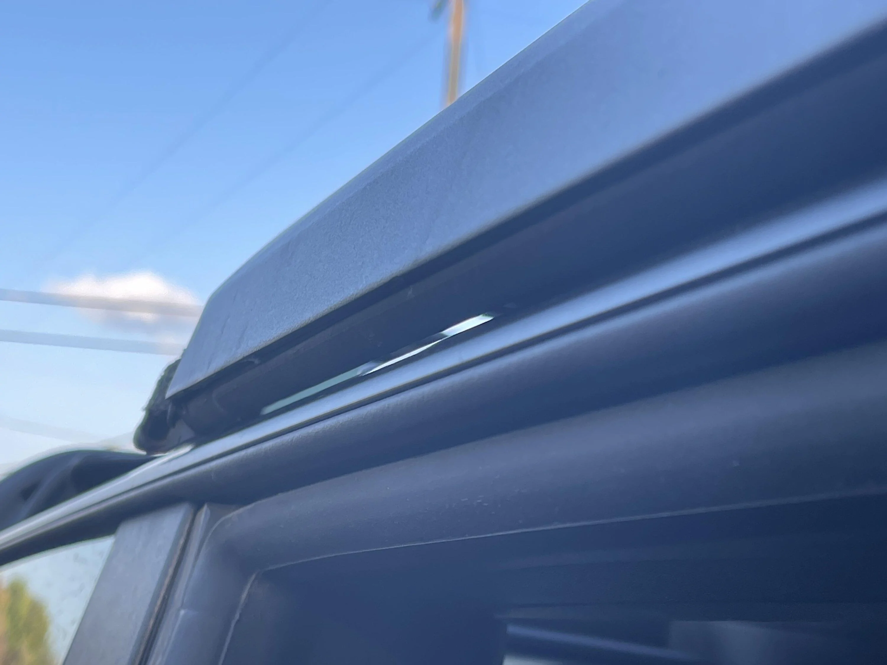

The Velcro on my JTop has peeled twice. The replacement kit I received was just a couple feet of Velcro (not a full length - so I had to section it in - disappointing), and some promoter. I also followed the directions.
The JTop also caused a visible gap between the hard top seals and roll cage sealing surface to open up, resulting in a ton of wind noise as well as causing my roof panels to sit unevenly at the B pillar. This is because the material thickness of the plastic parts sewn onto the top where it sits under the hard top brackets raises the hard top mounting brackets by several MM. I was told by JTop that very few people have this issue with sealing, but it’s clearly a design flaw (simple math - if you raise the roof mount brackets by X dimension you raise the roof and seals by X and lose X amount of seal compression). I was pointed to the service bulletin for adjusting the mounts at the frontmost edge of the roof panels but my issue was related to the fit at the rear of the panels where the mounting bracket is. I took the sewn-on plastic parts off the mesh top (I cut the stitches out using an exacto and in the process I discovered that it’s surprisingly brittle plastic material- it super easy to snap into pieces as shown in the video - these should have been manufactured out of a more ductile plastic like polyethylene or polypropylene sheet, but they seem to be more like an acrylic) leaving just the mesh material under the support brackets and this helped. I also added some 1/8” thick neoprene tape along the length of the mating surface on the roll cage and this helped close the minimal gap that was left. I’ve spent a ton of time fussing with my Jtop to get it to work right.
Based on my experience, I feel this product should have spent a few more months in development.
I also had the velcro peel on mine, and I also followed the instructions per the video. The spot it peeled for me is at the very rear where it follows the curve of the sport bar (this is on 2 door), I wasn't able to get good adhesion due to the bend. If I were to do it again (which I will at some point) I would cut the strip instead of trying to bend it to follow that curve. Overall great product that I'm really happy with, but just an FYI

Thanks for the feedback. Let’s review.
The replacement kit includes 12 feet of hook and loop and 2 packs of adhesion promotor, 2 alcohol wipes and a bottle of Goof Off for surface cleaning. That is what’s needed for a good install.
Peeling at the loop side on the edges can happen and should be trimmed. We use a full length of hook and loop that provides a full length seamless attachment unlike the bungee attached tops that has mounting points that stretch and leave gaps.
As far as the creating a gap it has happened a few times out of the hundreds of the hardtop versions we have shipped. A simple adjustment to the side mounts should address this.
As far as it being a design flaw Ford has put out a bulletin about adjusting them. It is happening to Broncos straight from the factory without our top being installed.
The nylon plate material used was best suited to be sewn into the top.
We experimented with several options and felt it was best. We have not had a single issue of it cracking unless it’s put through a process it’s not intended to perform.
I'm sorry you had issues. We will take your feedback seriously as we continue to evaluate the design and selected materials as they perform over time. We have now shipped over 1,500 shades so we are getting a lot of great feedback.
If I can be of further assistance please let me know.

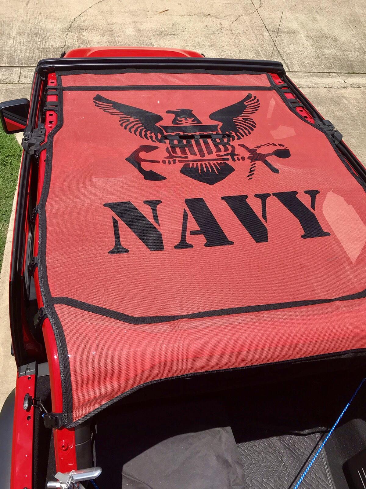

How about military emblems on them?
USN Ret

We can print any military emblems as long as the customer is current or retired military. You have the right to use as long as you served.
It is however illegal for us to just print it for anyone.

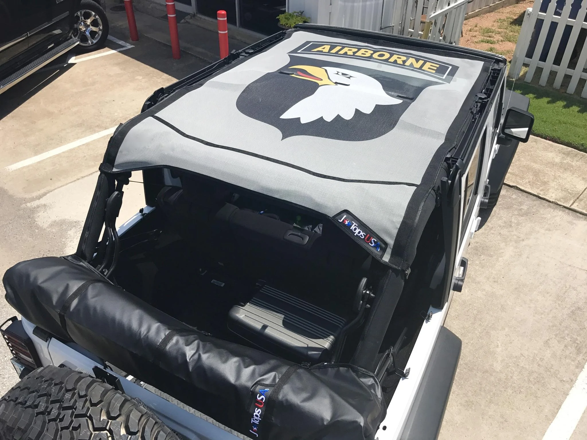

I am looking at the Airborne Bronco, and it looks like there is a bag over the soft top. Do you make those as well.
