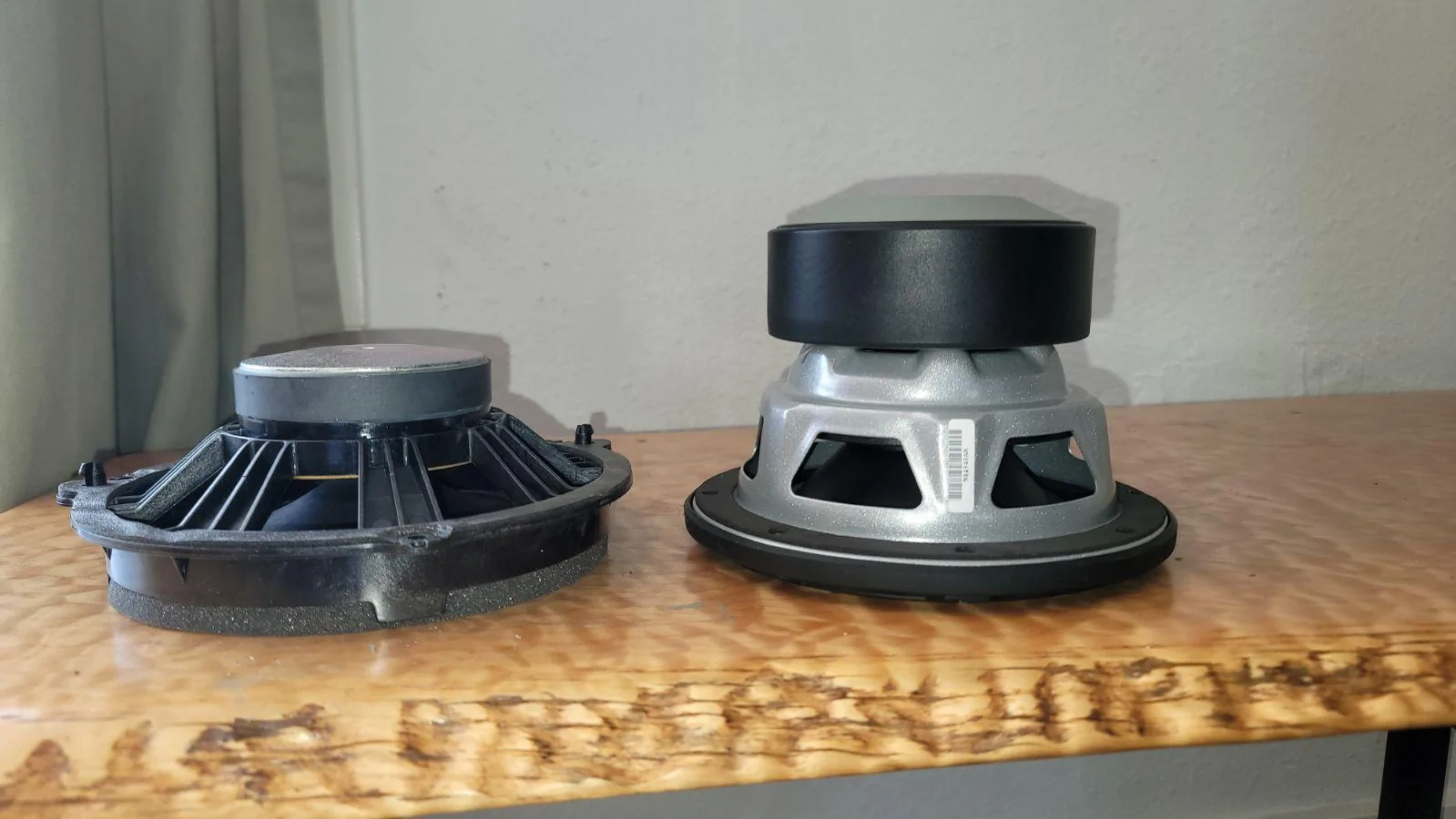

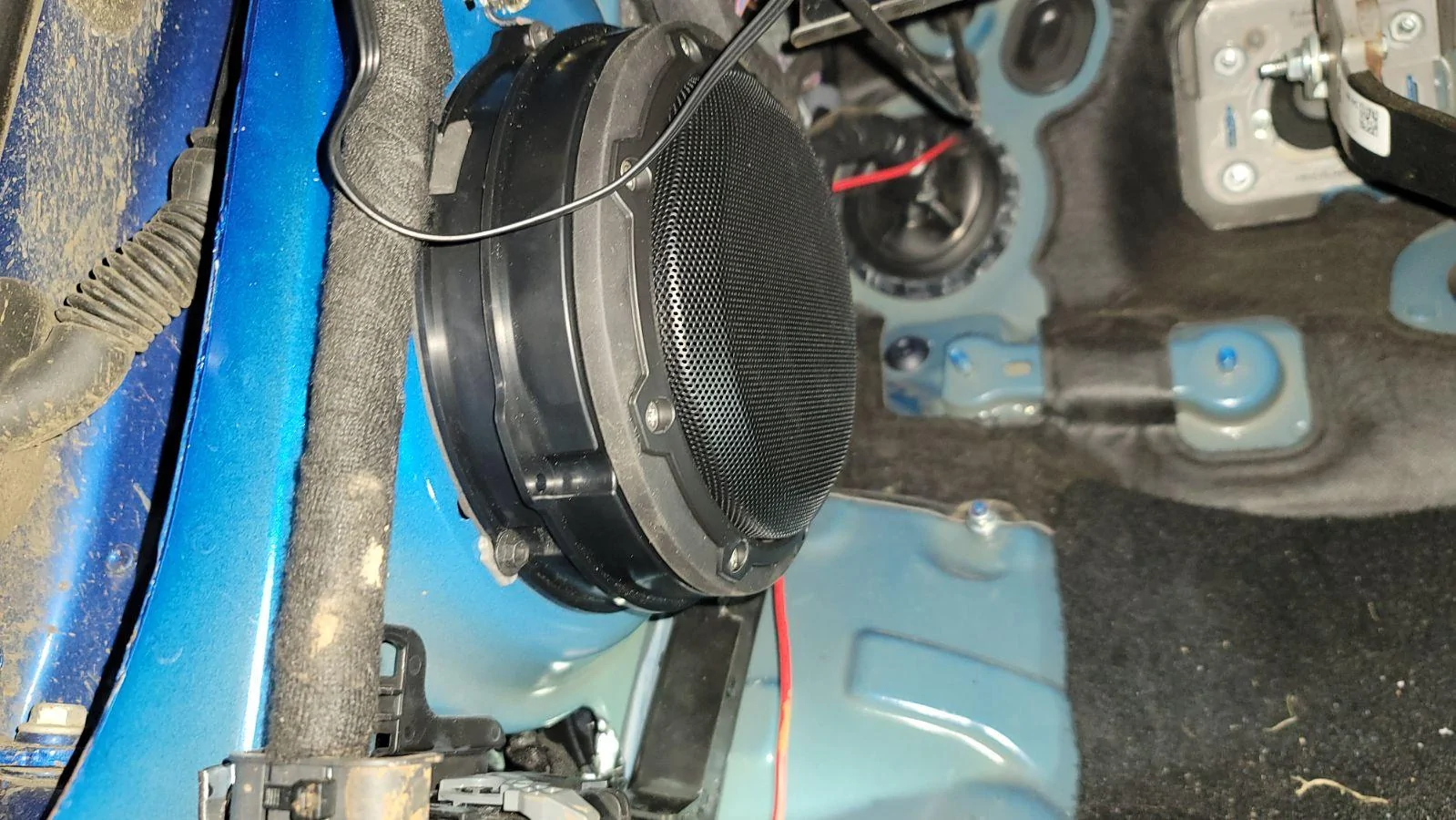

I hollowed out the kick speakers holes much deeper and used the jumbo magnet JL Audio 6W3v3-4, in the kick speaker location with an soundstream amp... I like lots of mid range punch.
