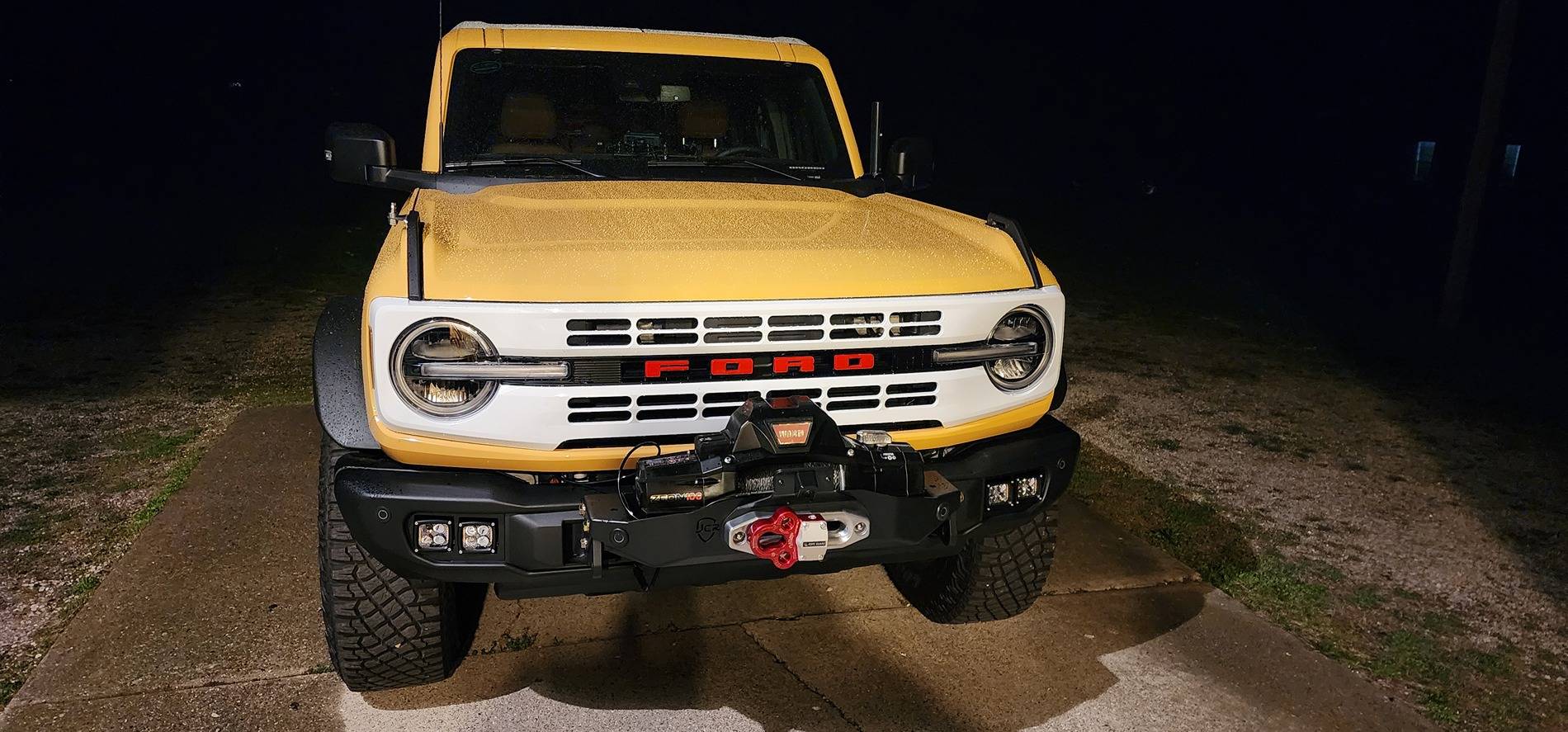

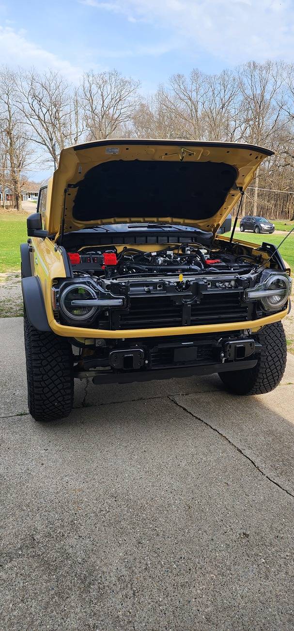

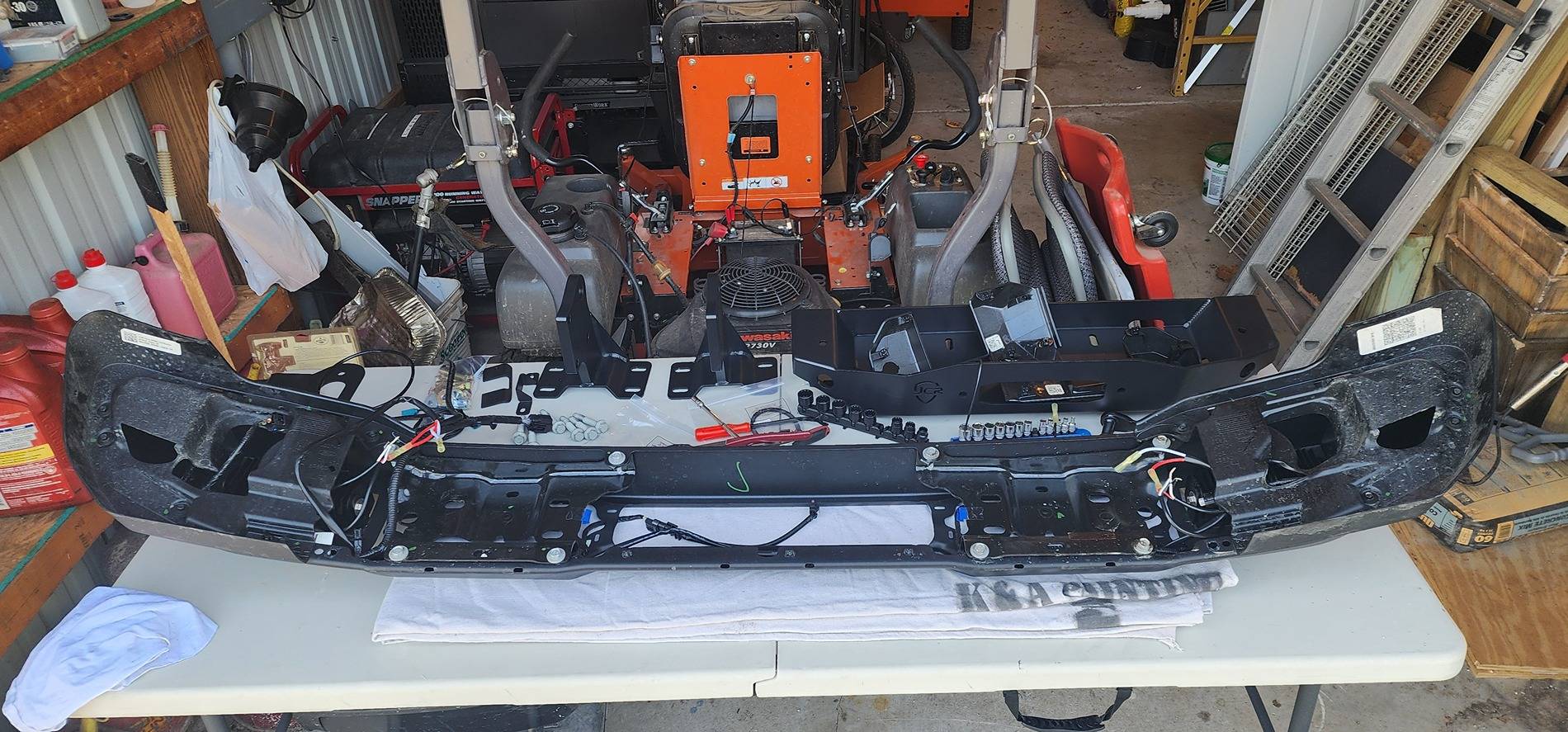

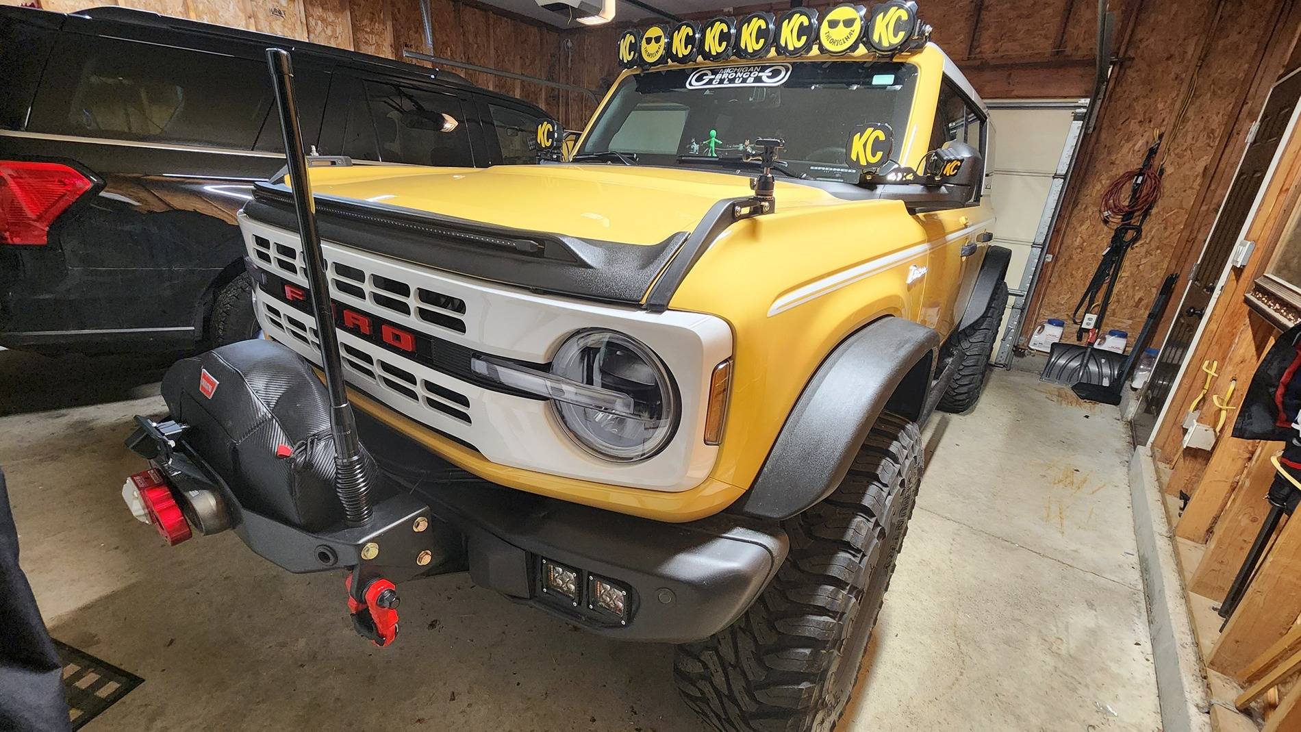

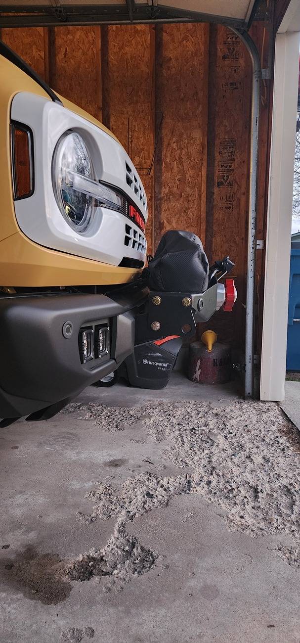

I have the JcrOffroad winch basket on my capable bumper and it works well and is well made. Installation was not hard. I made life easier by ordering the two of the Rough Country Proximity Sensor Extension Item #947000011
