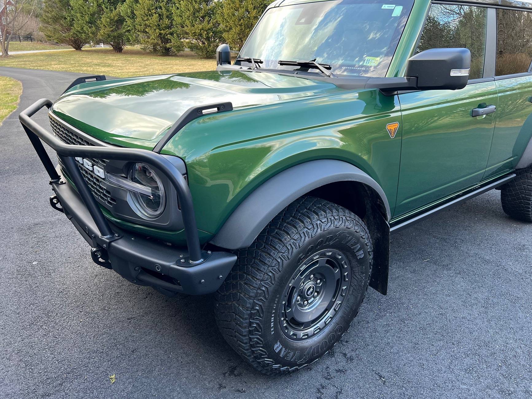

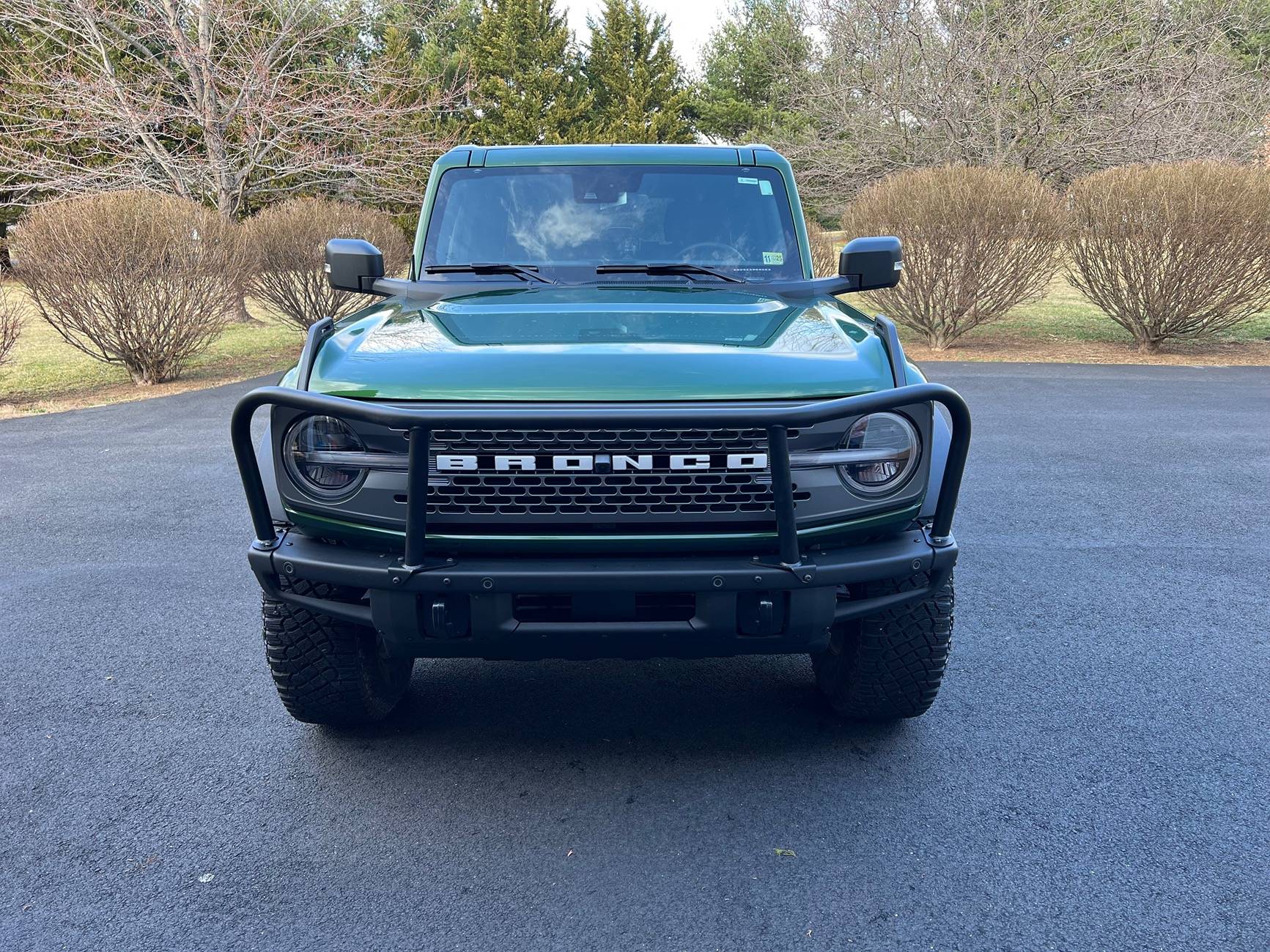

Just 10 bolts and a few hundred dollars are all that separates you from a rather burly bar that doesn’t interfere with the 360 cam.
A few notes:
- Be sure to get a T40 plus bit. Bolts come out easy, but you’ll want to not mess things up when torquing.
- Torque bolts to 25Nm. That’s just over 18ft-lbs in Freedom Loving Moon Landing units.
- It can be a bit tight, so make sure you keep a finger between tools and bodywork.
- You may need to lean on or push your bumper end caps a bit to get everything lined up.
- Hardest part is getting the dang staples out of the box lid.
- Second hardest part is getting off the foam protection.
- Have someone help hold it in place while you bolt it on.

Oh no, I guess you won’t be leaving a duck or whatever on my vehicle.
I routinely come across groups of 6-10 deer in the evening and wanted something that offered more protection than the safari bar or most bull bars, didn’t interfere with the camera, and had more points of contact with the bumper.
I think it looks fine, but I am more focused on a functional use than anything else.
