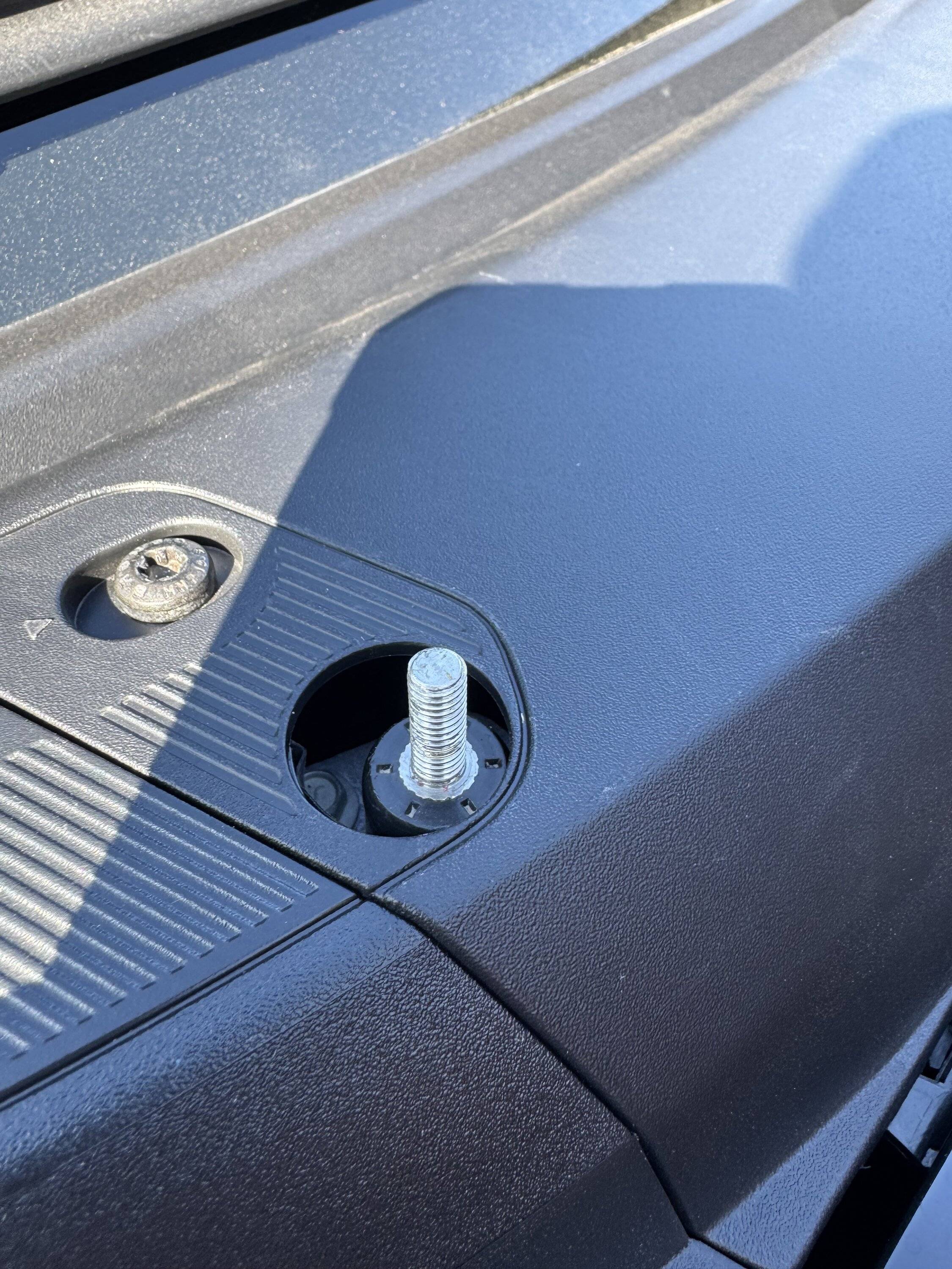

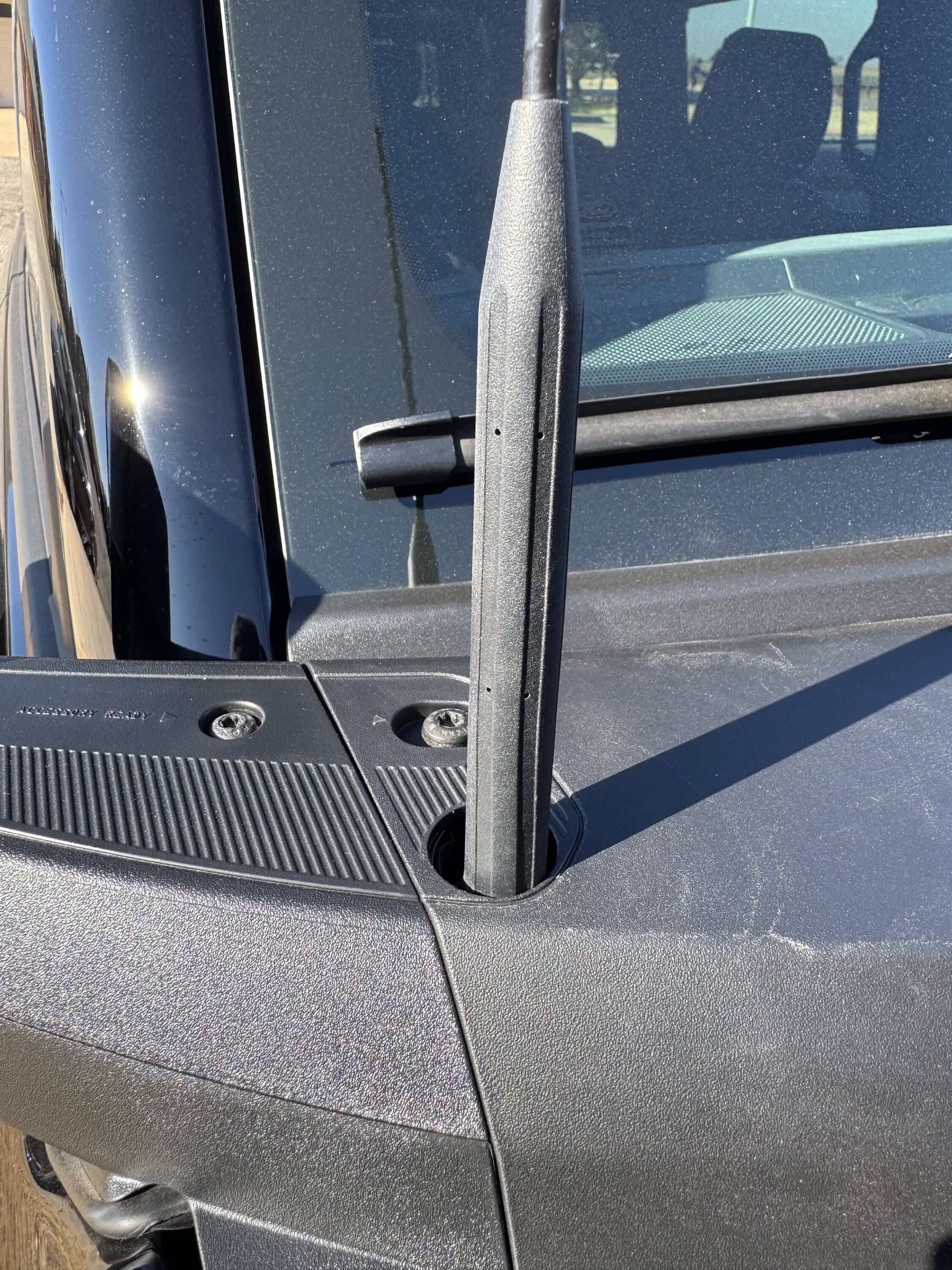

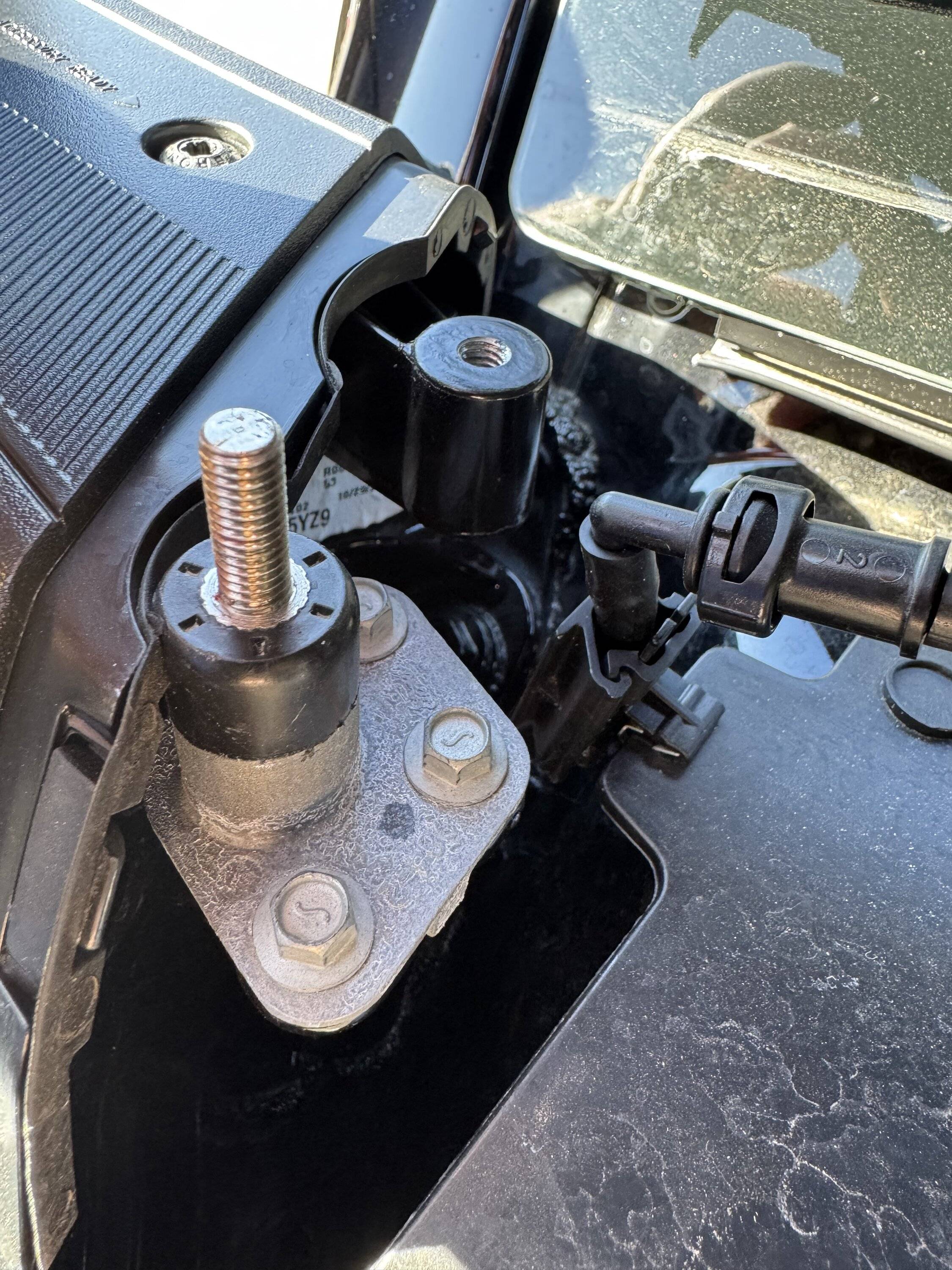

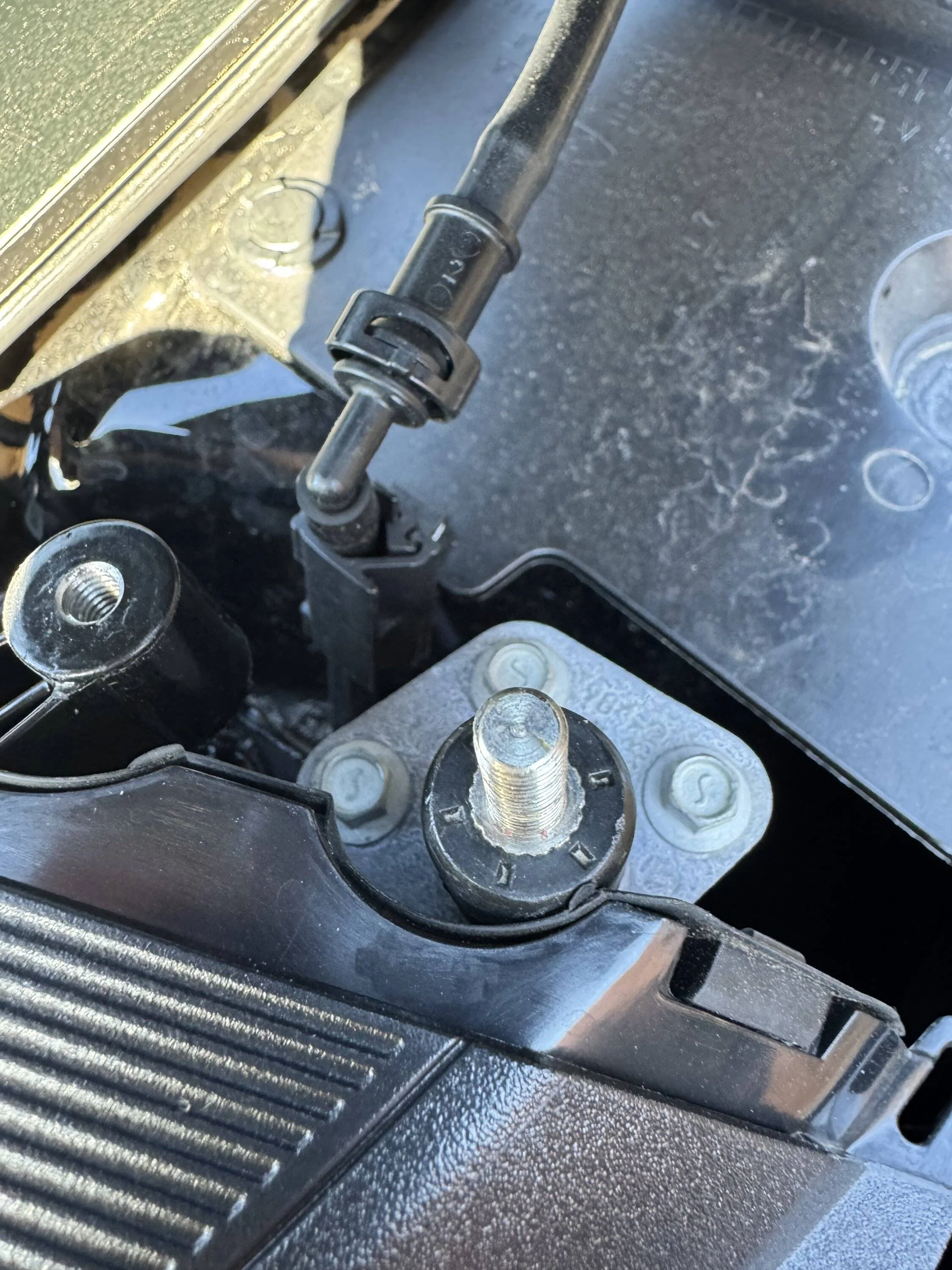

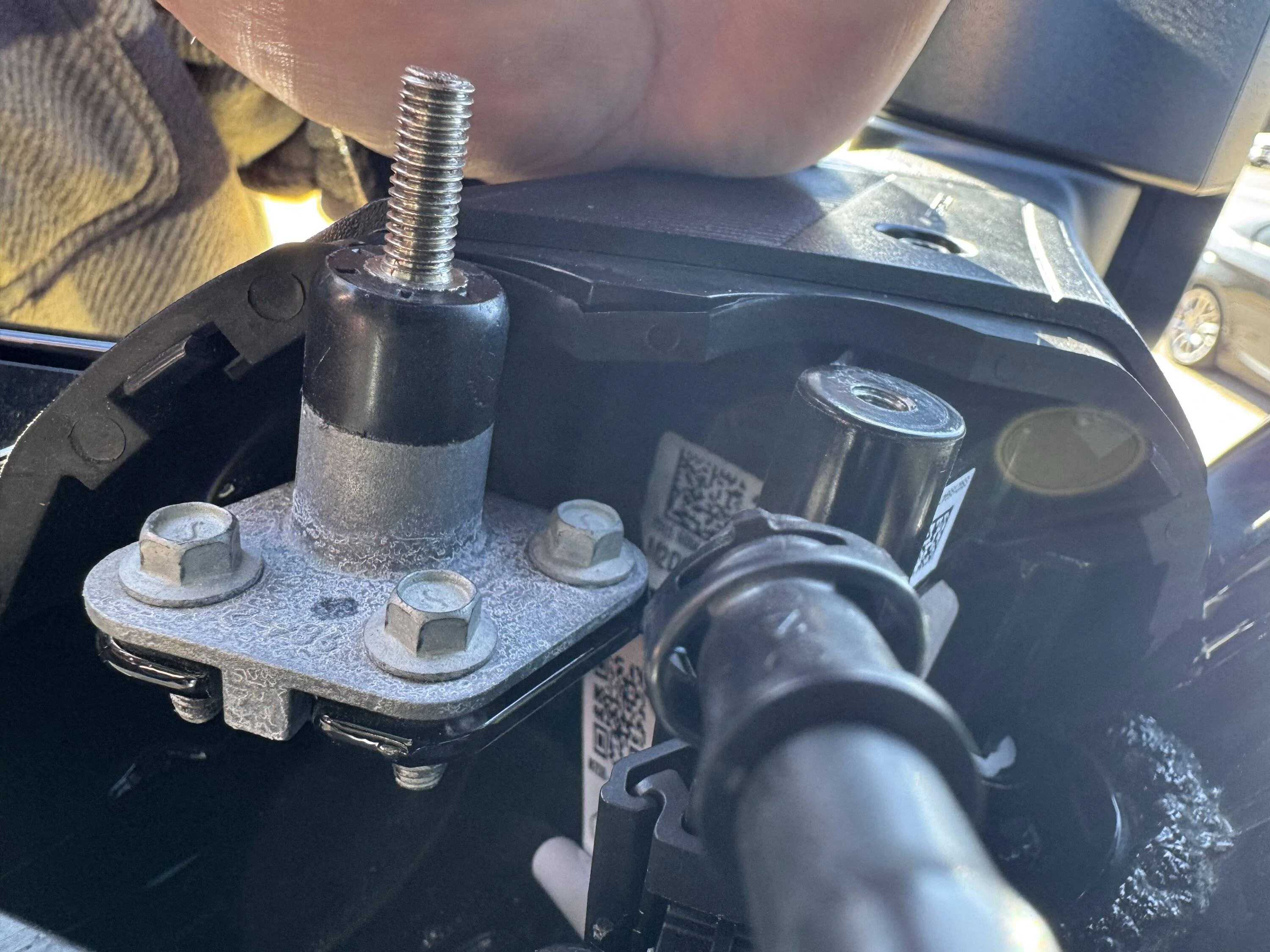

Hey guys, my wife and I got our first bronco and for Christmas of course mods were the hot topic!
So First and easiest mod would be the stubby antenna, right?! Well for whatever reason either I am an idiot or we have some sort of super rare Bronco that doesn’t have the same attachment as all of the other 2024 Broncos.
Can someone tell me if I’m crazy?
I got the Ronin 5 inch smart lock antenna but it has the threads built in to the antenna. All the YouTube videos that I’ve seen mine looks different.
help!

I may have just found out my own answer to my question, apparently on some of the newer 2024 Bronco models Ford has now changed the mounting system for the antenna.
I reached out to Ronin and they were quick to let me know.
You ever find a solution?
Mars
Mars
Dec 28, 2024
texas
2024 Bronco
Yep, ford changed the antenna mount in the middle of 2024. I had bought a Ronin stubby and I contacted them, they sent me an adapter at no charge.

This is the only place I found where someone raised this issue. Just got a new 2024 and almost stripped the mount threads trying to wrench it out.
My stubby has a female connector but is too shallow so about 0.5” of exposed bolt is left. Not being able to swap out the factory mounting bolt has made this way more inconvenient….

I am having the same issue with my 2025. If you do find a solution please let me know. I got a tekk antenna but it has the same as you described.

I’ve heard they changed the antenna mount either second half MY24 or MY25 - so you would either need a specific antenna for that or an adapter

I am still looking. I have a 25 big bend and the antenna screws off but the bolt does not so all of the after market antennas i have tried do not fit. I am hopeful that something will be released soon.
