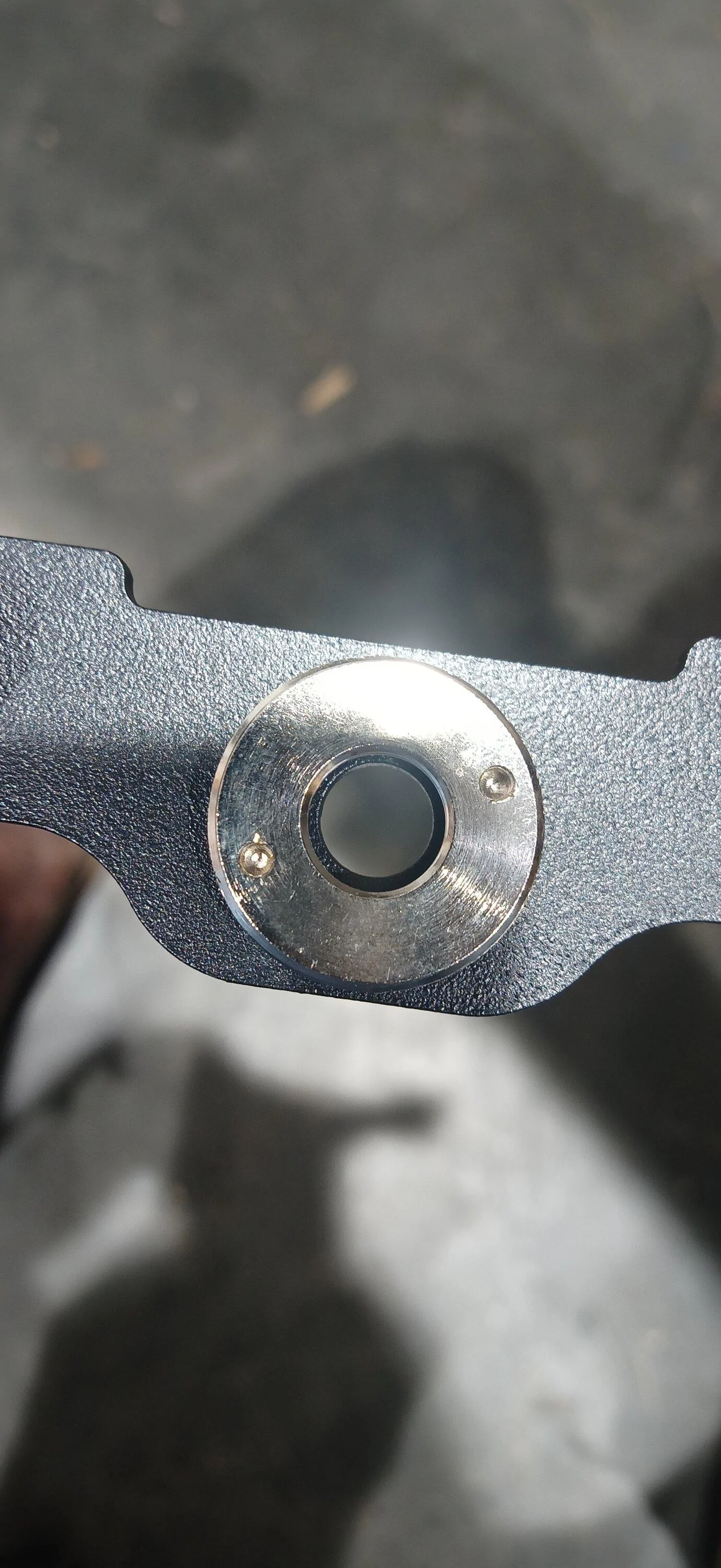

Although advertised it's compatible with an MMO mount, its not. The antenna being installed was a Larsen NMO50B low band (6 meter) unit
The first problem is the mounting hole is too small for the threaded mount. Yes it can be drilled out, but shouldn't have to be. See photo.

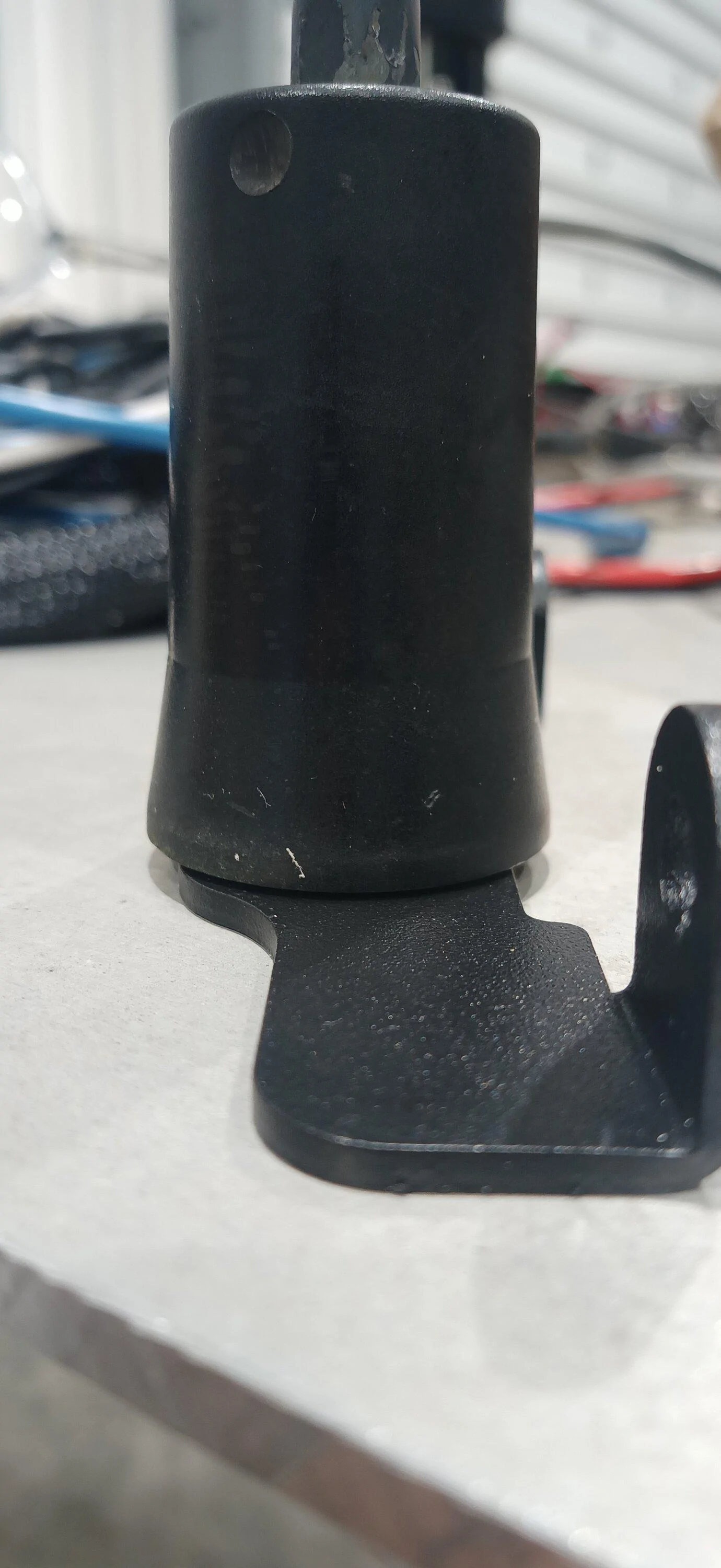

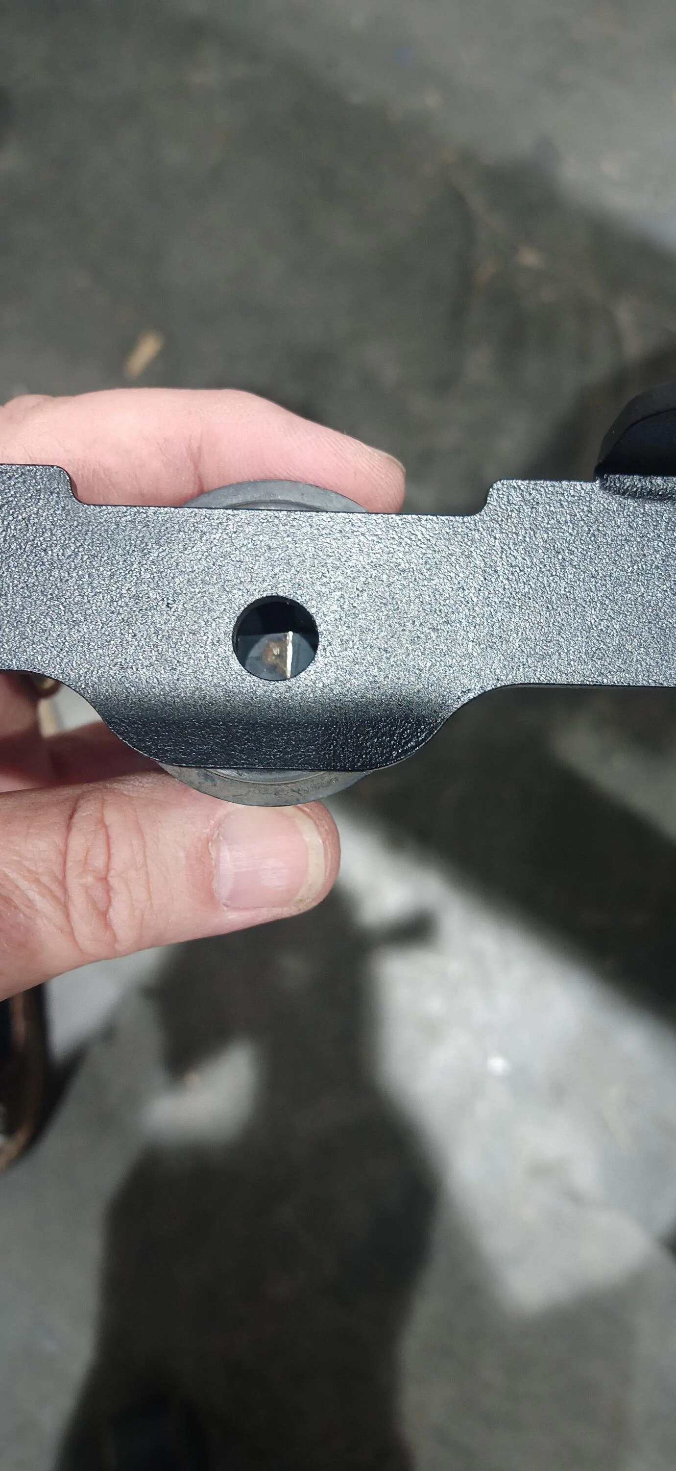

The second problem is the bracket is too narrow to fully support an antenna. See photo.

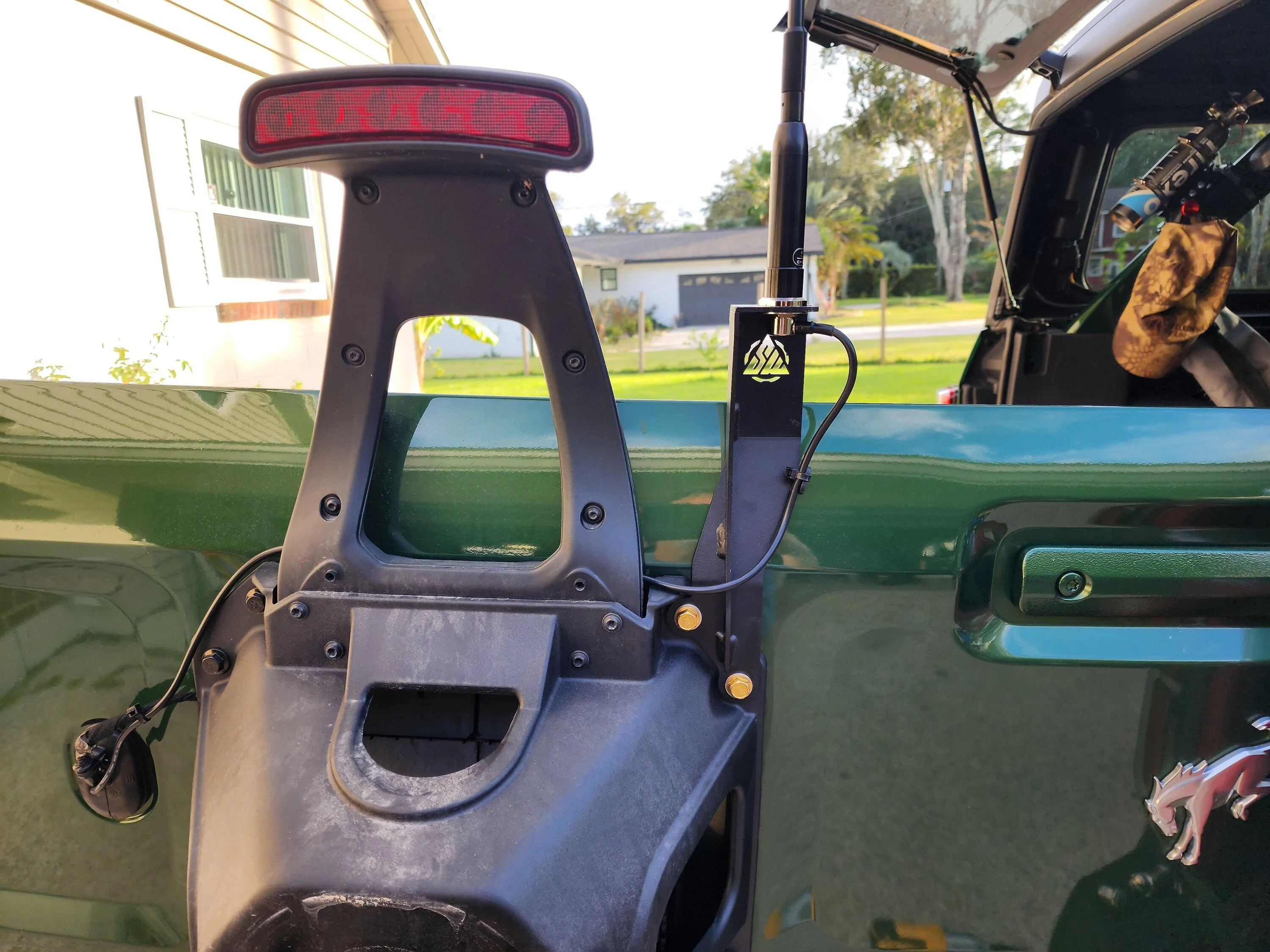

I'll second on the Swarfworks. Used one on mine. Though did have to open the hole a tad.

Our customer rejected the Trailrax product. We tried modifying the mount, but it just looks hacked.
