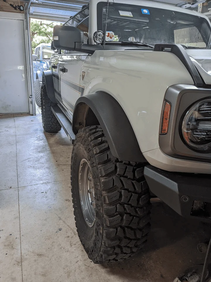

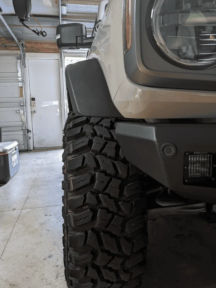

Non-Squatch BL with 00 offset Warn Jackhammers, 37x12.5's Coopers, Dirt Logic coilovers AND Squatch flares. Shows a bit of shoulder which is the perfect amount of poke for my tastes.
Awesome build! What wheels are those? And what brand are the front bumpers from?
