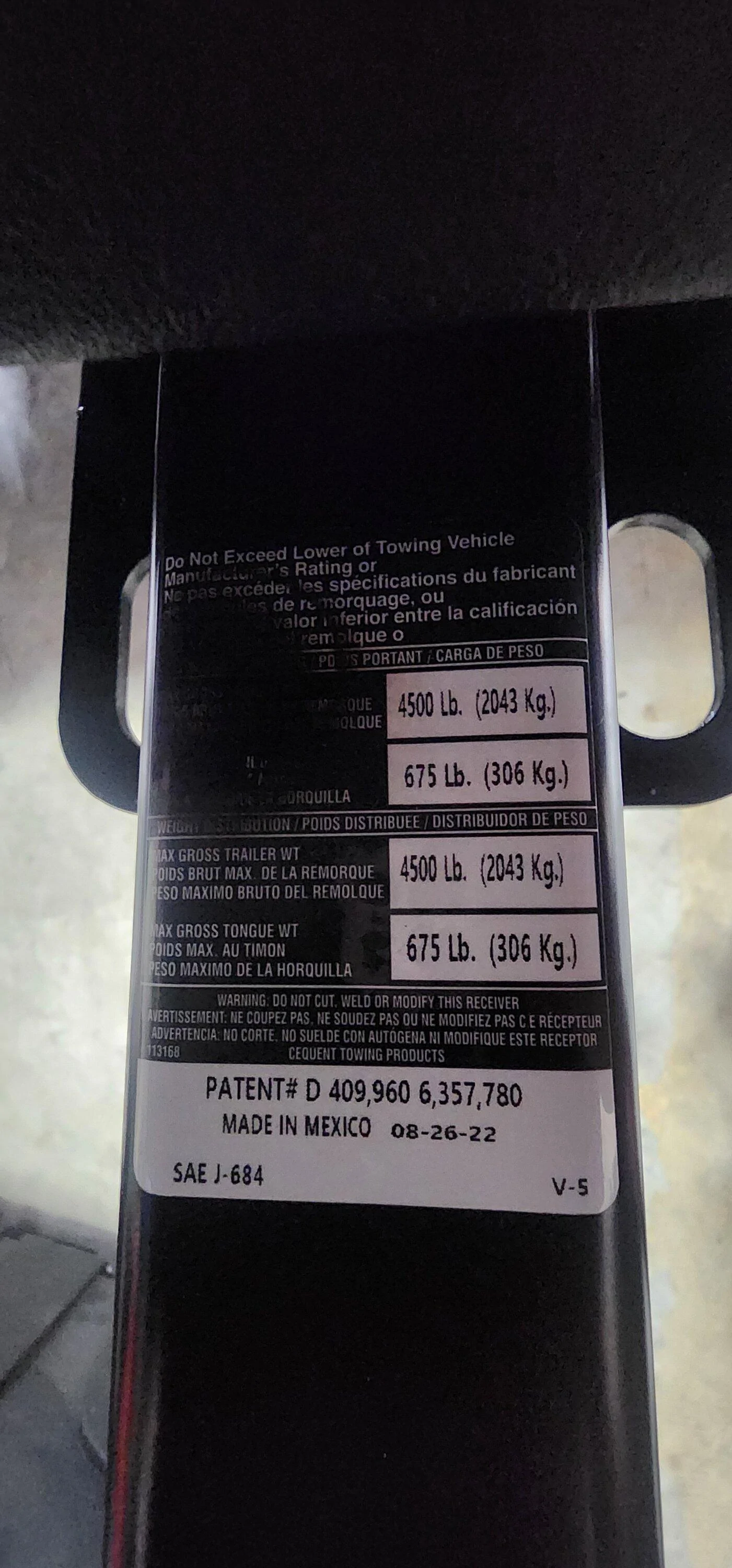

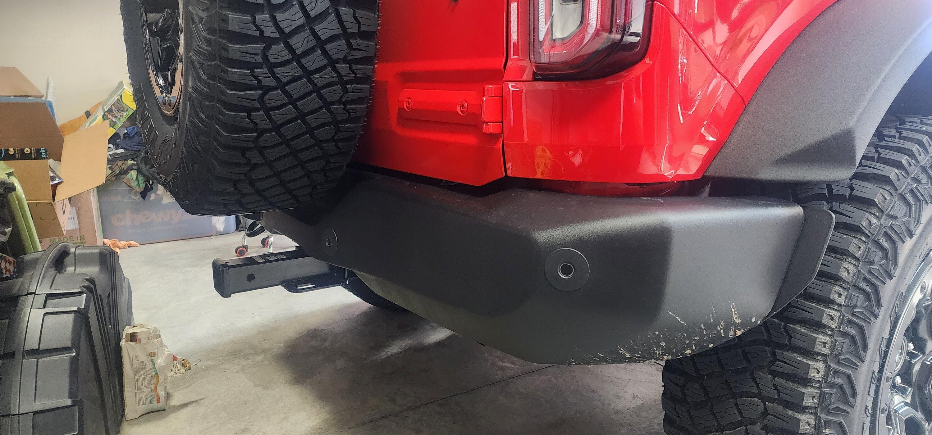

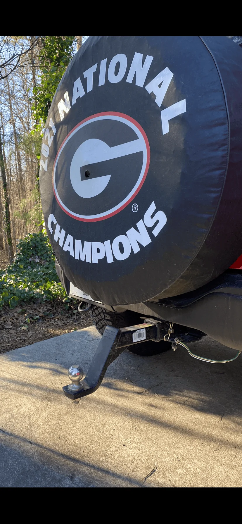

I purchased and mounted the curt but just ordered the draw-tite. I am not a fan of it sticking out further but I needed a little extra length for the pakmule and using an extension looses half of the capacity. Swapping will not take that long so I plan to keep both and mount the curt if I plan on any offroad activity.

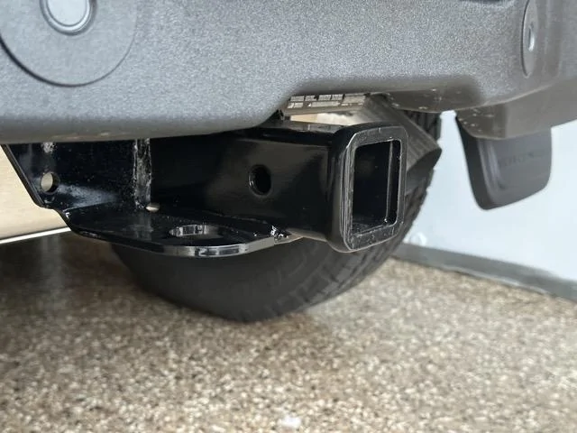

It is so easy to install that you are gonna swap them out? Can I borrow your torque wrench?
The factory hitches require removing the rear bumper because the bolts go in from the rear and I think that the nuts are welded on. The aftermarket hitches are much easier to deal with. I purchased a olsa split beam torque wrench while I was waiting on my bronco. I like that it does not need to be set back to zero after use.
