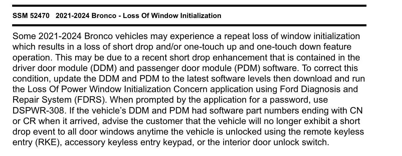

Is there a TSB for the windows?

I'll be asking the service department about that SSM at next oil change

Not 100% sure what you mean by they respond crazy, but checking to see if you have a DDM/PDM update may help. Also a possibility the windows just need to be adjusted.
