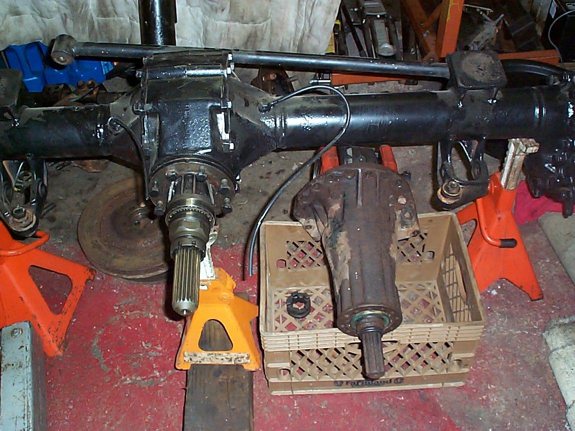

:D406's only have a 3.15 diff ratio (technically), but overall with portal boxes are 6.52. Those diffs are a "hair" beefier than even the new upgraded 44's.
This is one of the 406 axles I have, next to a 404 diff. I believe the 406's are rated 4 ton.
Ford Bronco Is it really the trans ford is protecting? DCP02240
And the 404's have held up to 42/43's for 17 years now, on a 6000 lb rig with only one diff exploding.
