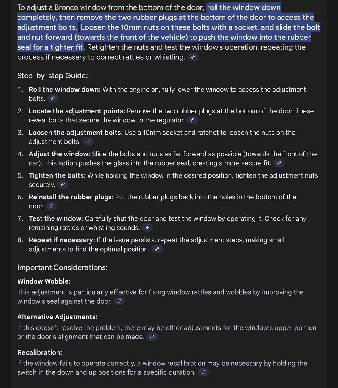

On the bottom side of the door there are two bolts that adjust the tension of the windows and also the distance between the outside of door and inside of the door. I had the same issue and I slightly made adjustments and problem has never happened again.
Hope this helps

Thanks. I’ll take a look, are they on the bottom bottom or bottom of the side?

I’ve had an intermittent bounce-back issue with the driver’s side window since day one. The relearn procedure would make it work normally for a while, but it was never a definitive solution. I suspected from the start that the glass had been poorly aligned at the factory. It was installed about 3/16" off from the correct position, sitting closer to the door’s forward edge than it should have been.
The issue worsened after the dealer carried out SSM 53981 and replaced the window seals. Not wanting to bring my Bronco back to the dealer, I followed the glass alignment procedure shown in the video below. Since then, I haven’t had the bounce-back issue once — it works perfectly now.
