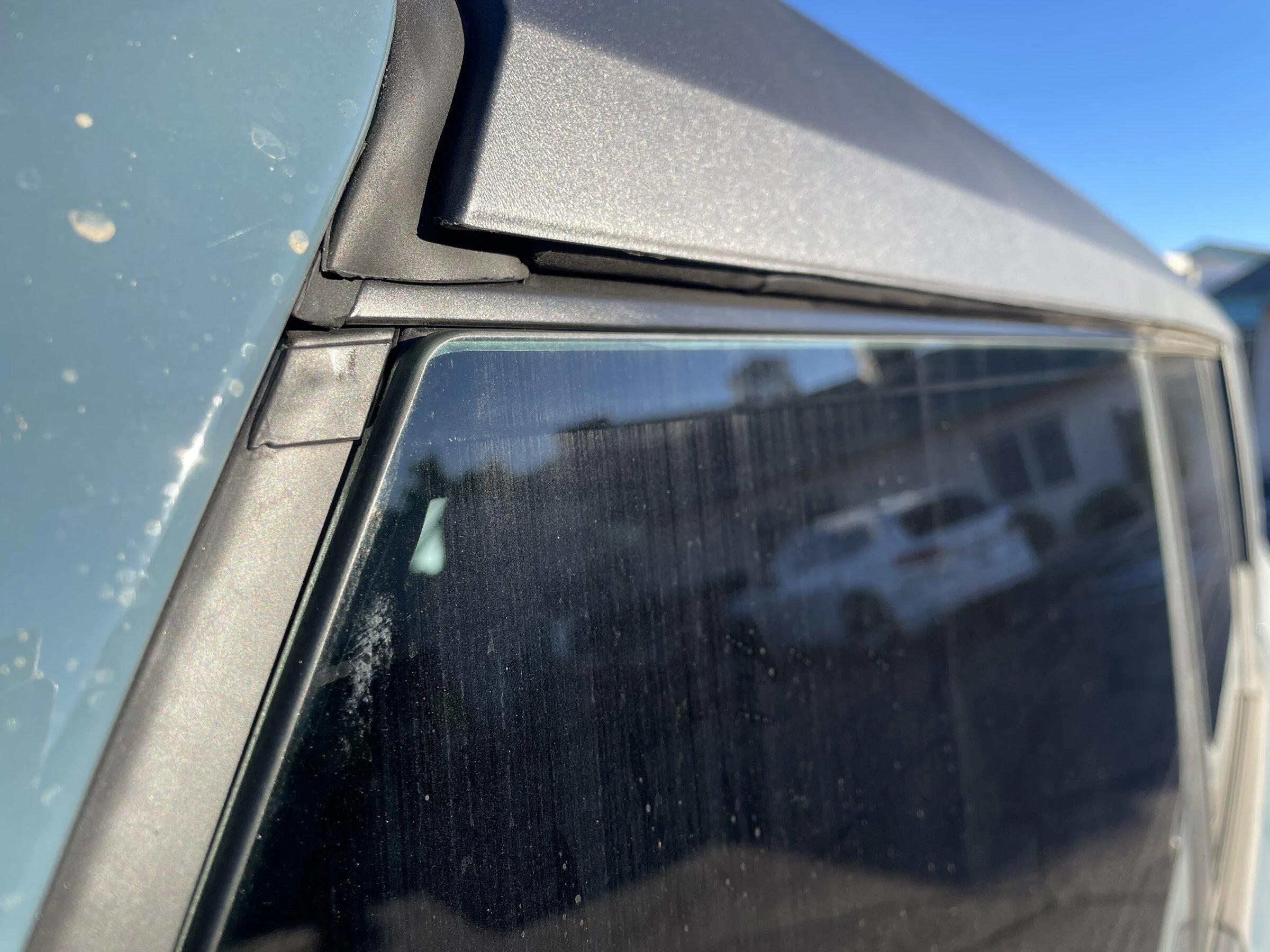

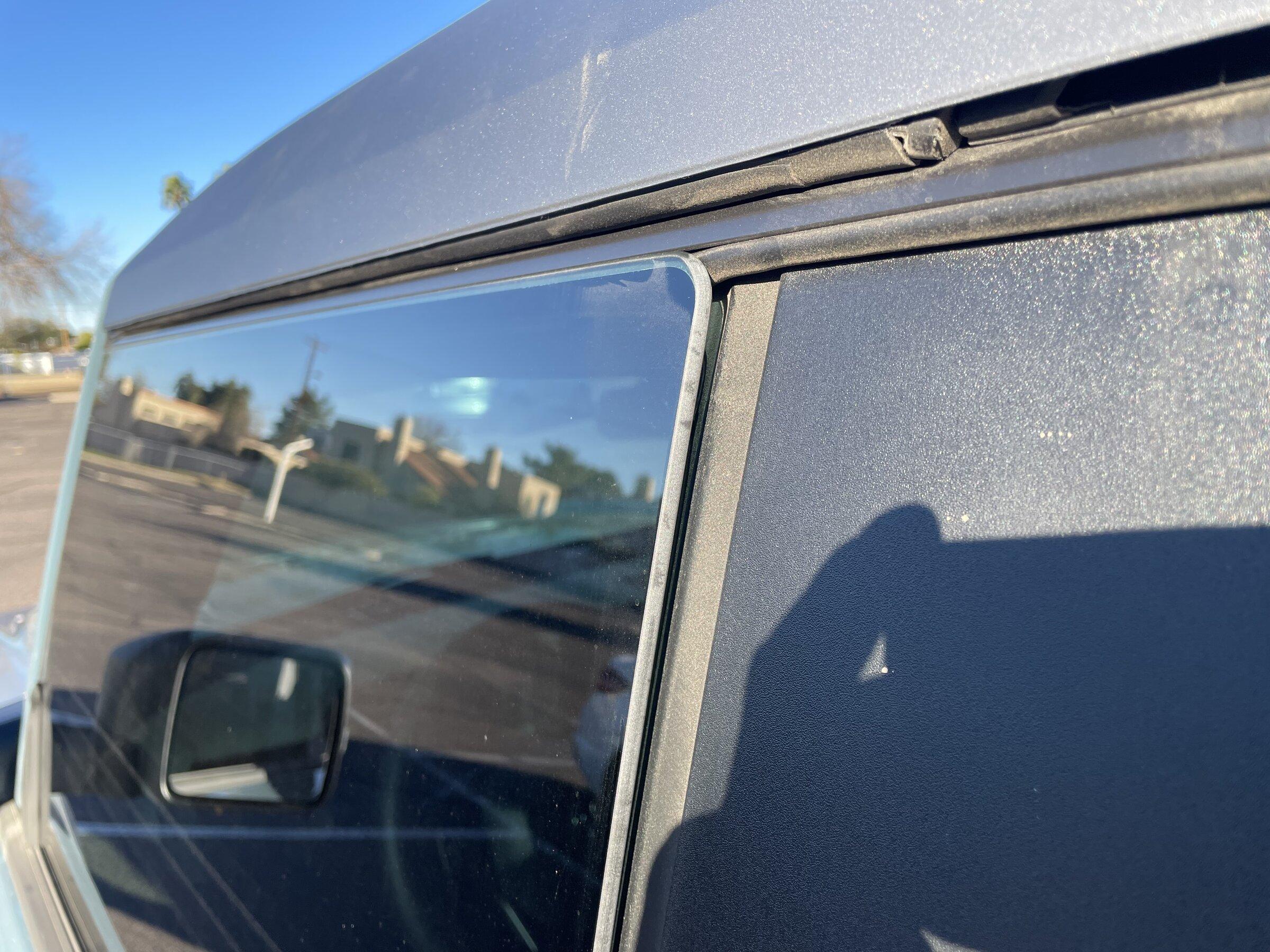

For a week or two my drivers window stopped doing auto-up. I figured I’d take it in when I had time. Then I started noticing when i pull left and right front window buttons up sometimes the passenger window would go up but then come back down or stop at like 75% up. Would roll up fine after. Little buggy but nothing persistent or that I would say: if I do X it does Y. Hard to debug.

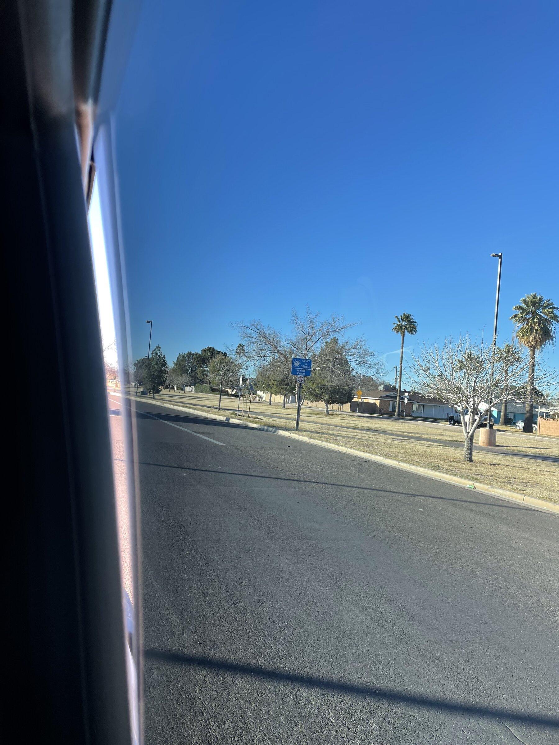

THEN… the other day I kept hearing wind noise from behind my left ear… rolled down the window a bit and back up. Noise gone. Didn’t happen again for another few days and got the wind noise again. I look back and the drivers window has like a 1/4” gap at the back on top. So I took a photo while driving and didn’t touch the window buttons.
I got out and shut door. The window was 100% up but outside of the rubber seal. I opened the door again and it stayed. So it wasn’t doing the down/up thing when you opened the door. Just stayed up. At some point of me messing with the buttons it seems to have reset and is working properly for a week now.
Soooooooo…. it intermittently stops doing down/up on door open and then won’t seal. Like how do I explain this to the dealer? At least I got these photos when it was acting up.
4 door. hard top. no mods. never removed roof panels.

but it doesn't go down when I open it; just stays up. So before I even shut the door it's already borked.
