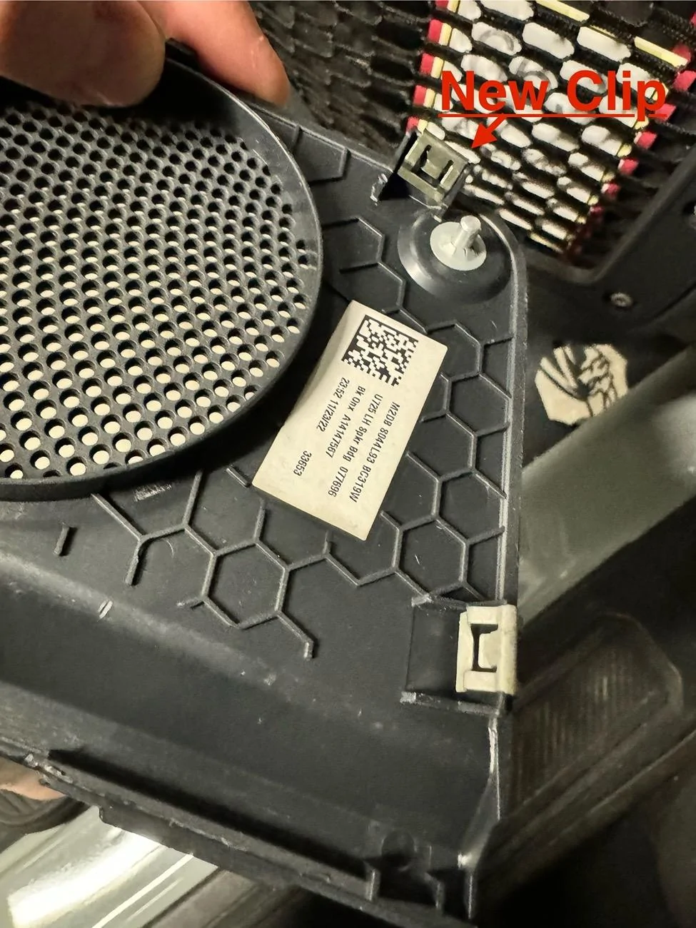

Resurrecting this as I recently lost one of these dash speaker cover clips and have been hunting for a replacement. I found these that appear to be identical, and as they seem to be out of stock at many dealers, and will update if they work.
uxcell 10Pcs 7mm Hole Metal Rivets Car Interior Dashboard Panel Trim Clips Retainer
Just to follow-up, I tried 3 clips out of the 10 pack and they worked…sorta... However, on 2 of them, the cover was a bit loose and not totally snug against the dash. The 3rd clip made a snug fit and worked like a charm. So your mileage may vary with this alternate...
