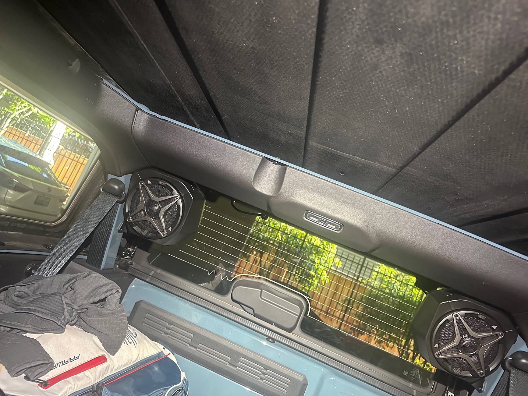

Installed and working great! The rears are getting the full range of sounds now. Definitely a noticeable improvement in volume and quality, especially for rear passengers. I was able to adjust tone in the ford sync system, even with the EQ disabled. I turned up the base and mid a bit. Plug and play.
Ford Bronco Installing SSV Works 6.5 pods IMG_6797
I wouldn’t say the speakers have much “booming” base, but they are at least “full” sounding, unlike the stock 4in tweeters. The factory amp doesn’t have the power to really push them that heard anyways. Phase 2 will be a standalone subwoofer. I don’t feel the factory amp needs an upgrade.
