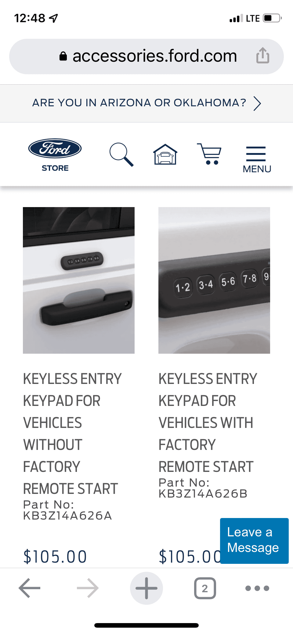

That's what I can't figure out. There's conflicting info on the internet.
KB3Z-14A626-A
or
KB3Z-14A626-B
KB3Z-14A626-A
or
KB3Z-14A626-B
Pretty straight forward… A is without, B is with.
The dealer list says the opposite, same with some of the internet sellers. I'm looking for a response from someone that has experience purchasing this item.
Well, allow me to provide some input.....see above post. I installed this on our Base months ago. Base - Without - A
Not sure if you are aware, this must be done at a Ford dealer. It requires the FDRS system to get it recognized and assigned to your vehicle. It is not a Forscan option and you can not do it yourself without FDRS.
Great, so your base was a manual trans?
No, an automatic.
Do not confuse remote start in this context. Remote start is standard on 100% of EVERY automatic transmission Bronco made. All of them! This feature is available through the Ford Pass app. The difference in keyless entry keypad options is differentiating those vehicles that have a higher trim level that comes with a remote start on your keyfob.
Manual transmission has NO remote start, regardless of trim level.
