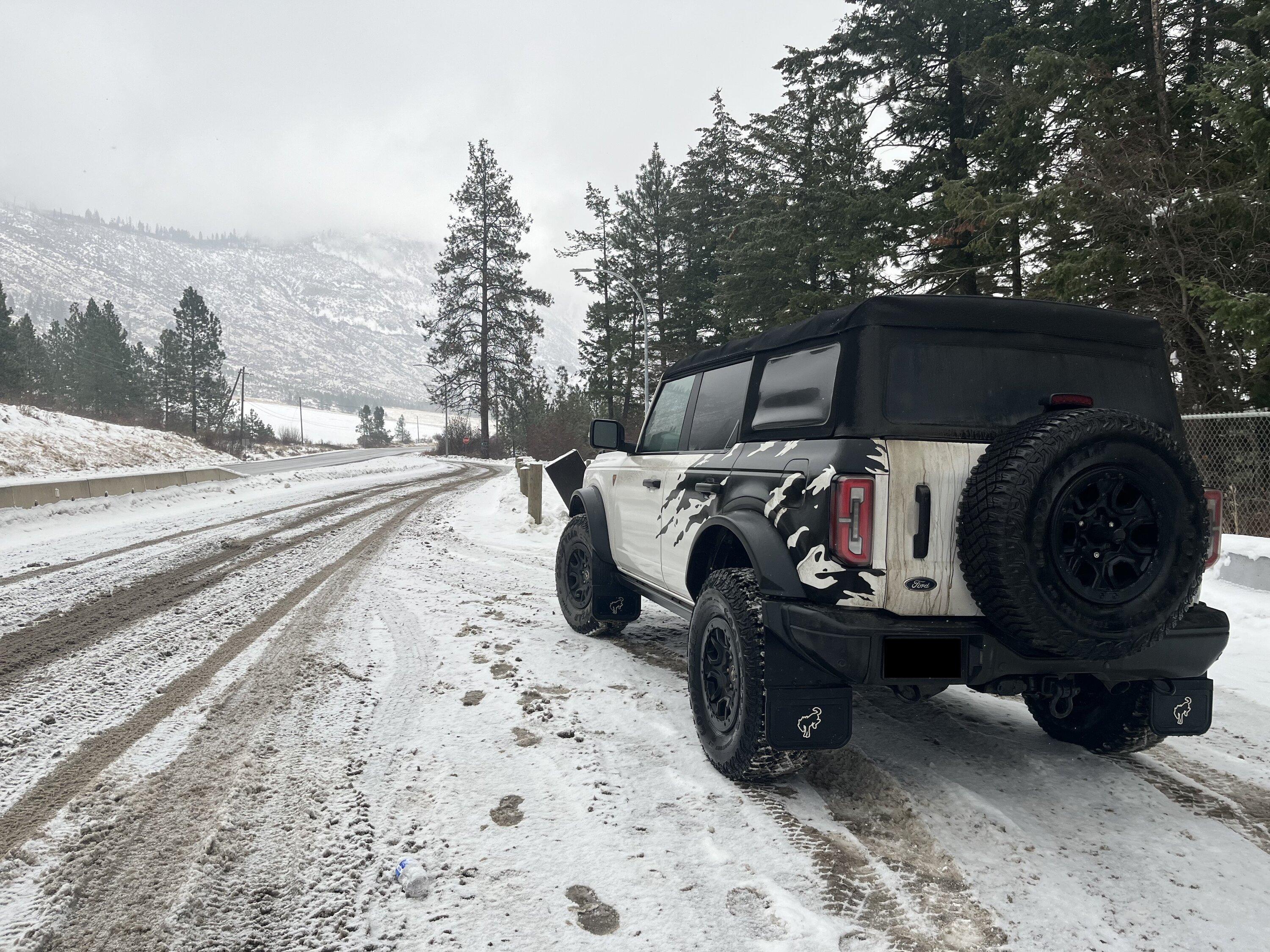

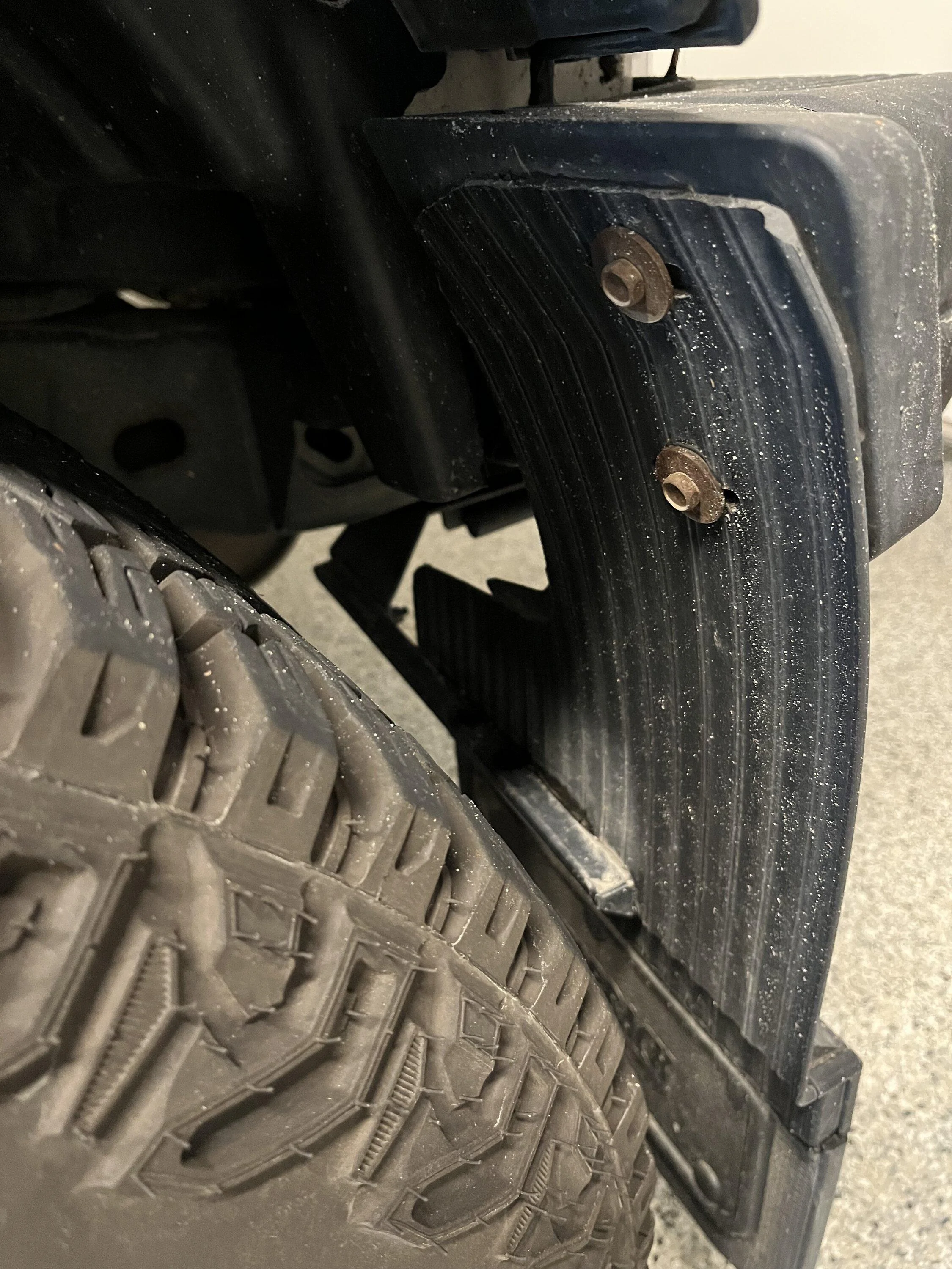

Can you confirm whether or not you had to drill into your rear bumper for the install?
To be totally honest, I didn't install them myself. But here's a picture of my rear flaps, if it helps - Looks like it's drilled into the bumper though and seems pretty sturdy. I have a Sasquatched Badlands.
Ford Bronco Install Gatorback rear flap question IMG_1559
chtucker
Nov 24, 2019
184
2,159
4,085
Kirkland, WA
FJ Cruiser
Yep, they should be drilled with self tappers. A tiny drill bit to get the started and a ratchet works.
I did it with a regular drill, a right angle drill be slightly easier, but it's not necessary. I used a regular socket/ratchet to finish it off.
