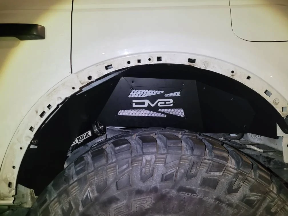

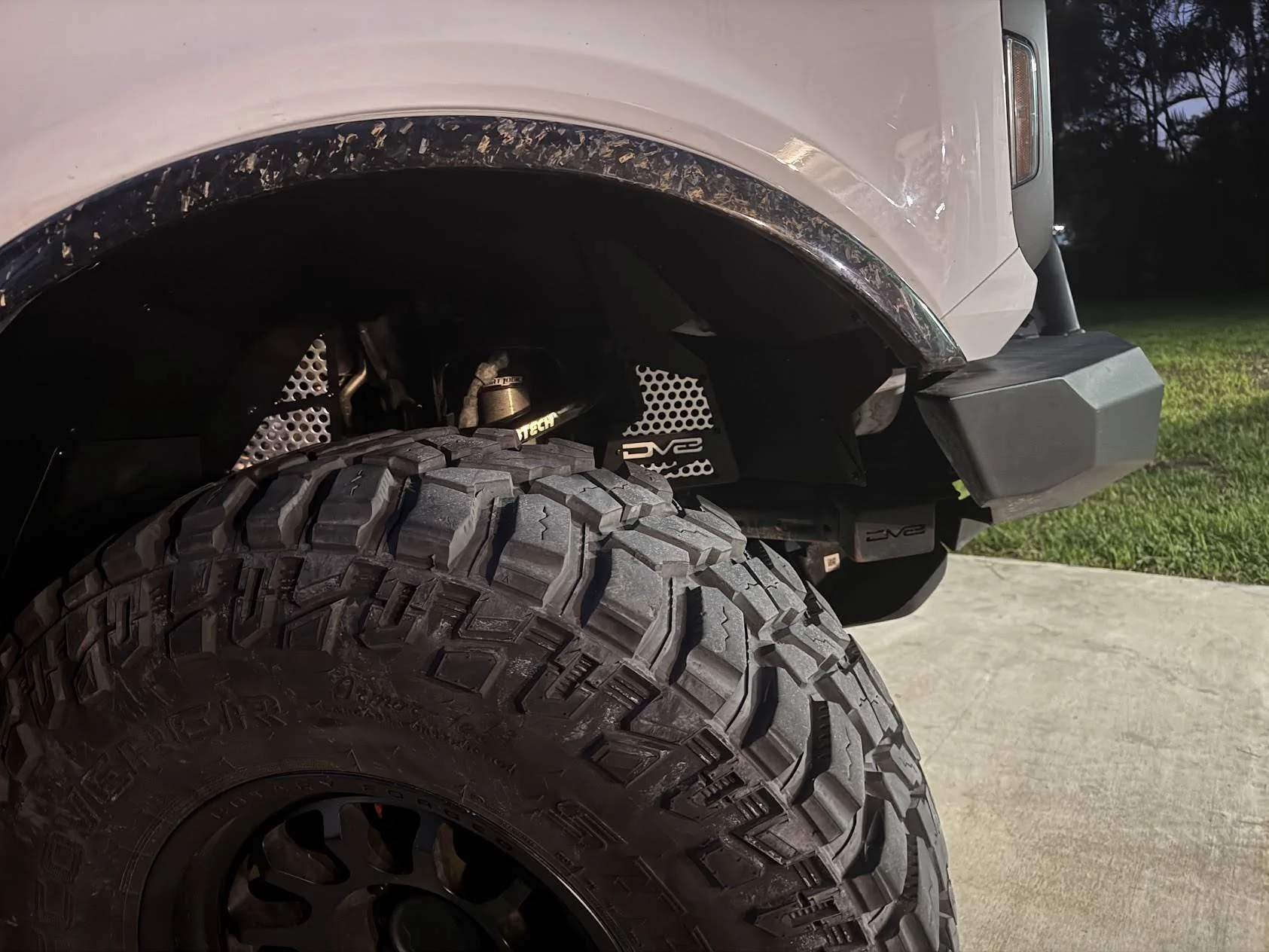

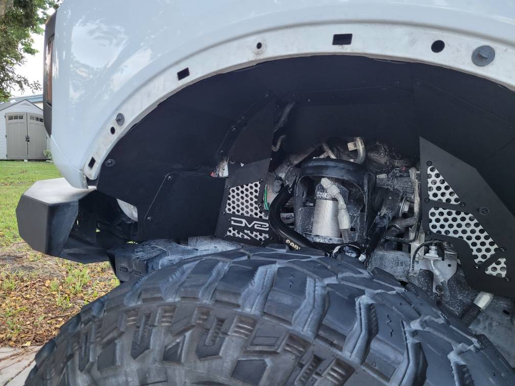

Well since this post, I have purchased a set of DV8 inner liners as their price has come down considerably, and even more so when there is a sale.
With the install, I used locktite, and I also used washers when it came to mounting to the fender. I made sure everything was tight and the fit was good. I did need to modify and cut in some places for my reservoirs.
As for cleaning, very easy. Just take a wet cloth, put whatever product on it, and wipe clean. easy peazy. No squeaks and no rattle so far.
