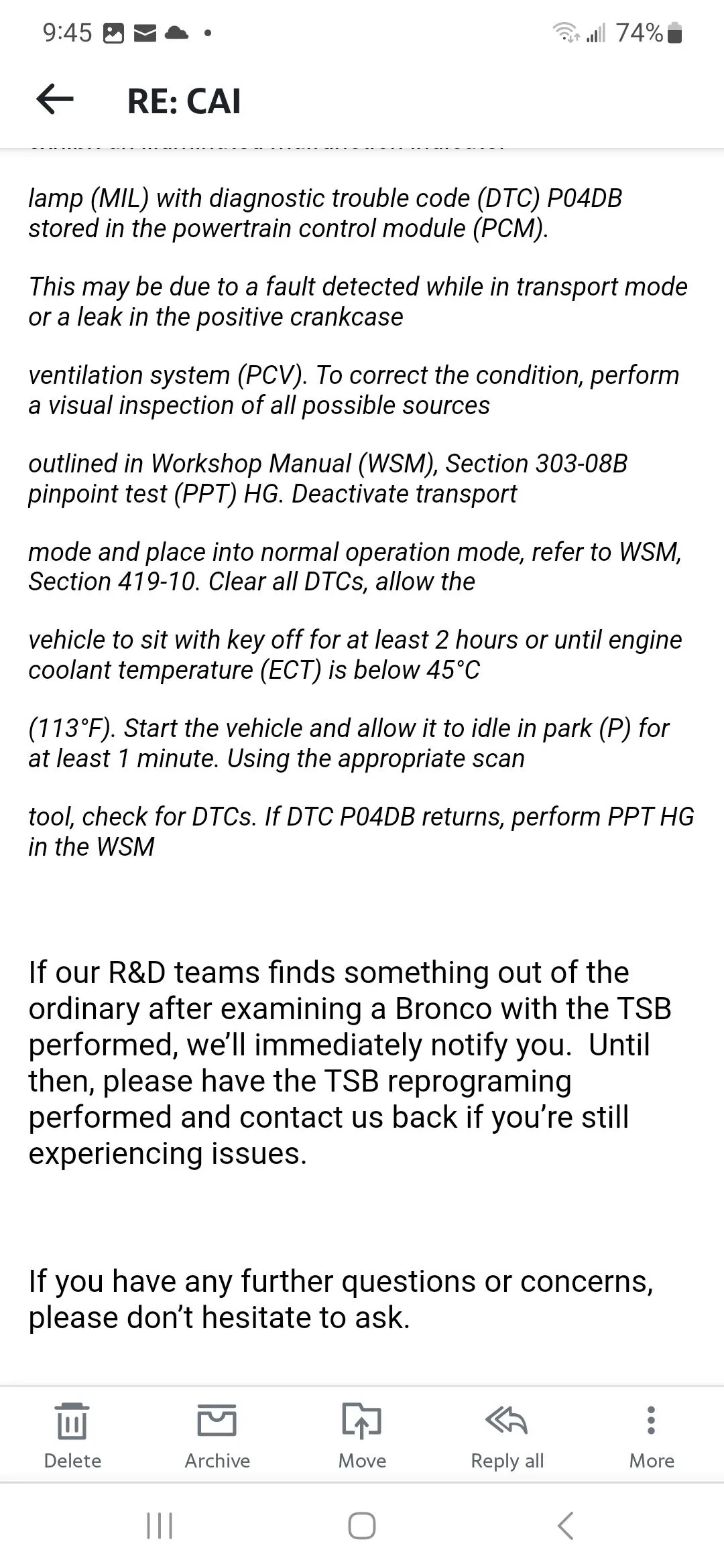

23 2.7 litre. Mine was at Ford today. They did a flash which was a TSB for one of the codes that mine was throwing earlier with the double catch can from Mishimoto. Although I took that can off and haven't had the code since they flashed it for me anyways. But then there is another thing called an MMS I believe, and it has to do with the code P04DB which is what the cold air intake is throwing. Ends up it needs some sensor replaced which they had to order for me.🫤

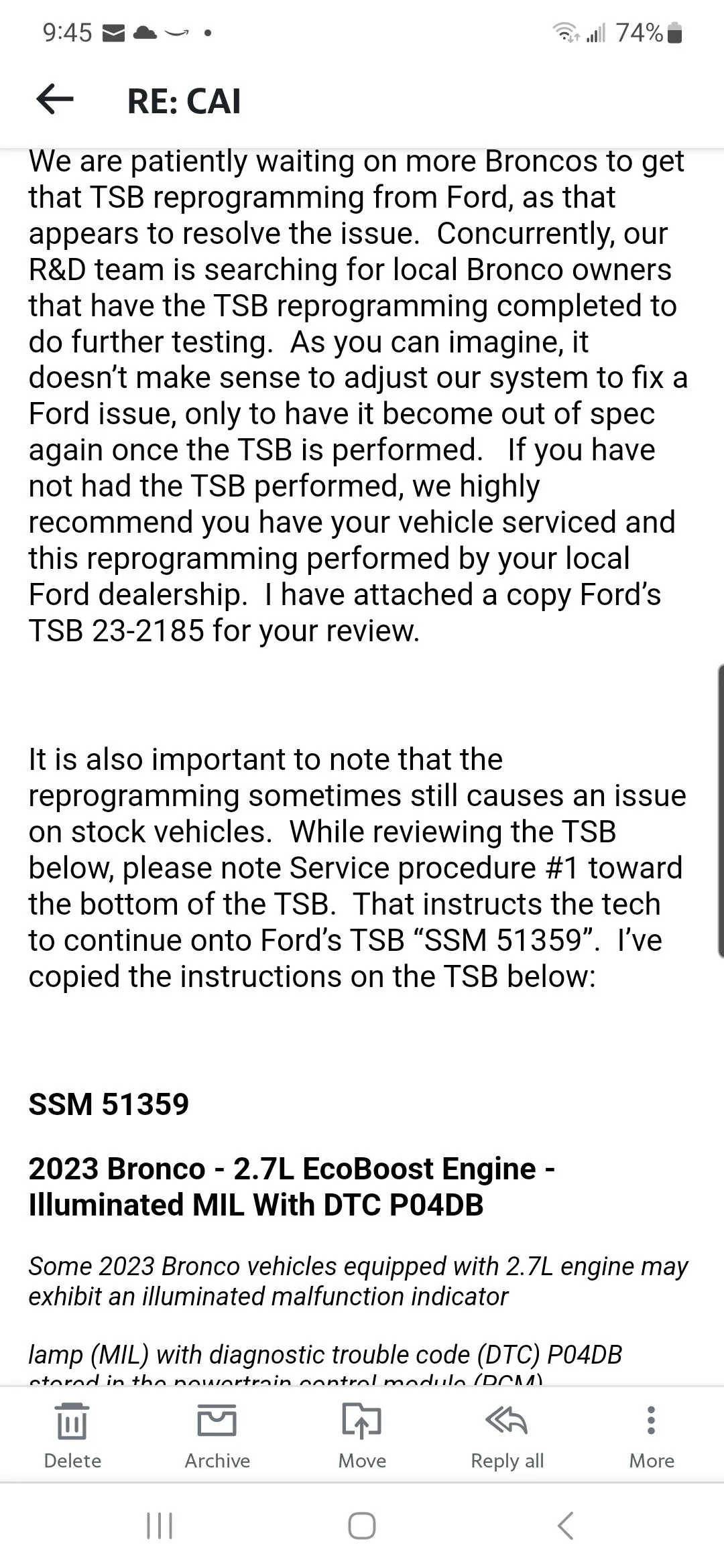

Only the 23's, Correct! Had it at the dealership today. They did the TSB for the code that I believe was being thrown by the dual catch can which is not the same code that is caused by the cold air intake from Injen. That flash did not fix the code that I have right now which is P042DB. But there is an issue with the model year 23 2.7 engine throwing that particular code also, It's not considered a service bulletin but it's considered an MMS which I'm not sure what that means. So in the end to fix that problem I believe they have to put a new sensor in that must have to do with the CCV portion of this system also. They told me the part is a week to two weeks out so until then I just have to drive around with the engine light on as he suspects it will probably come back on even though he reset it. That's the latest update I have. Luckily the master tech there does not think this intake is causing the issue, although I didn't have this issue until we put the intake on! I was not charged anything for the flash or the service that he did today and won't be charged for the next visit when they do the fix with the sensor. 🫤 Injen wants me to get the specific sensor that they are ordering which I will try to get that information tomorrow and keep everybody updated.

You are correct! Injen should have come up with a way to get the filter out without pulling the whole damn thing apart. Not impressed!! also, this says it better than I did. This is from someone at Injen.
