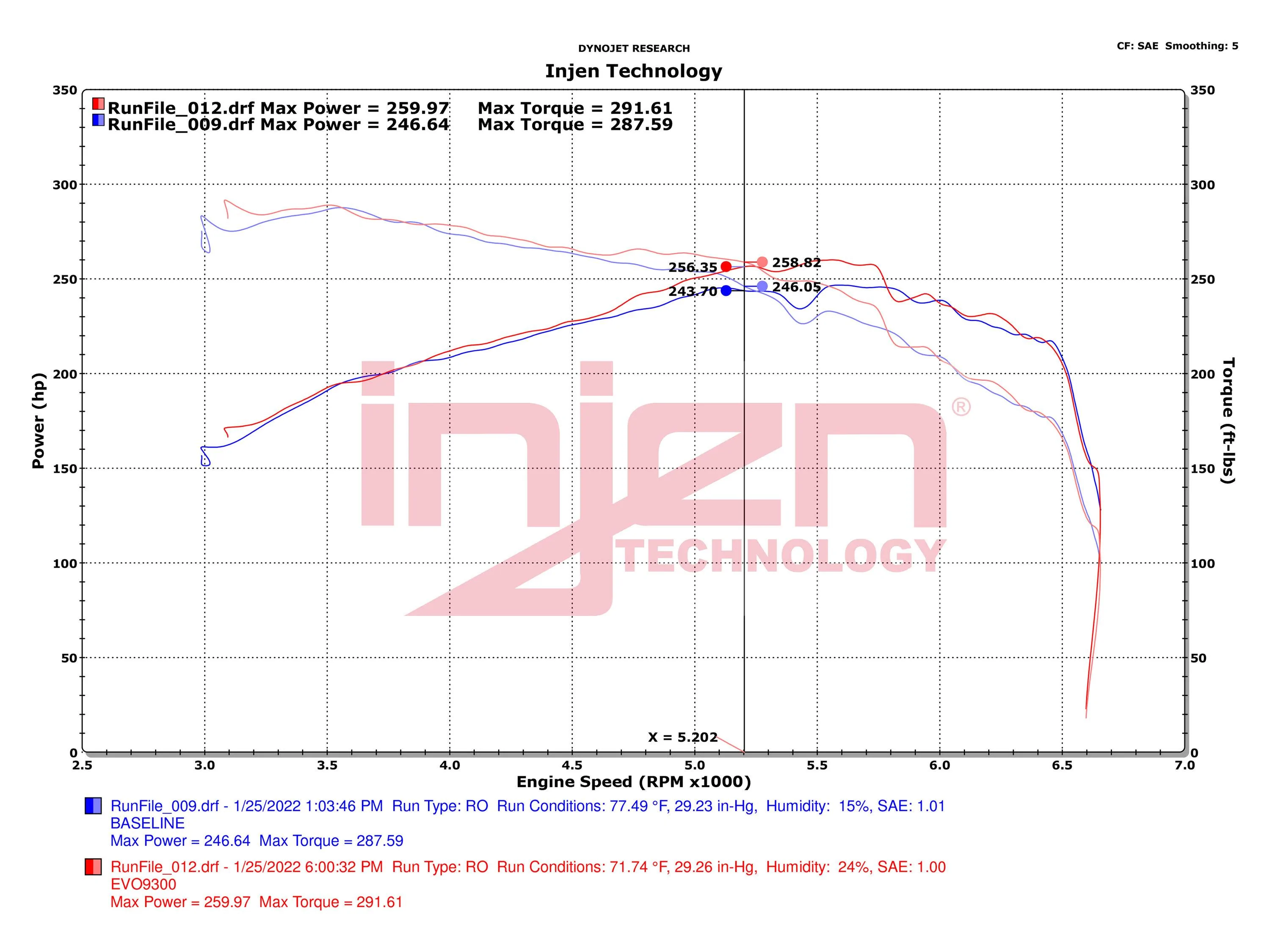

Just to give a little context... here is the dyno graph from our own testing using our in-house DynoJet. Here you will see gains more at the top end of the RPM range. These are typically where most 4 cylinder engines shine.
Ford Bronco Injen intake installed on 2.3 Bronco EVO9300DYNO

Just want to make sure I'm interpreting this right. Is this saying that with the only modification being this new CAI, you are measuring a 13hp gain somewhere around 5500rpms on the 2.3? If so that is both extremely impressive, and also goes against most common thinking which is that you might get a few hp if lucky). I'll admit that I am a skeptic but I would love to be wrong.

That is correct, the intake was the only bolt-on on the Bronco at the time of the dyno session. Obviously these numbers are not set in stone as conditions are always going to be different day-to-day and also the variation of each dyno reading different (hub dyno vs. chassis dyno, etc.). We here at Injen are all about the gains you get over the baseline. That's what really counts...

Manual or auto transmission used for dyno results?
