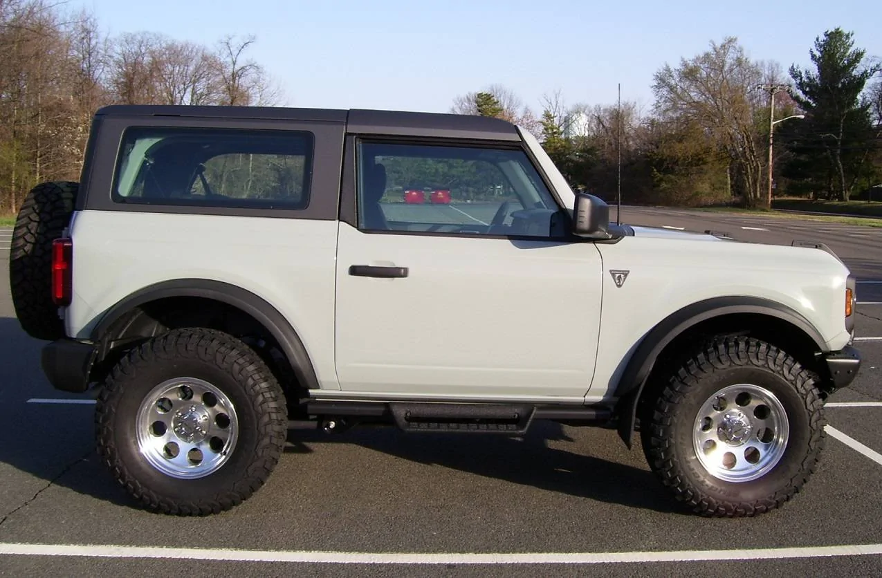

My stock 2 door base 2.7 Sas has MB3C-5534-ABE tags on the springs (I'm assuming this is the engineering part #). Is there any way to identify the specific application for these springs? My truck seems to sit a little high in the rear and I was wondering if it ended up with springs that were intended for a 4 door or a truck that should have had the metal rear bumper or towing.
The picture is with the 35x12.5x17 General X3 spare that weighs 77 lbs so it's a bit heavier than the stock Goodyears.

Rake is pretty normal for stock suspension. Very unlikely you have the wrong springs. Although if you send me your VIN I can see what it should have.

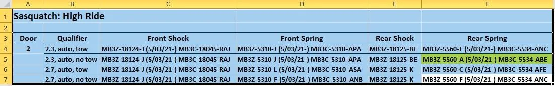

So it looks like my rear springs are for the Sas 2.3 no tow and I have the 2.7 no tow (I did add a hitch myself) so it might be a misbuild. Is the 2.3 muffler heavier than the 2.7 muffler which could be the reason for different rear springs?
Ford Bronco Identifying stock Sas springs Sas_shocks
Edit: So according to Ducati1098 my springs are correct for my build, that spreadsheet is probably a bit outdated with all the combinations they have.
