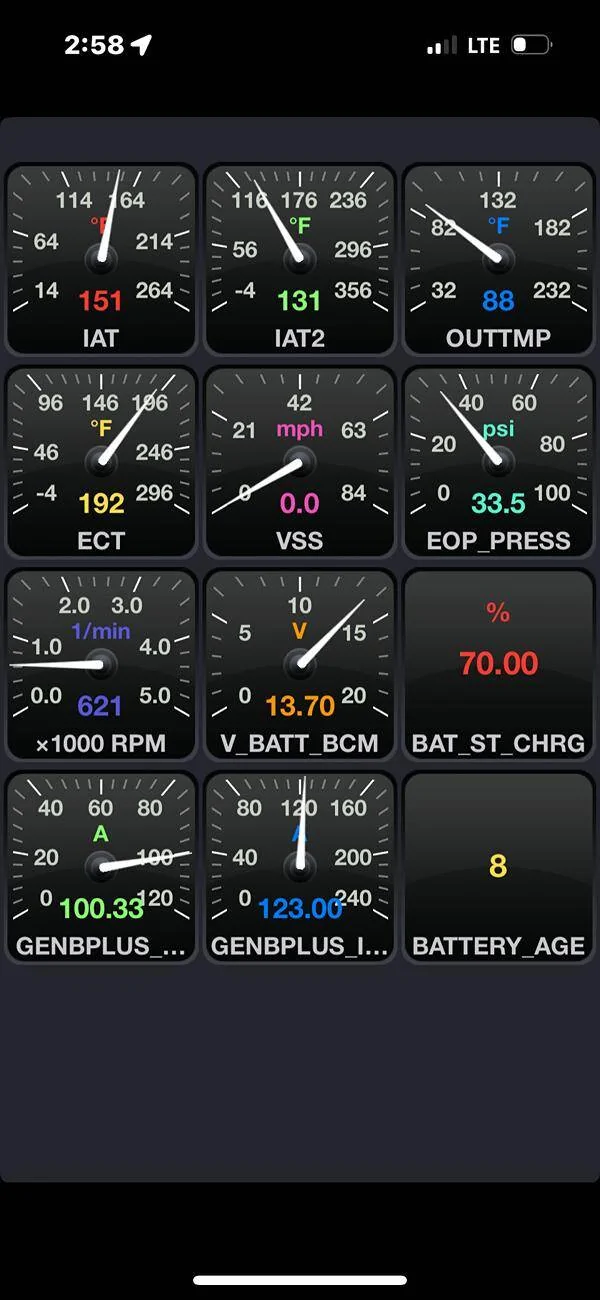

I did a quick search and didn't find out - does Forscan or Forscan Lite log these values? I know ProCal and other tuners do, my JB4 doesn't - and I don't have my laptop handy to log into & connect Forscan this week. Thanks!

I don't know about these specifically, but in my experience Forscan has ~much~ more available data than the ProCal module does. ProCal seems to only look at a couple of the modules, Forscan can see everything your adapter can see.
So I would bet if ProCal can see it, so can Forscan.
Have not played enough with Forscan Lite to verify on that though

I was able to Forscan today after all and both IATs are there, so that’s easy. Burger is still indicating I can maybe get both in JB4, it’s just easier to log there while driving.

Success with Forscan Lite - I’ll put it on the other thread but for a $40 OBD and $7 app, I got all the otherwise elusive things displayed and logged via iPhone, on a BT connection :

Nice. I’ve thought about getting Lite. I have the free edition but it’s very underwhelming.
The app that comes with the MX works for the most part and I only use it very occasionally. Although maybe I should look into using it more often… $7 isn’t too steep

I’ll put this OBD dongle in the Forscan thread later and it’s not the one they recommend, but a lot cheaper and it works well.
Apart from the sticker it looks Identical to the MX. Funny.
