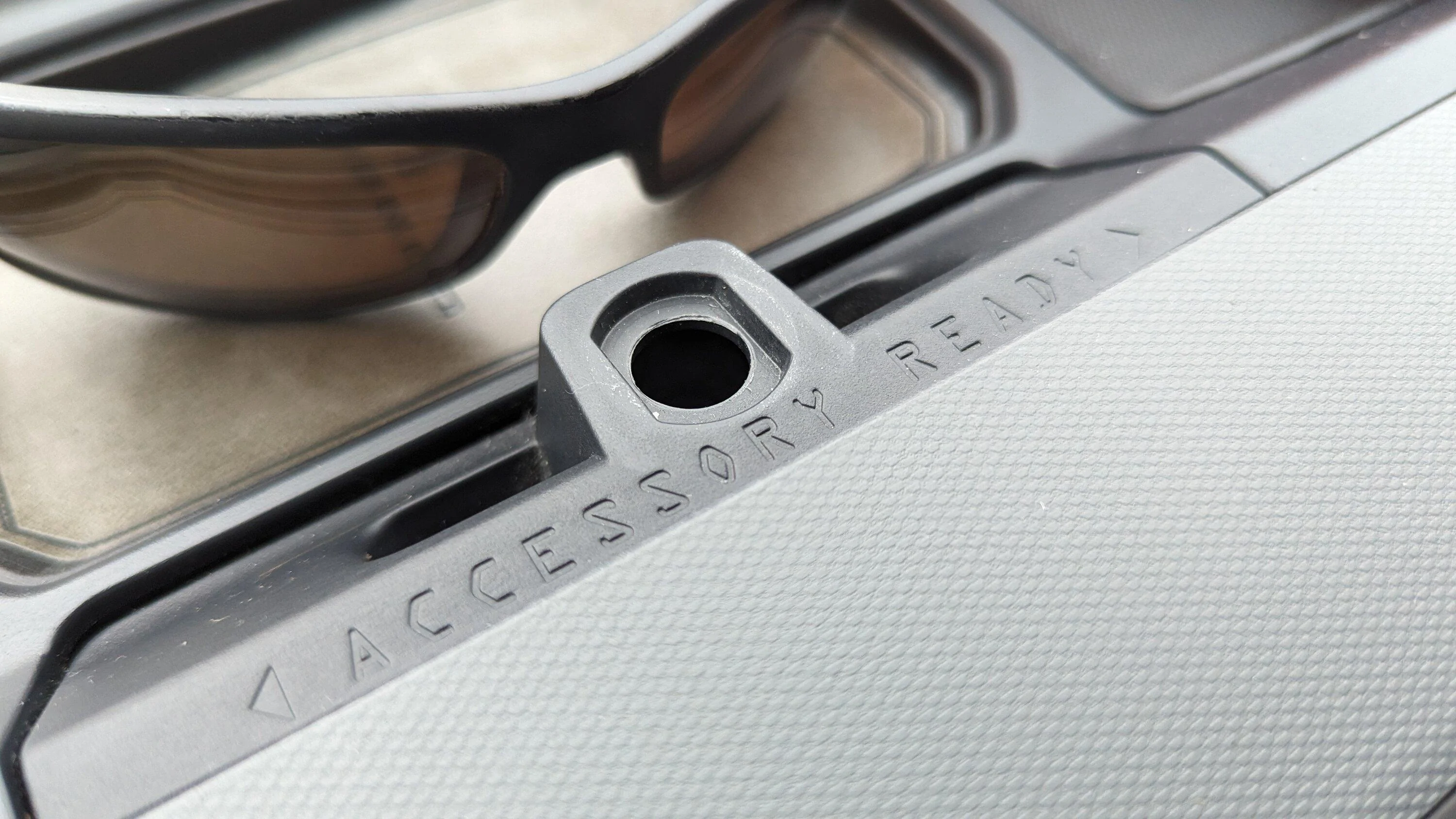

How do I replace this?
Ford Bronco I guess I lost the threaded mount insert? 1000013089

Probably gonna have to replace the whole panel. Call your "favorite" dealer and see if theyll cover it (should be cause doesnt appear to be damaged).

Nah. It is in there. This happened to me a couple of weeks ago. Two screws secure the little panel, and the castle nut will be right inside. Little loc-tite on reassembly and you are good to go. Assuming of course you have not lost the t-bolt that goes on the on the outside.
This is the video that got me on the right track. Super easy. 5 minutes once you find the proper torx driver for the screws. The hardest part is finding the angle to hold the torx driver.

Could replace it with the Mabett power panel and get some USB ports up there once it's back in stock, or mail you my old one if they don't replace yours.
Edit:
Get a magnet or vacuum in these holes, the exterior nut might have slid in there.

Thanks so much. I'll try this in the a.m. really appreciate it!
