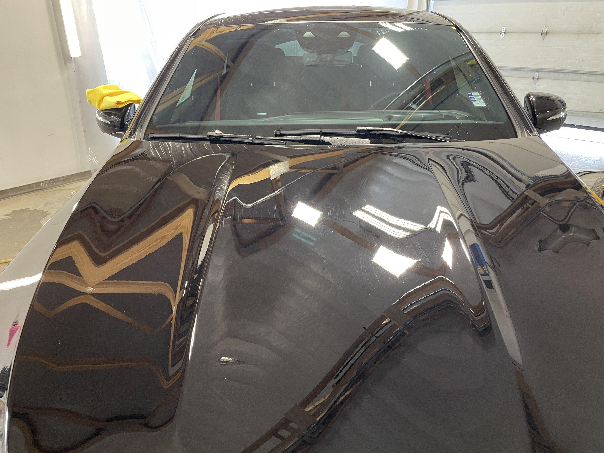

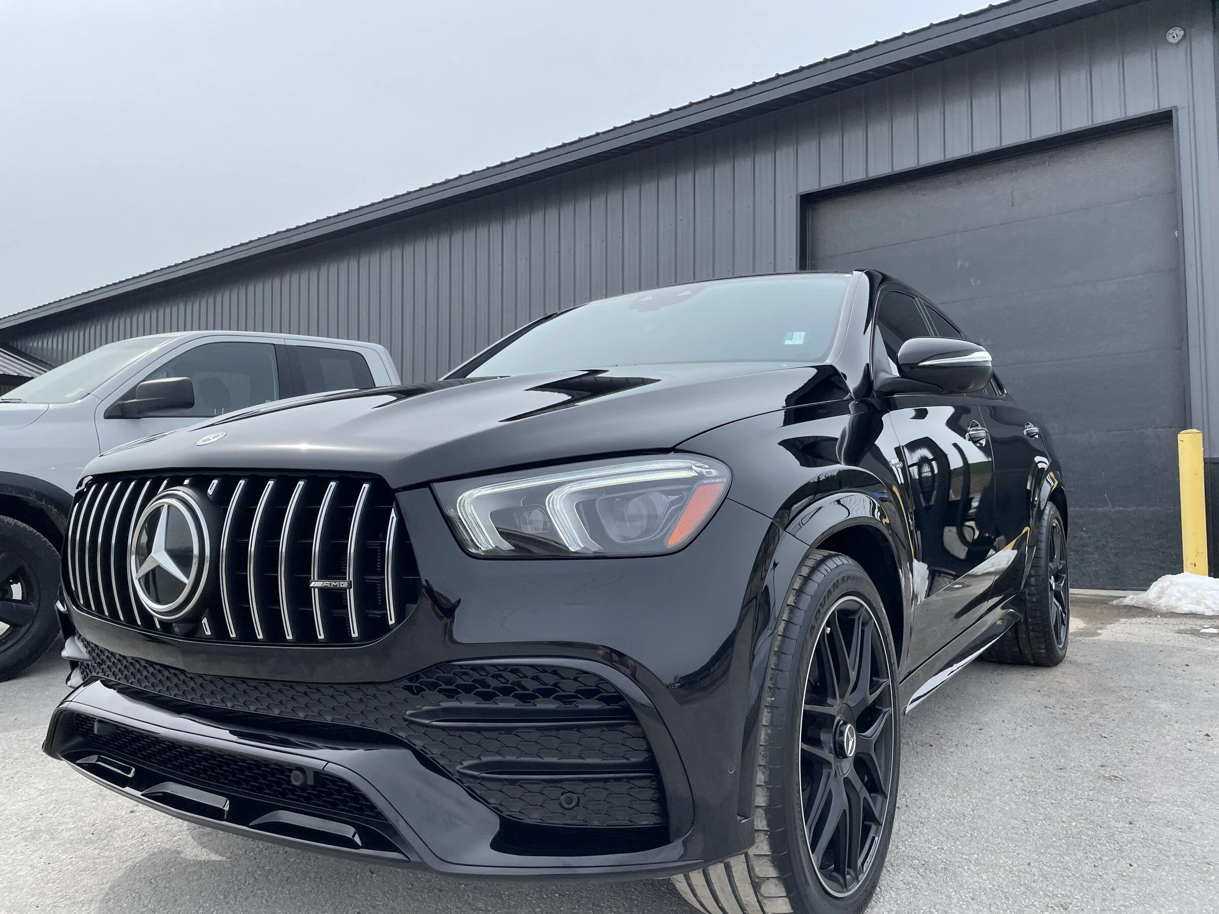

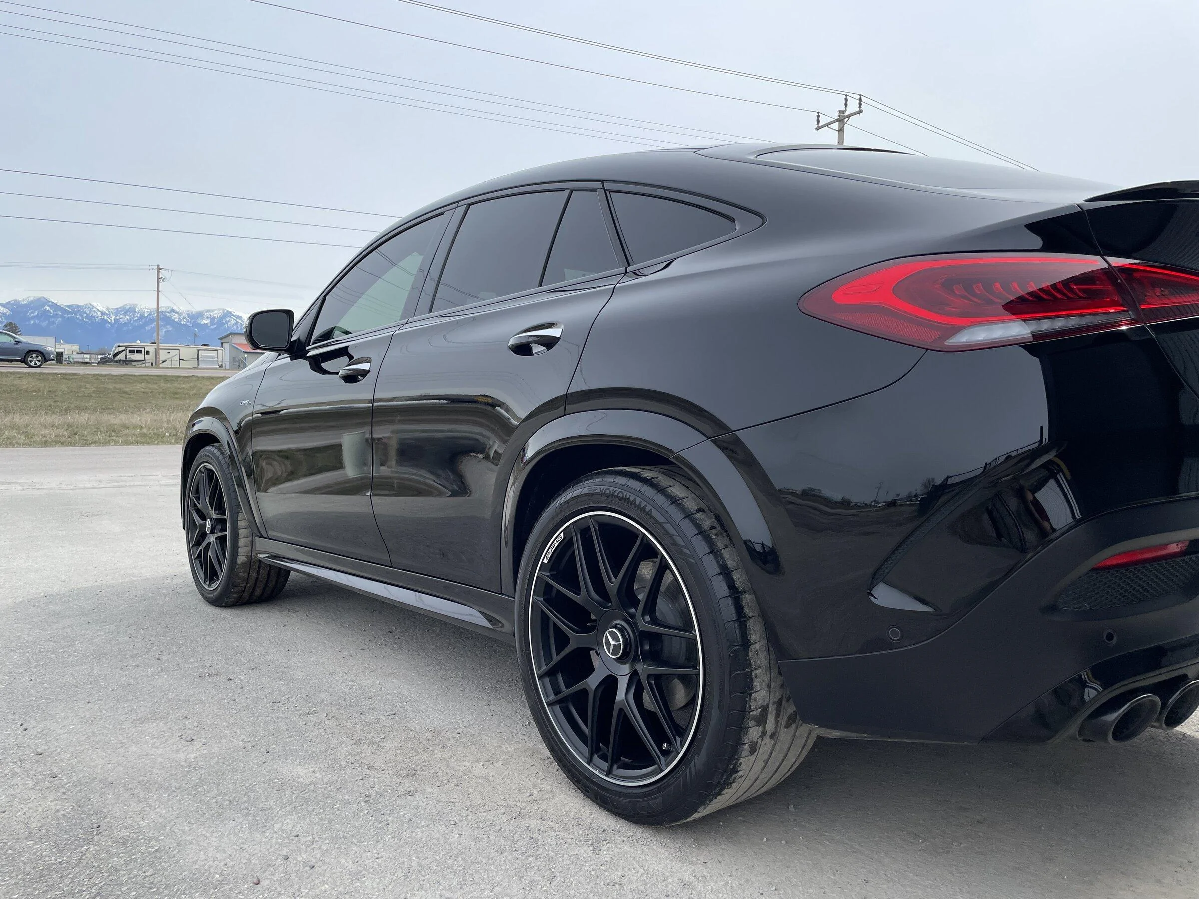

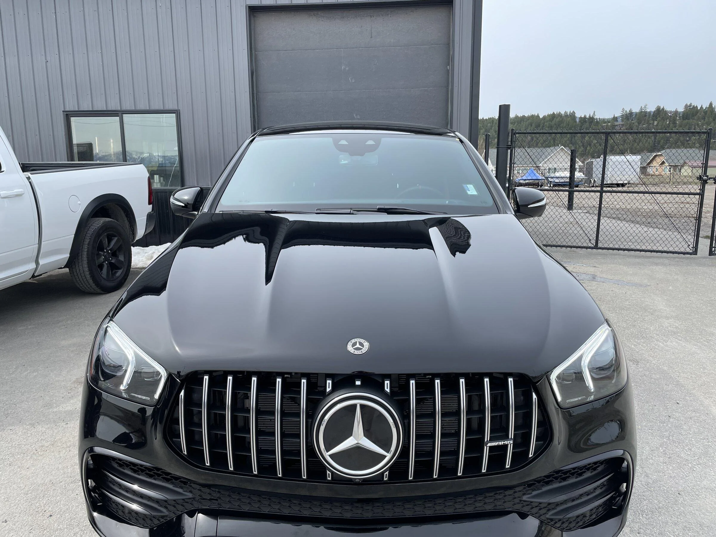

Paint correction is taking out defects in a cars paint. Say you went through a non contactless car wash. You more than likely will have scratches and swirls and maybe holograms. What I’m asking is how easy is it to correct, or get those defects out. I’ll attach some before and after shots of a car I corrected a few weeks back. (The after pictures were taken outside of the shop)((also watch the video first for a better understanding of paint defects))
That Benz is one example why I appreciate the back to the basics looks of the Bronco. To me it screams contrived -- IDN I guess some like it so many cars look like this.
Just under 100k for that. It has AMG badging but isn’t that quick, it’s ugly as sin, and you can’t do nearly as much as a bronco in that Benz. Im right there with you my man, I’d take a bronco over that any day of the week.
Forgot to mention that it is a used car as well.

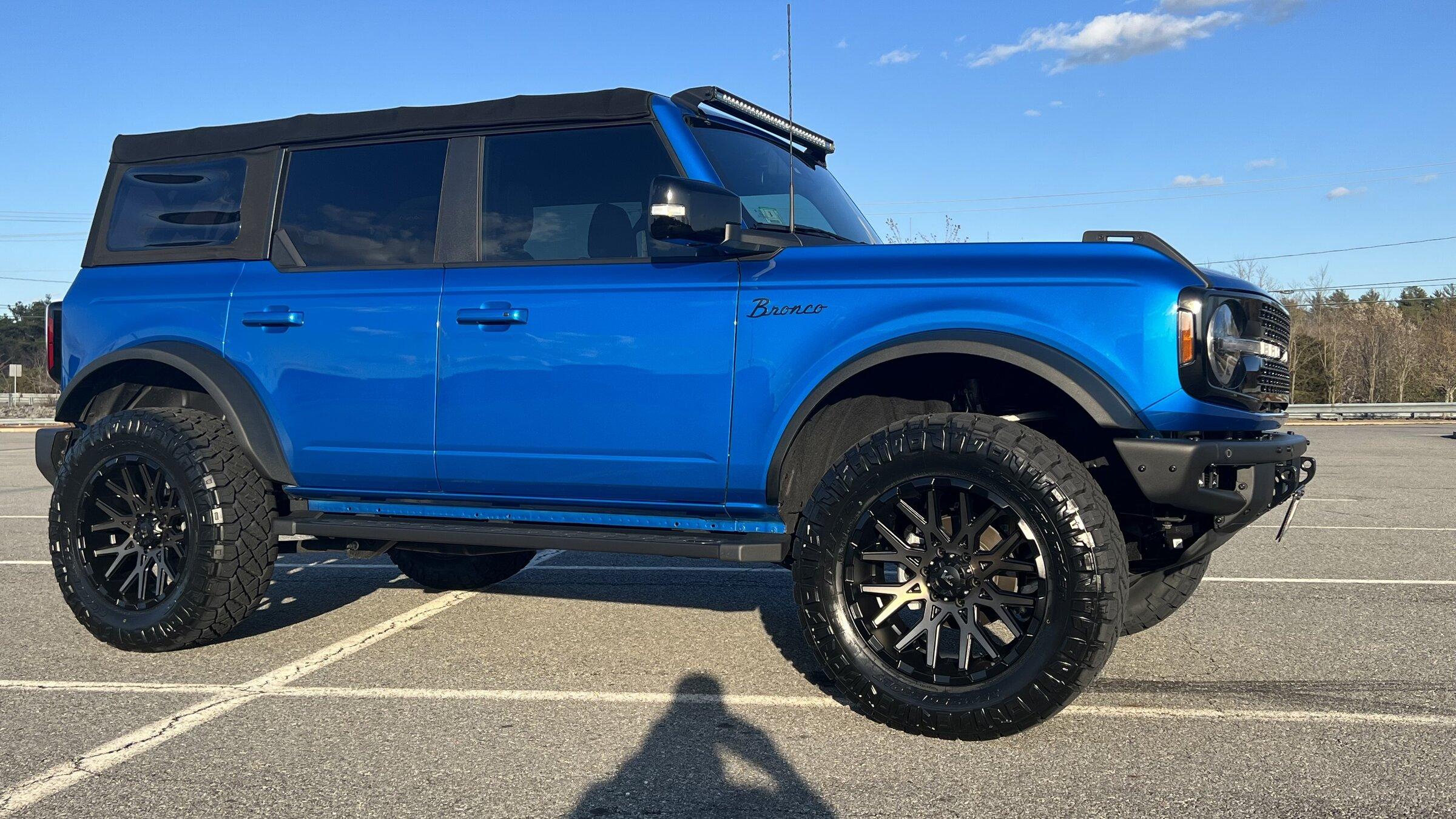

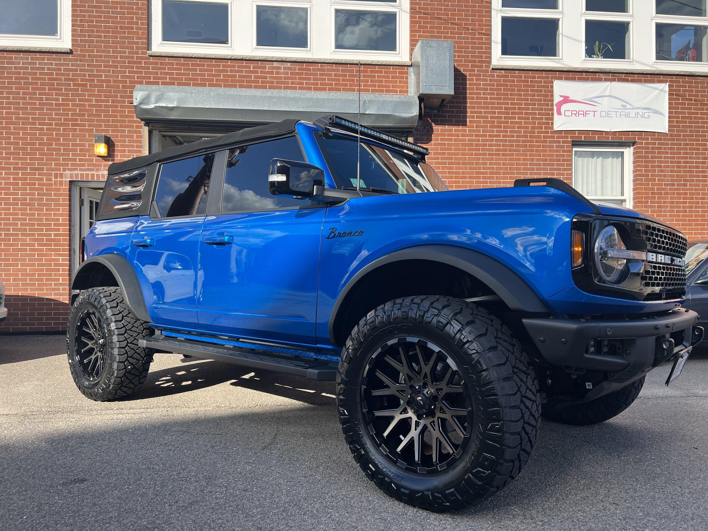

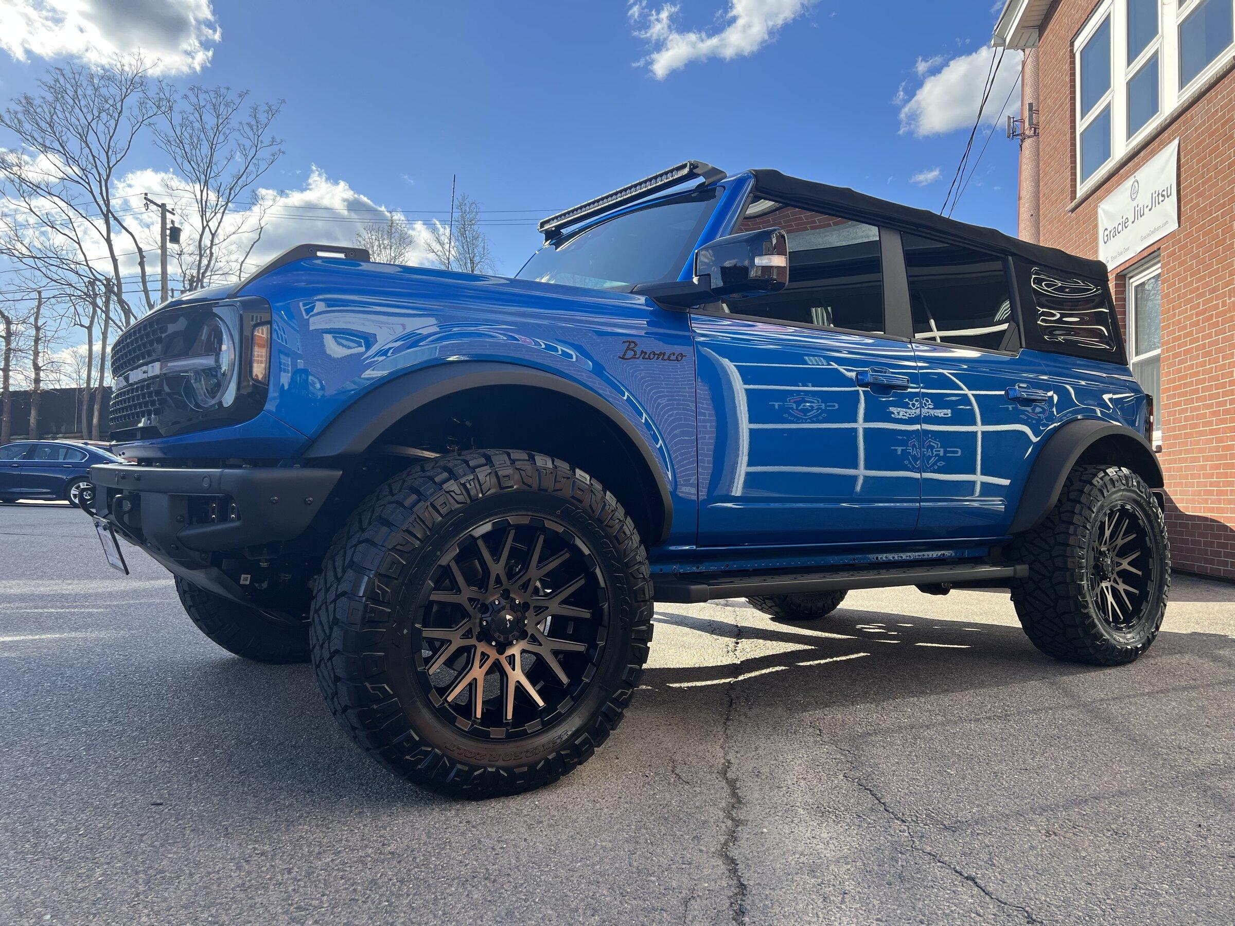

Hello guys and gals! I’m looking at buying a wildtrak and wanted to know how well the paint corrects on the bronco. I unfortunately I haven’t had any come through out shop so I haven’t been able to test it on my own.
I had my wildtrak paint corrected and ceramic coated and it came out fantastic. The pictures don’t even do it justice
Ford Bronco How well does the Bronco paint correct? C00EB9E9-3127-4BA4-8C9F-E395DA1DBF3E
Ford Bronco How well does the Bronco paint correct? 5B975DB6-646F-4538-A366-BEEAD1C433BA
Ford Bronco How well does the Bronco paint correct? D66C80E6-80DA-4D5C-8D99-539D0BA40F78
