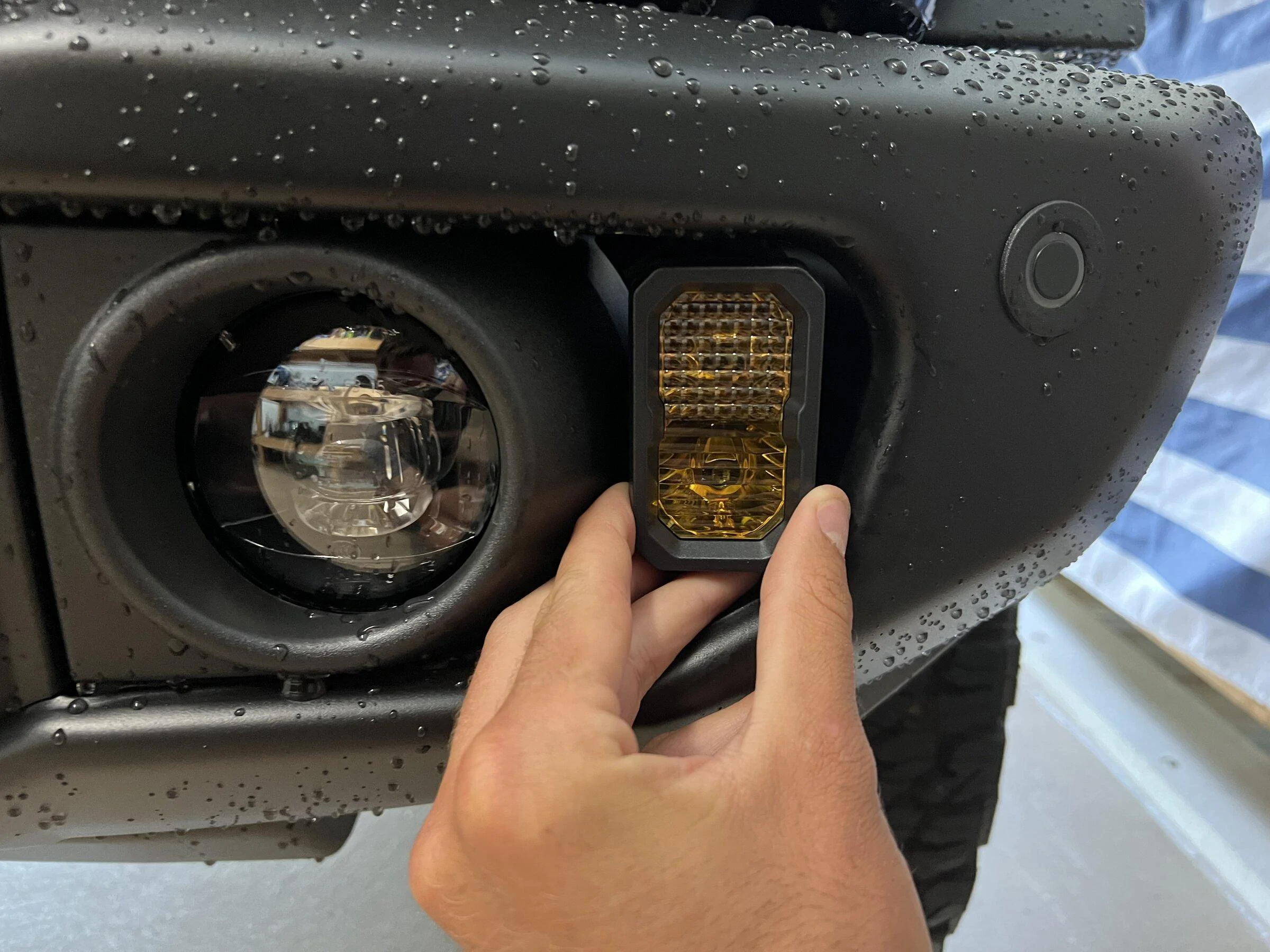

So, I am doing mine right now....
I got the kit from @Diode Dynamics that is advertised as the replacement for the factory fogs on the STANDARD bumper. It comes with the little bracket.
Where are you saying you need to drill?
This is what I did:
When you put the bracket on the SS3 and drop it in....it does bump into the plastic housing and doesn't sit as "flush" as the round factory fog.....
What I did was put some m6 nuts I had lying around to work as "spacers", and then just bolted the ss3's in using the factory hardware.
I also have the ssc1's to try in the side pocket. Because of the curvature of the housing, it looks like the only way to make that work is to drill the top and mount the bracket on the top side. looks like there is pretty easy access.
This is ongoing project now so I'll post updates as I go.
But heres' a few pics and a pic of the ss3 installed (with those spacers I used), it's in there tight.

^^ Factory Fog sits flush
Ford Bronco How to replace fog lights on Capable Bumper? tempImagezTx7aO
SS3 has a little gap (like maybe 1/4", due to the round plastic curve that it sits on top of. You can use spacers like I am, or you can be braver and trim the plastic. I didn't wanna trim so I used nuts as spacers)
Ford Bronco How to replace fog lights on Capable Bumper? tempImagetI99PY
^^^ nuts used as spacers (your factor T25 torx bolts don't thread through these nuts, don't be confused by that, they are literally just acting as like bump spacers)
Ford Bronco How to replace fog lights on Capable Bumper? tempImageofSOLa
^^ SS3 after tightened down
Ford Bronco How to replace fog lights on Capable Bumper? tempImageUN09ua
^^ Potential spot for the SSC1
