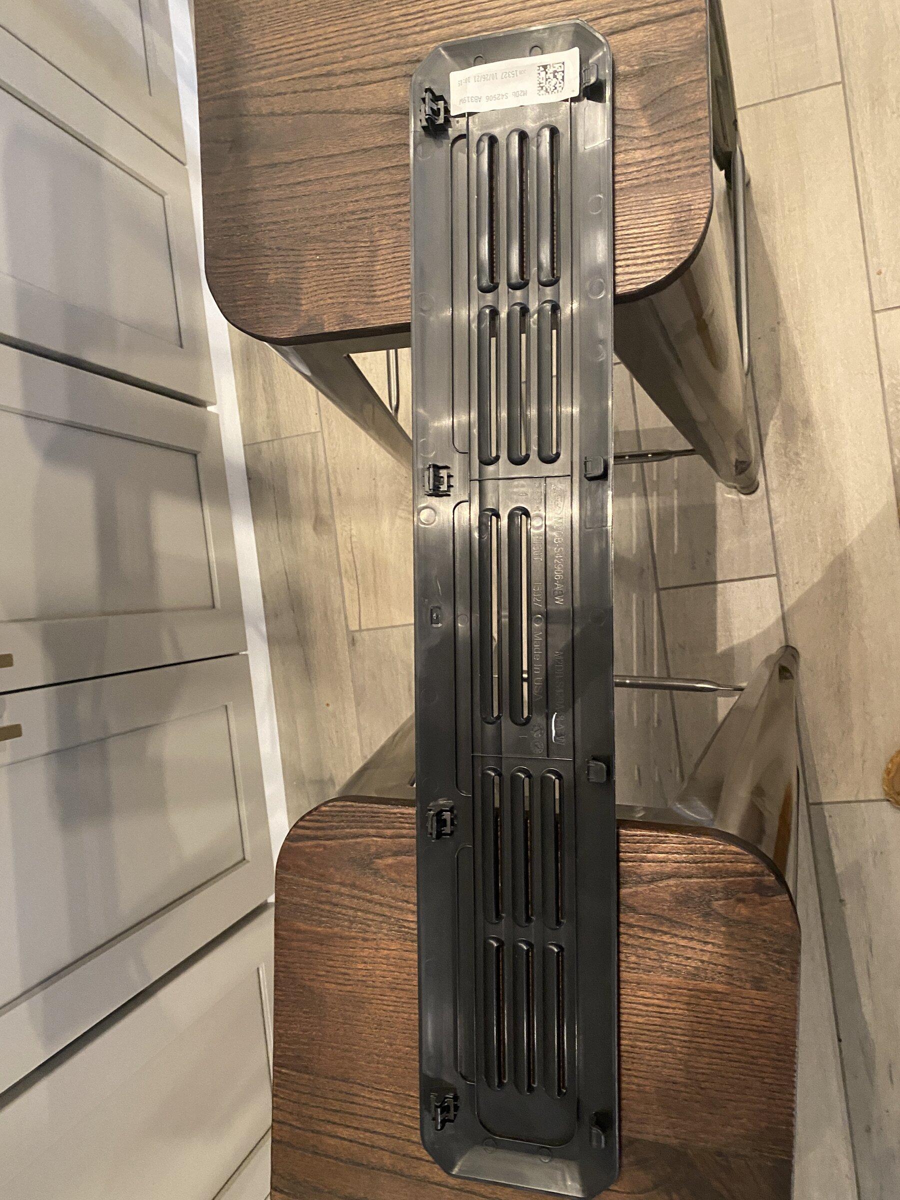

Use a plastic trim and pull from the bottom left or right edge, there are 4 pop tabs along the bottom and then slide it down towards the floor (there are angled slide tabs above each pop tab).
Right side in picture is the top of the panel
Ford Bronco How to remove accessory panel on tailgate? 54ADC848-0153-4336-9AF1-059972A585C1
