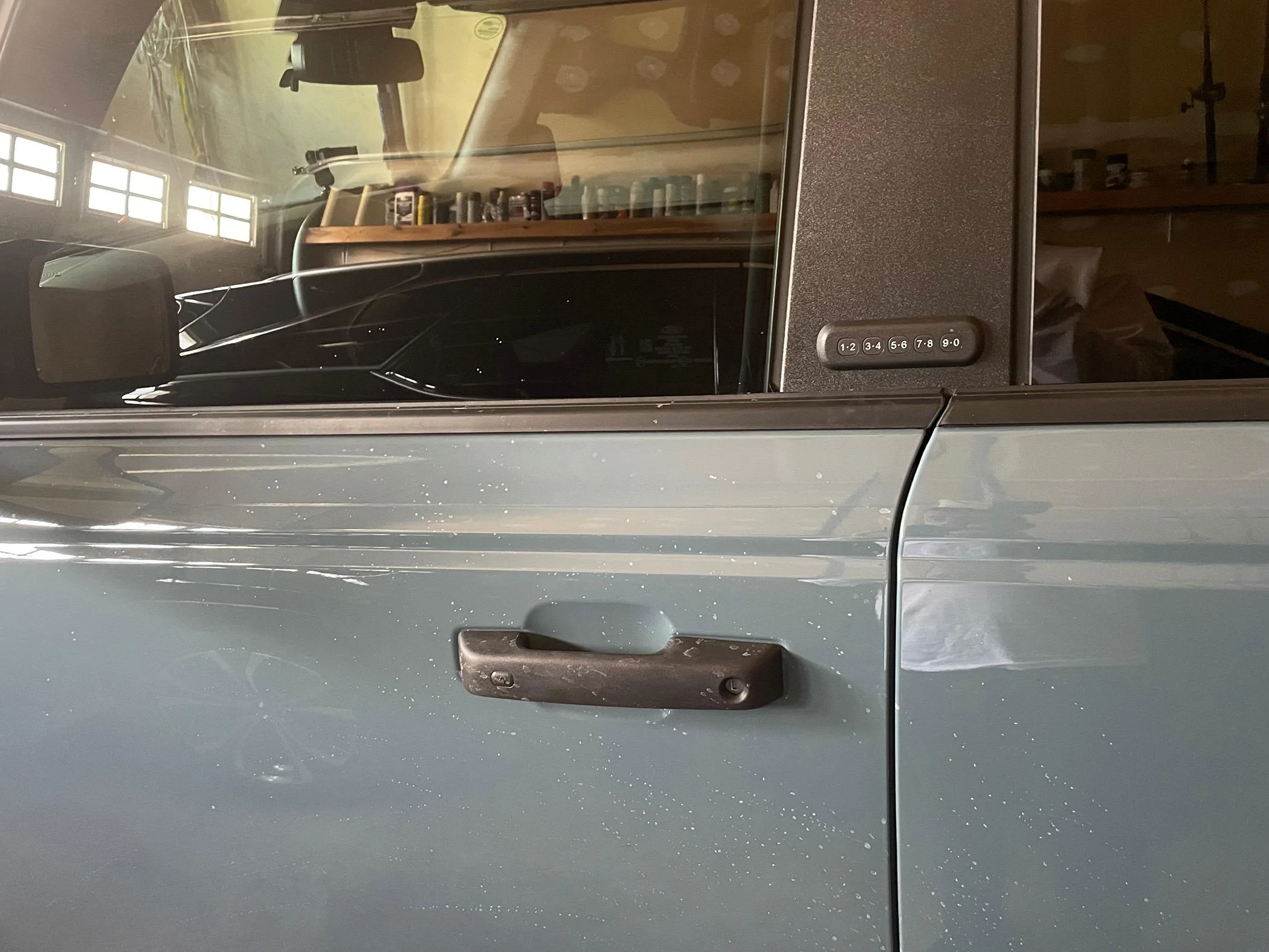

You're either the type of person that loves the keyless entry keypad, or the type that rarely uses it. But now that it is no longer available from the factory, seemed like a good time to record a how-to video in case you want to buy one and add it yourself.
Note that you will need FDRS in order to complete the steps, and because of that, for most people it will be more economical to simply have your dealer do it. But in case you wanted to tackle it yourself, or if you just wanted to see what the dealer actually does... now you have all the info.
Keypads can be purchased from your dealer's parts counter or HERE on Ford Accessories.
ps. If anyone in the New England area wants to have a keypad programmed for their Bronco, feel free to PM me.
Thanks for the write-up, @RagnarKon. It's nice to be shown how this works, and for some to know it's available. When I was young, I would occasionally lock myself out of My vehicle, so began to use a magnetic key holder to hide a key. When Ford started with these unlock buttons a couple of decades ago, no more magnet key! What a great invention! Now, we can also use the phone's Ford App to lock/unlock & start (but not drive), so the buttons are now a backup . . . But when I want to lock my phone and keys in the car while at the beach, the Unlock Button is an excellent backup alternate. I read people saying they don't need it anymore. However, I consider this a backup tool for entry, even if rarely used. I can also give the code to a family member who wants to get something out of the car. Great invention, whether used much or not.

it should have been embedded in the pillar vertically, like many other Ford products. The stick on thing sucks and look tacky. If you do it after order, it’s not painted so it looks terrible on the door. Now that these are DIO, are they all now black and unpainted.
