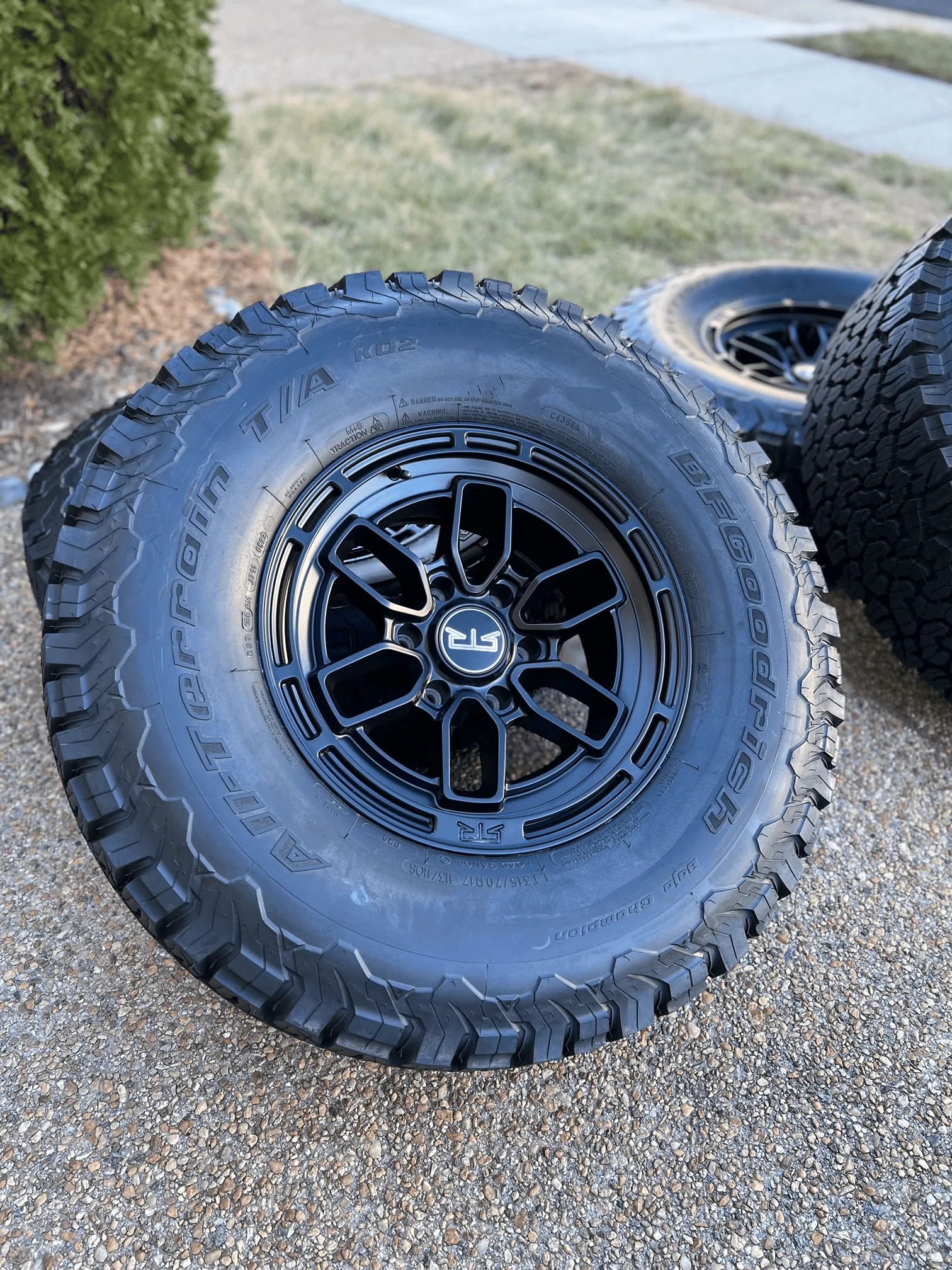

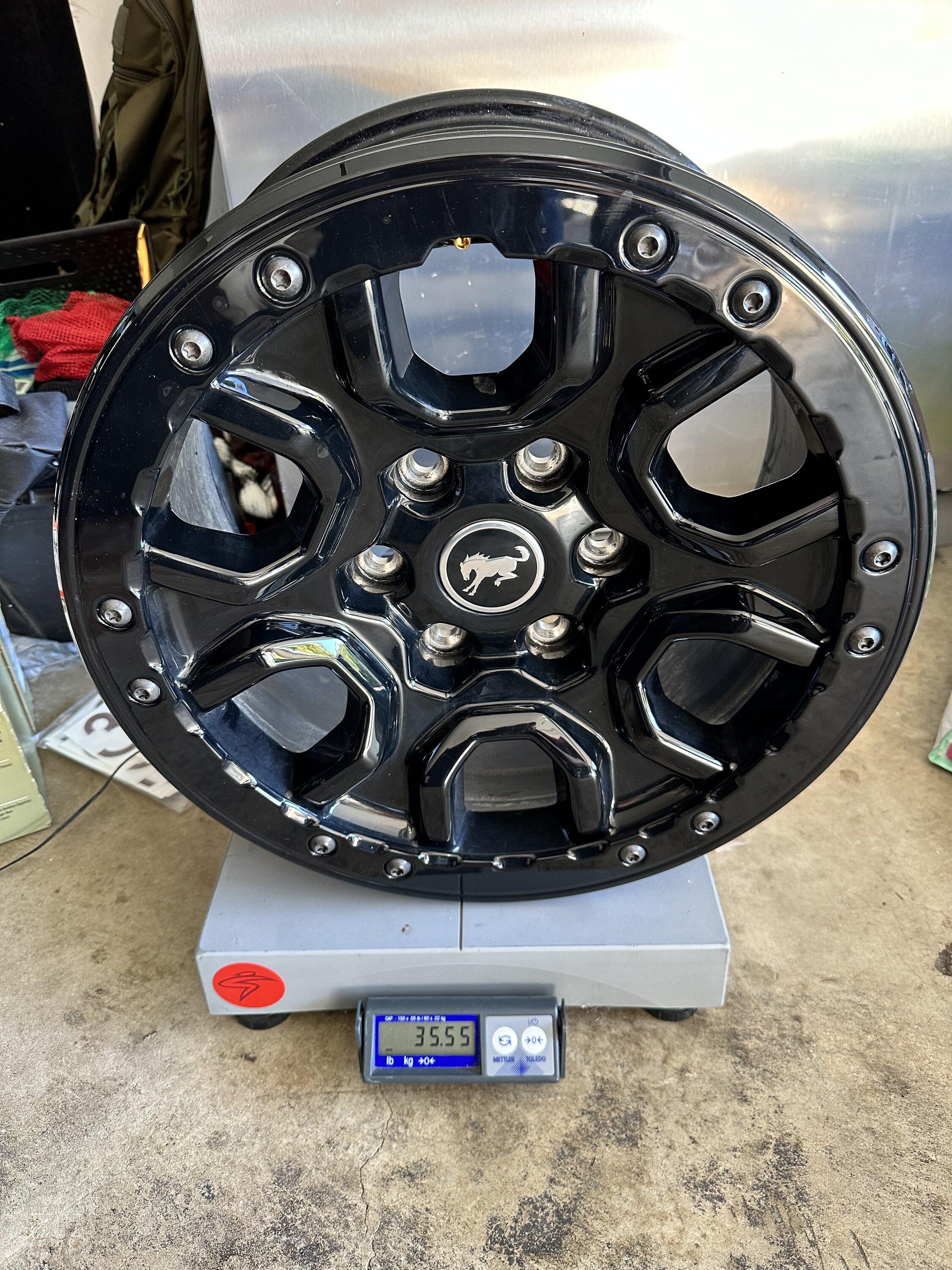

I wanted to report back that ultimately, after waiting for them to finally return to inventory, I have ordered a set of 5 RTR Evo 6s, in Satin Black, 17x9 00mm offset.
I will be removing the OE SAS wheels, removing the TPMS sensors, and transplanting those, along with the 37s to the RTRs. I will also be removing my 1.4" spacers. By my calculations on "WillTheyFit" I am anticipating very little difference in poke from current, combined with a very small amount of shift inboard.
The 35.5lb wheels, combined with the weight of the spacers (perhaps an additional 2.5lbs per), should net me an average weight savings of somewhere in the range of about 14lbs. per wheel.
Which is amazing!
Thanks to everyone who made great suggestions and asked helpful questions on this thread!

Searching the forum it looks like the OEs weigh in about 35#.

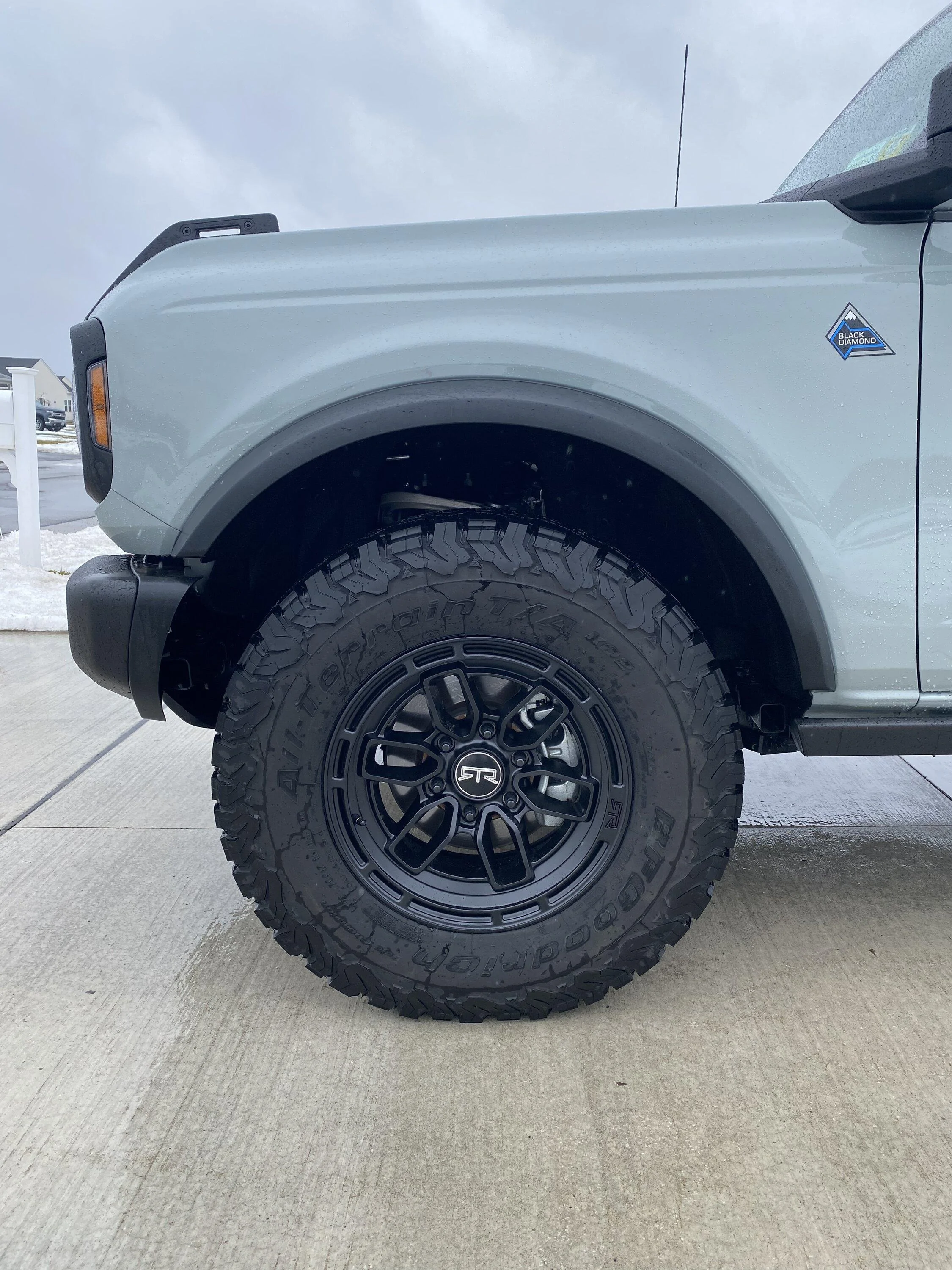

RTR EVO6 wheels weigh in at 22lbs. If you get the +30 offset wheel, it will be similar to stock, if you get the +0 offset wheel, you will have a slight poke.
I’m running the EVO6 wheels, +30 offset, on my non-SAS Black Diamond and love them.

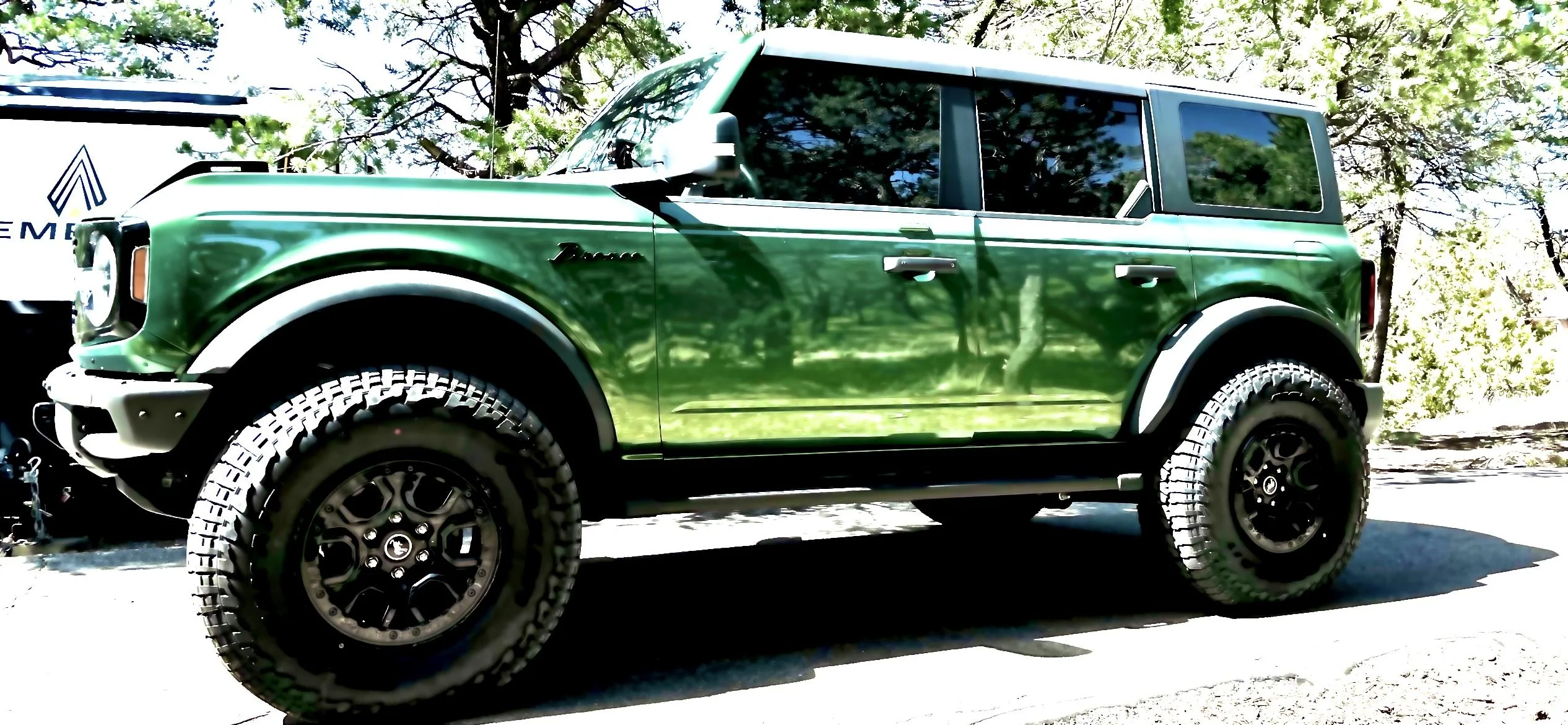

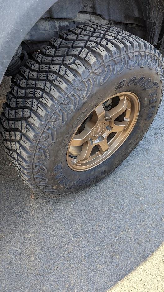

Looking back at this picture - are you running 285/70/17s here? @Little Foot? I just scored some everglades wheels for my non SAS BD with the same specs. Just looking to see what they will look like. I may stick with the Grabbers until they wear out.

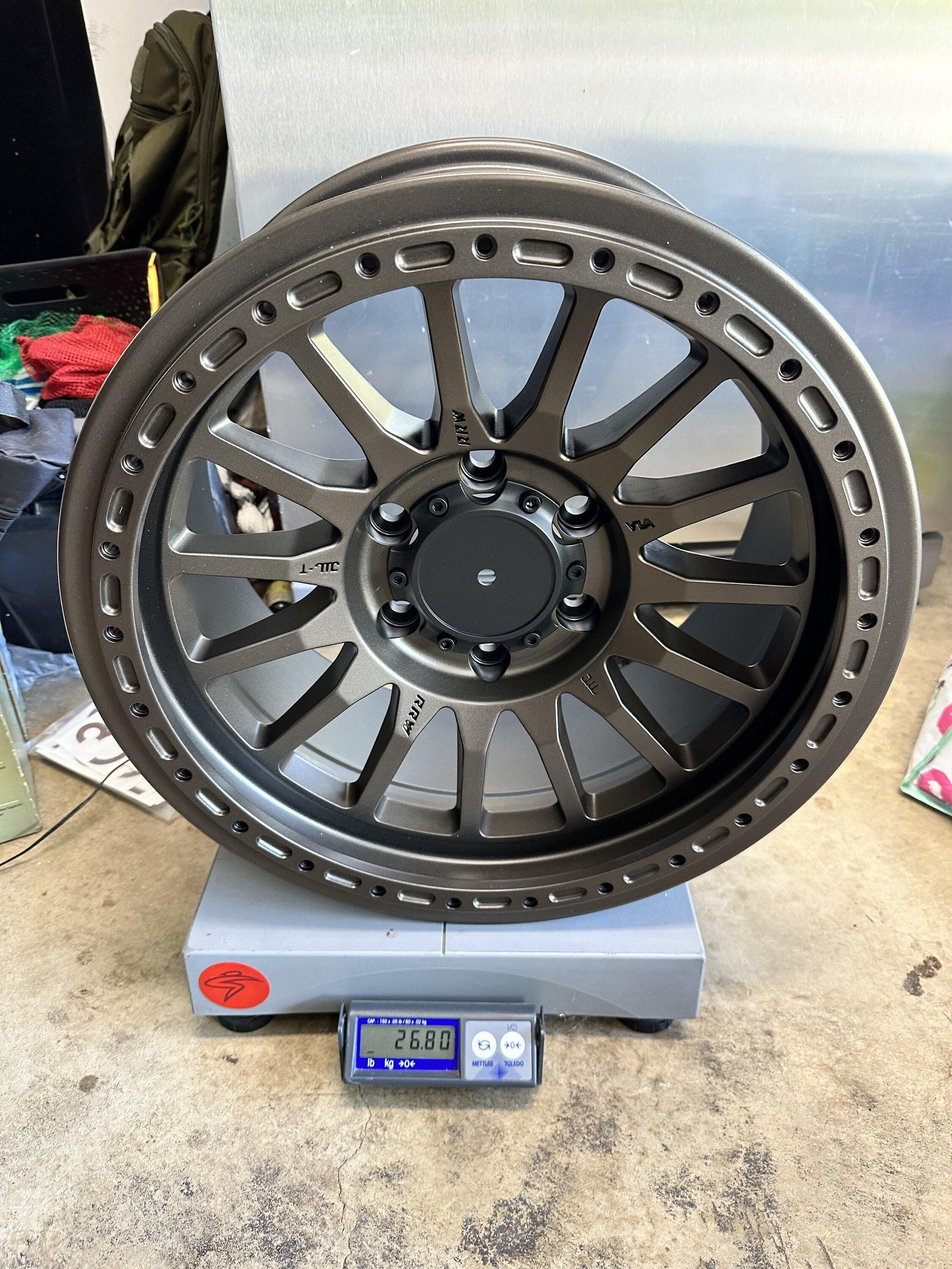

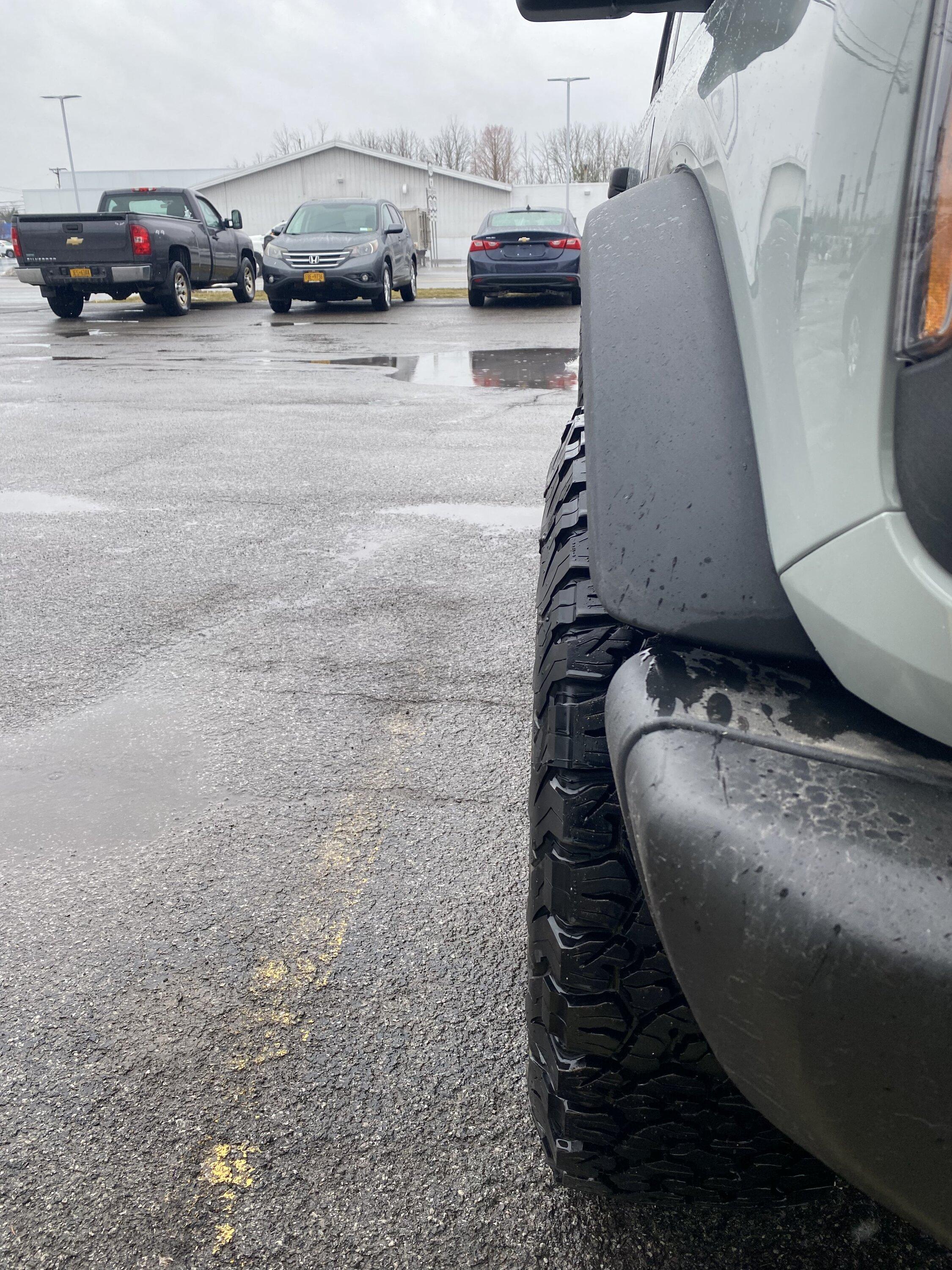

I replaced the factory beadlock capable wheels (+30mm offset) for a set or RRW 0 offset wheels. New rims are about 8.75lbs lighter each. Offset looks perfect to me. Tread still covered by SAS fenders with a bit of sidewall sticking out.
William
Santa Cruz
23 Wildtrak
What model and color are your wheels? Also do you have any good pictures? I have a Eruption Green Badlands SAS.
