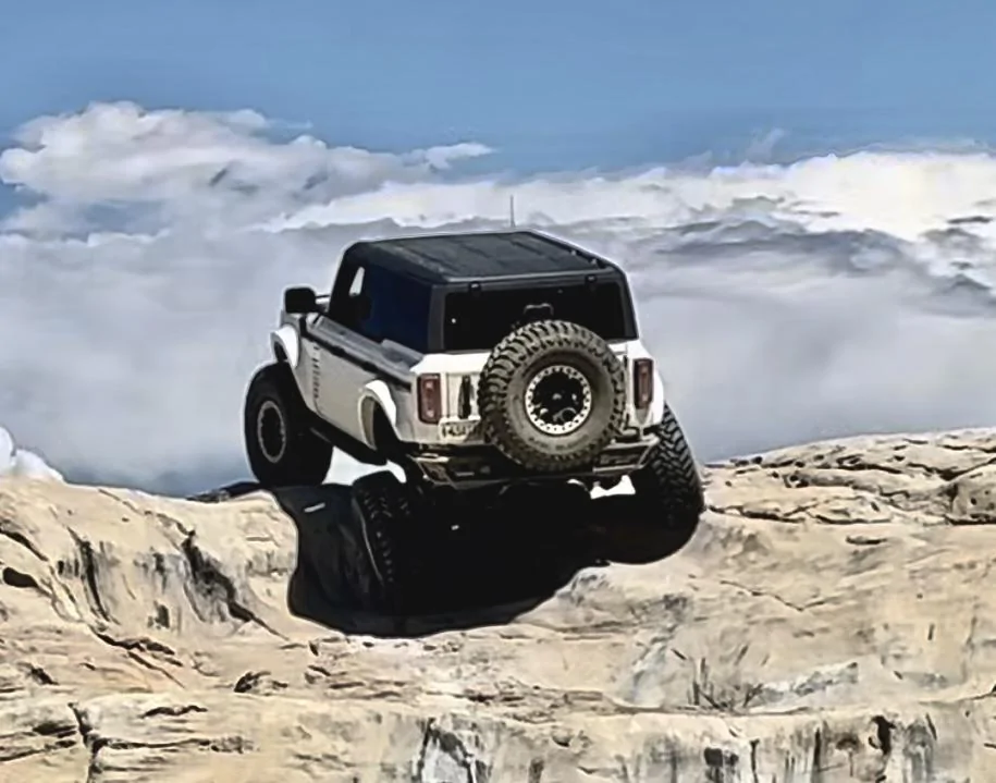

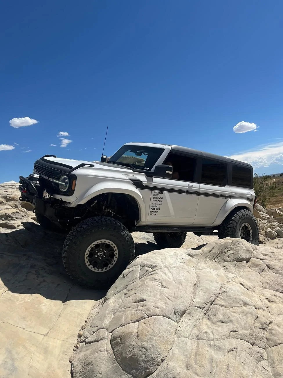

Seems like you’ve been provided some great information reading the feedback on the thread. That said-I know it’s Taboo, but there are cases where a body lift comes in handy. Gives you that little bit of extra clearance for bigger tires without compromising your angles. Running a full RK setup on the back of our rig with portals, 40’s, bigger fenders, and a 1 1/2” @Mikellis Lifts body lift we are just about perfect on tuck in the back. The body lift was just the right amount to clear without needing to cut body parts. People hate on them as they can look absolutely horrible with too much added and no other aesthetic corrections to fix the gap, but they have use.
