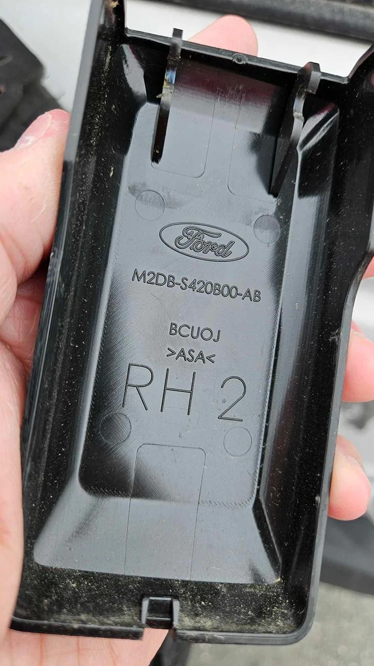

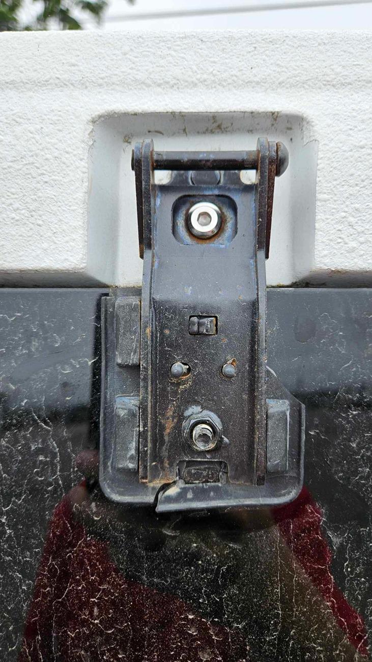

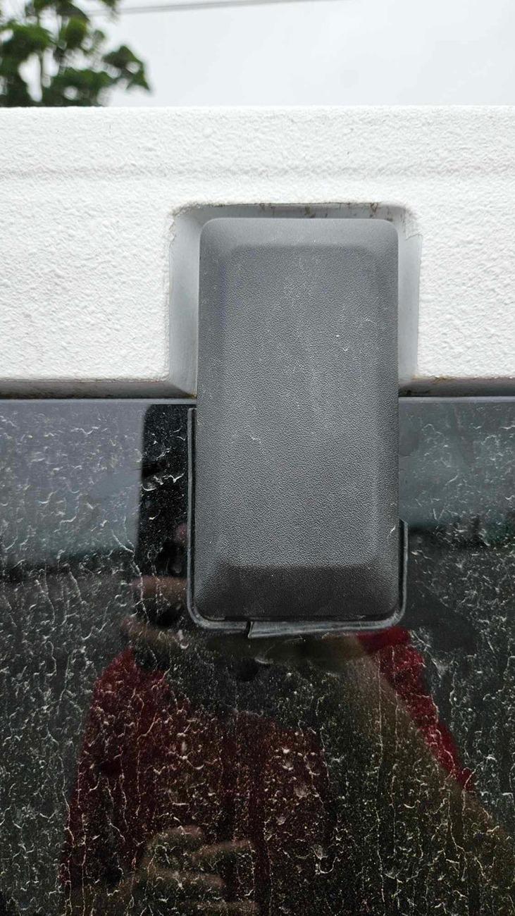

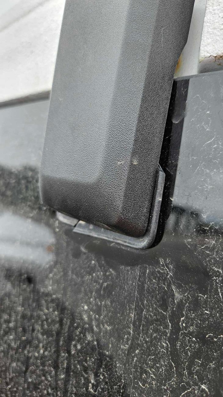

Anyone else have this issue? I have one side broken and both sides the hinge covers are always popping open. This is an Anderson Composites hard top but I believe they are OEM Ford parts? I have not gone to Anderson yet but I will try that angle to see if they can get me the parts, whether I have to pay or not. The issue looking at the Ford parts diagram is I think I need the entire back window to fix this issue perhaps.

You are correct they are ford parts. I don’t have this issue on mine. Hope it gets resolved easy my man

Whoa, that's wild. I've had mine over 2 years and have only broke the bottom parts myself. That was too comoe match them with the body

They're sending me the plastic part on the glass, and new covers as well, for free which they didn't have to do. We'll see if I can get it disassembled and back together correctly.

Finally got around to replacing them yesterday. One of the broke immediately when I tried to install the hinge cover again, the other one is holding up. From what I can tell that piece in between the metal hinge and the glass only comes with the glass itself, so I guess I'll have to ask Anderson to send me more pieces. They seem incredibly brittle, I don't know if they're a bad batch of them or that's how they always are?

So I have officially gone through three sets of the hinge covers and that base plate you are referring to. I was told by a manager at Anderson that the latest set they sent me that I just replaced is supposed to be better quality since they changed some materials up on their end. Both ended up breaking about a week ago. I’m in contact with them again. They are extremely low quality molds and not sure if there will be resolve here. I’ll keep you posted.

We reattached mine but I haven't plugged it back in yet to see if it actually works. I also had some more mechanically clever guys (actual mechanics) install the last plastic spacer they sent and it worked this time. So for now my top is back together. If everything falls apart again I will probably just try buying the $700 back window from Ford. Hopefully it fits.
