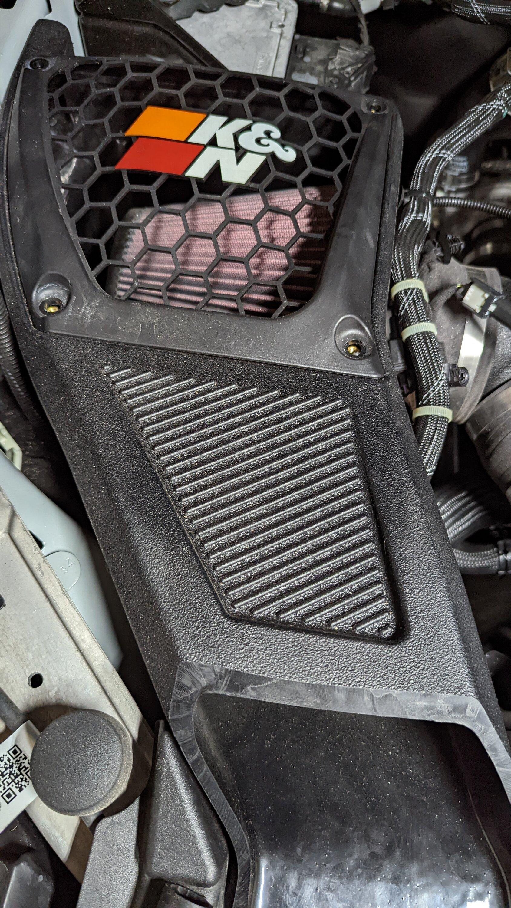

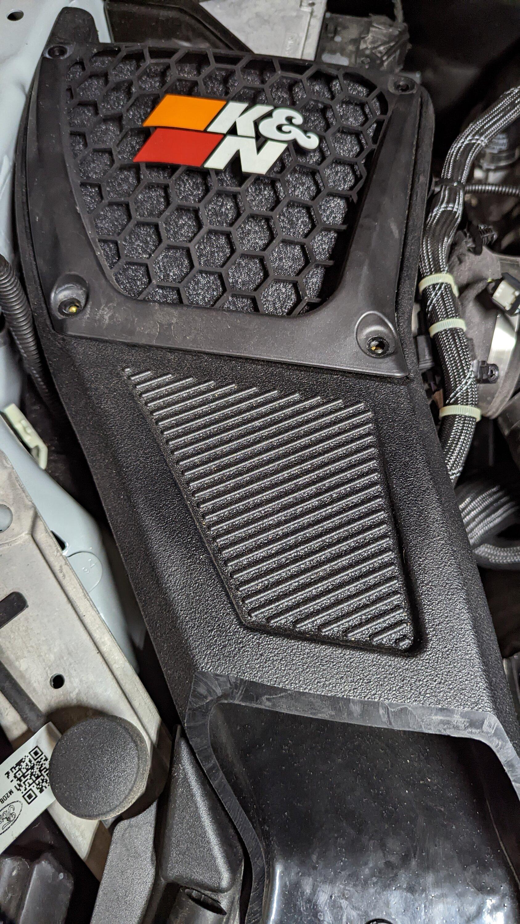

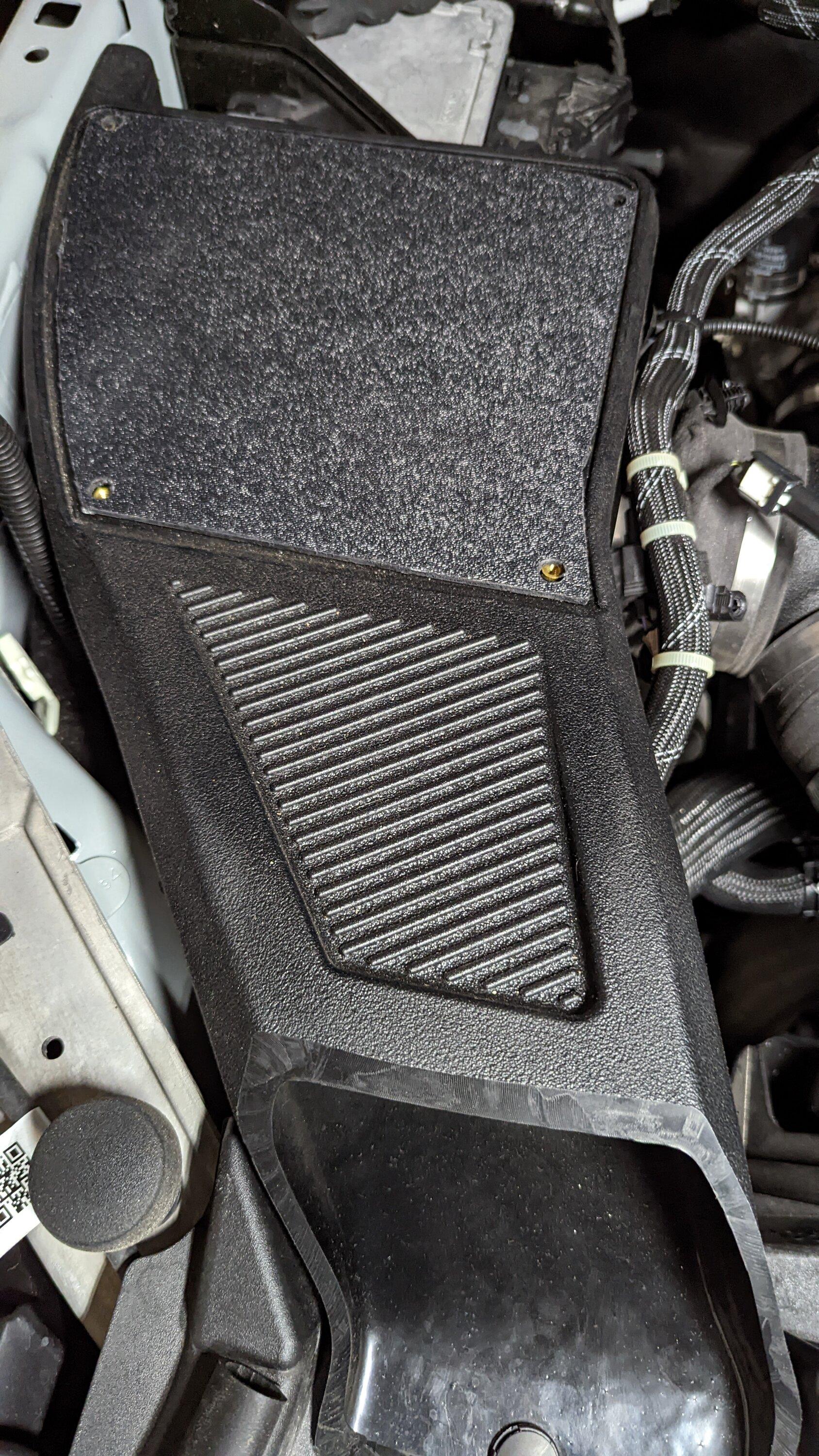

So I went ahead and created a custom piece of abs plastic to cover the open lid of the K&N cold air intake. I h Ave Brent Estes this all day today.
Todays temps were about 65f
I ran the car for about 40 minutes mixed city and highway driving at a decent speed. At this point the temps were...
Oil - 205
Tranny - 200
IAT - 88-115
So I began to lay into it stand still to 80mph over and over
The temps at this point we're...
Oil 212-220
Tranny 205-210
IAT - spiked at 125 and began to drop as I accelerated.
Testing is still not complete but so far putting the lid on the CAI has dropped my IAT considerably. No more spikes to 170 and the faster I go the more the IAT drops. I also haven't lost any power yet. Keep in mind weather has changed alot so not sure if that has a part to play. Either way I've been hitting it all day with no issues.
I will keep testing and see but it looks to me that I should be looking at.
Upgraded intercooler
Colder plugs
Raptor hood and fenders to extract air lol.

I have also just purchased a 12x12 piece of abs plastic and I am going to attempt to fabricate an exact fitment piece for the k&n cold air intake lid cover in hopes to drop the IAT temps I will send updates and pics when complete.

I really don't know if the CAI lid cover made the difference or not but I have not lost power since. Even on map 3 on 94 octane. It keeps pulling now. But it has gotten much cooler outside. So who knows.
