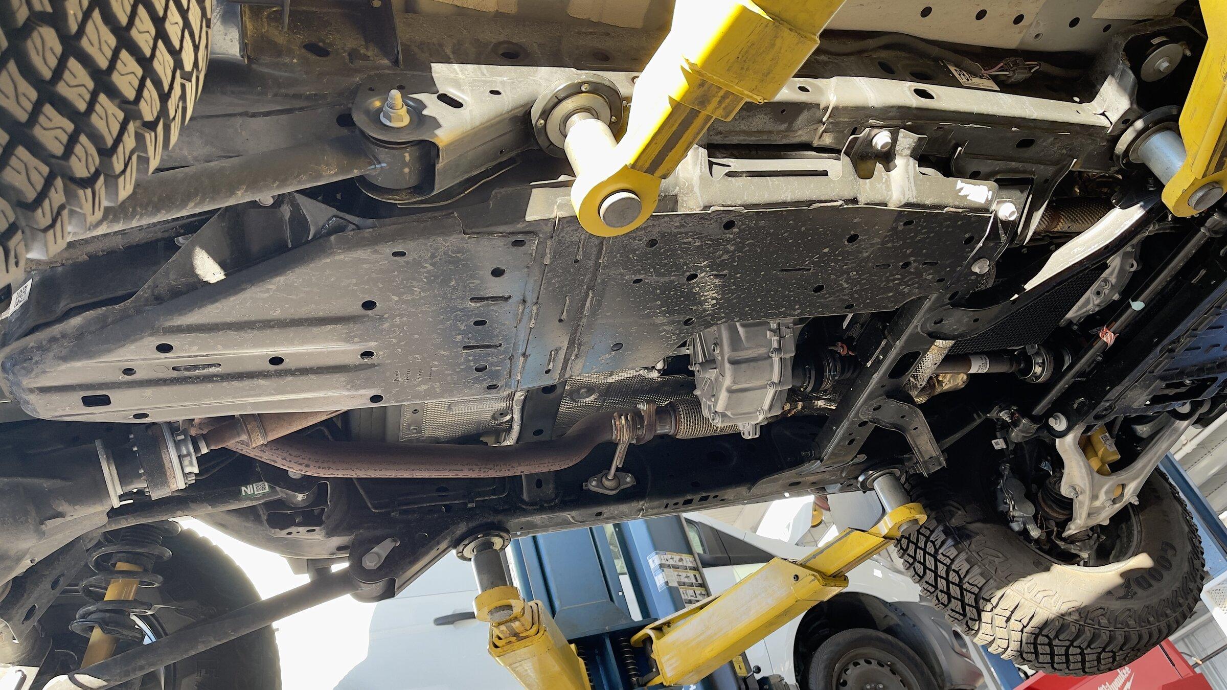

There are a lot more places on a Bronco to jack with a bottle jack. And they store so much smaller. Have you looked into one of those?
Ford Bronco Hi-lift jack points? IMG_9409
Felix808
55
4,896
10,459
SRV CA
It does look like the rock rails are too close to the body.

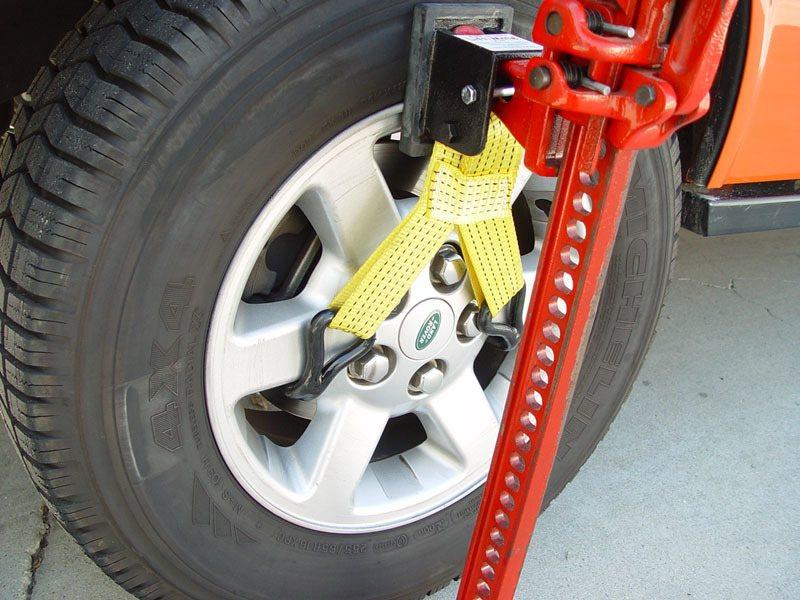

There is a hi-lift accessory that lets you lift from the rim of a tire. Very useful if you're stuck but not so useful if you need to change the tire.
Should always use a jack stand changing tires never trust a jack ;) But yes the lift mate is great, especially if you just need to raise a tire to stack material under for traction.

I would go with a wheel adapter if it's not to change tires, i would not trust the slider or bumpers
Once can actually change a wheel with the method in the above photo. Simply lift like above, place jack stand under vehicle, lower farm jack, change wheel, re-lift, remove jack stand, lower jack, vroom!
