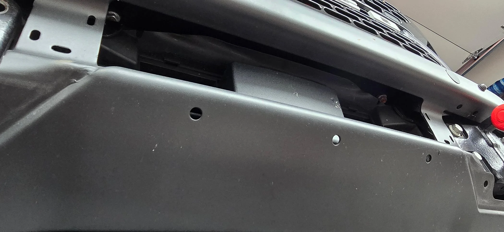

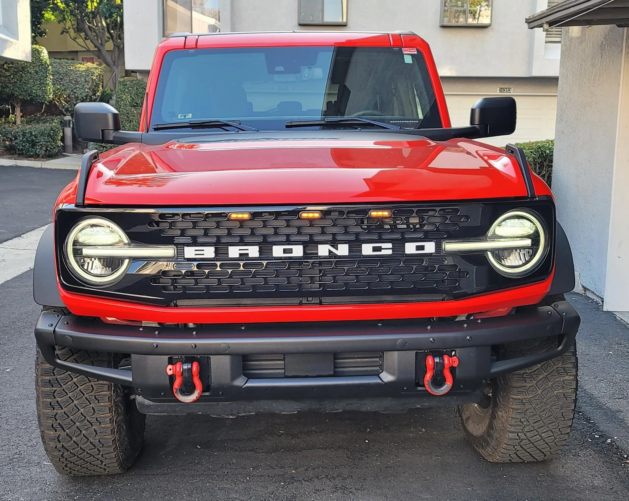

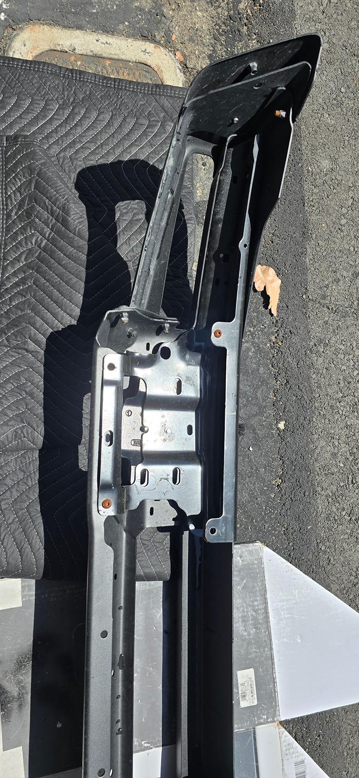

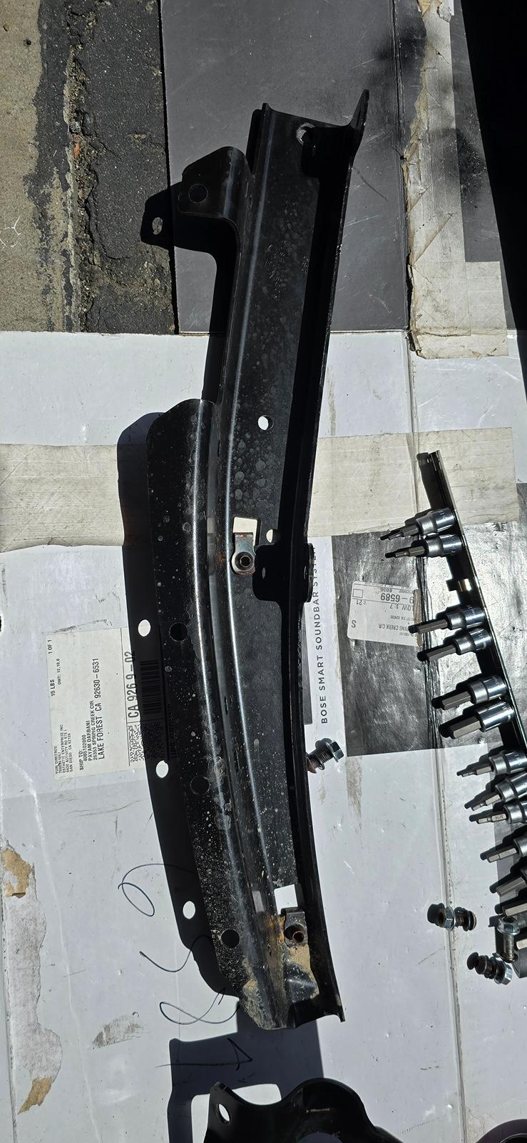

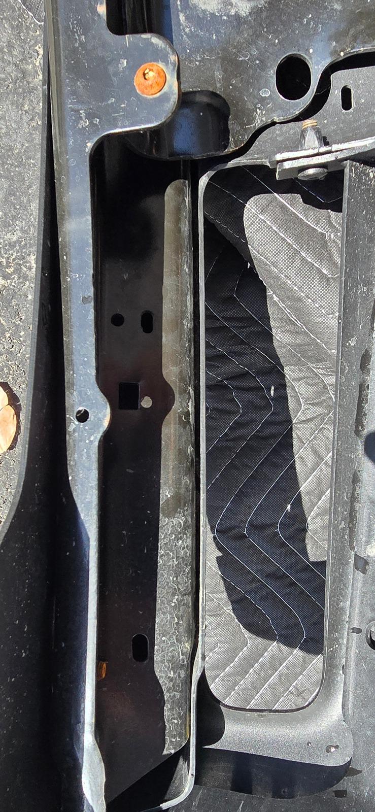

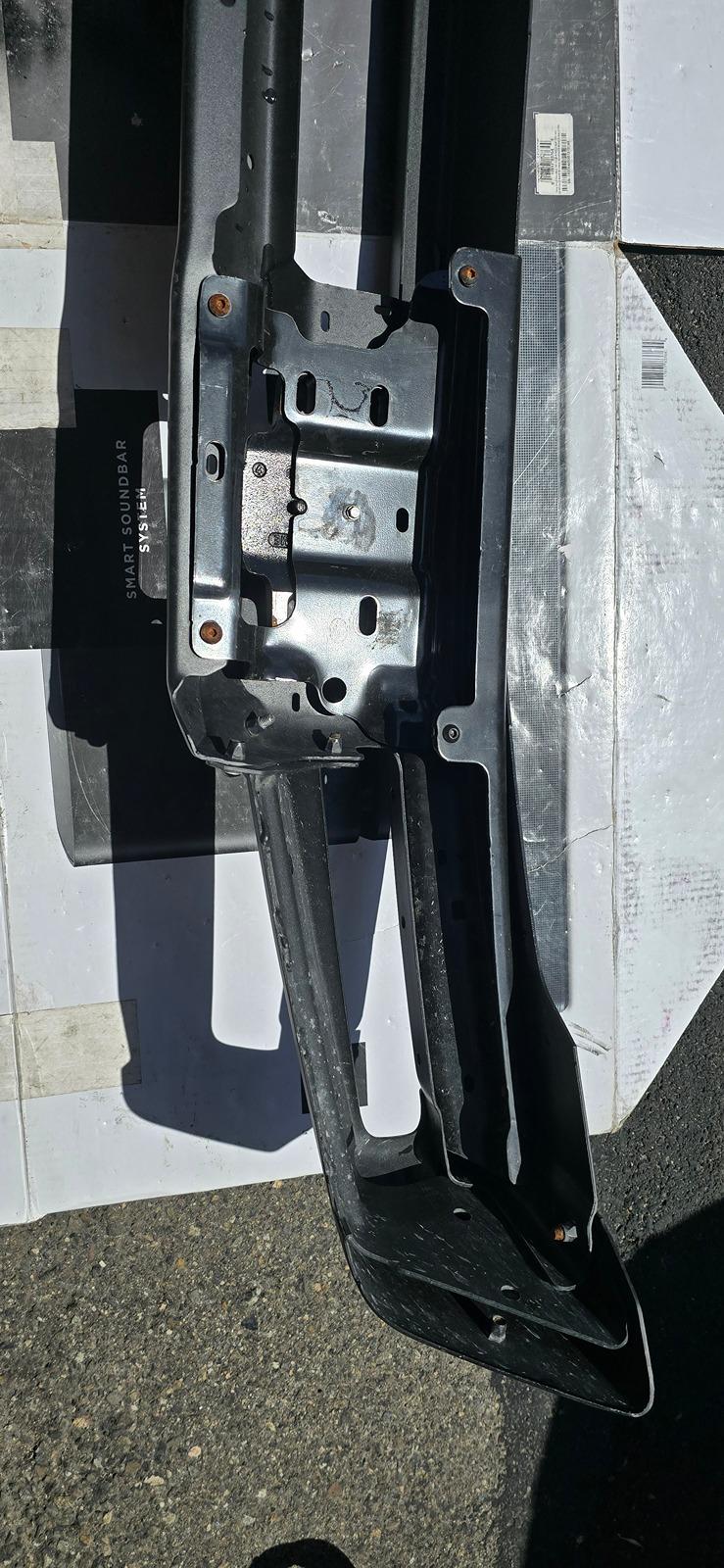

My Wildtrak came with a plastic front bumper. Near the end of last year, I bought a modular bumper from a member and installed it with the expectation I'd eventually install fog light kit. I bought a Diode Dynamics Triple Fog Light Kit around Christmas and I finally got a chance to install the kit last weekend and ran into a problem.
When I bought the bumper, I noticed it was missing some bolts just below the opening for the intercooler, but that wasn't an issue. What I noticed last weekend is that the three bolts per side that the fog light bracket would bolt to are also missing and there are no threads to screw anything into. Before I take this bumper apart to add in the fog light harness, what am I missing to be able to make this work? Some captured nuts or something? The exploded view of a bummer on the parts website doesn't seem to be much help.
Any assistance of what I need to order would be appreciated!

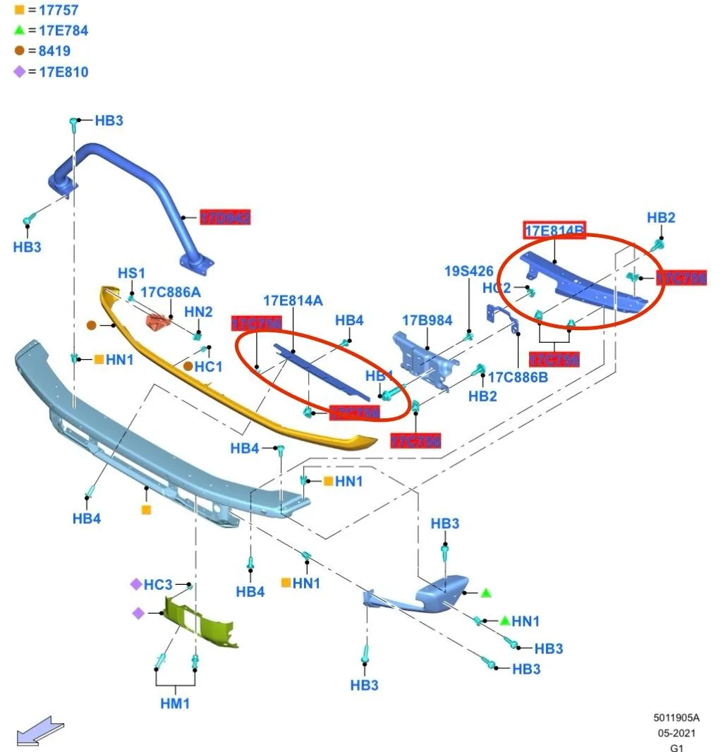

Looks like you’re maybe missing the actual reinforcements that go into the bumper.
LH: M2DZ-17E814-B
RH: M2DZ-17E814-A
Center: M2DZ-17E814-C
You’re also going to need some of the HB2 and HB4 bolts in this diagram (not exactly sure how many though)
HB2: W717964-S450B
HB4: W721447-S900

Although looking at the pictures again, are you sure that’s a factory modular bumper and not a knock off?
Zooming in but I can’t tell for sure… the bolt heads don’t seem to have the bronco stamp on them. But again I’m zooming and and it’s pretty pixelated at that point. My MY22 has the bolts stamped. Again hard to tell but if it’s a ford bumper and the original owner gave him the bolts… should have that branding on the bolts.
But agreed it looks like it’s missing the parts from your previous post.

It's hard to say for certain judging by the bolt heads, this might be a Chinese knockoff. The left and right upper reinforcement brackets on each side should have three attached bolt clips on the brackets for the bolts to screw into, which are more than likely missing.

What is covering the holes where the front park aid sensors normally go? Is that something you installed or did it come like that?
Ducati1098
10,021
23,305
Midwest
It came like that.
What is it though? It’s hard to tell from the pictures but it looks like little spot welded plates that you would knock out if you needed to use the holes.
They are just a plastic cover for the sensor holes. I think I may have time this weekend to take the bumper off and take some pictures what the backside looks like.
I'm not certain on this, but I think that these sensor holes might be a good test of authenticity. Each hole is keyed differently on the Ford modular bumper and they are all the same on the Chinese ones.
Thanks. I will try and remember to get some pics of the holes from the back.
