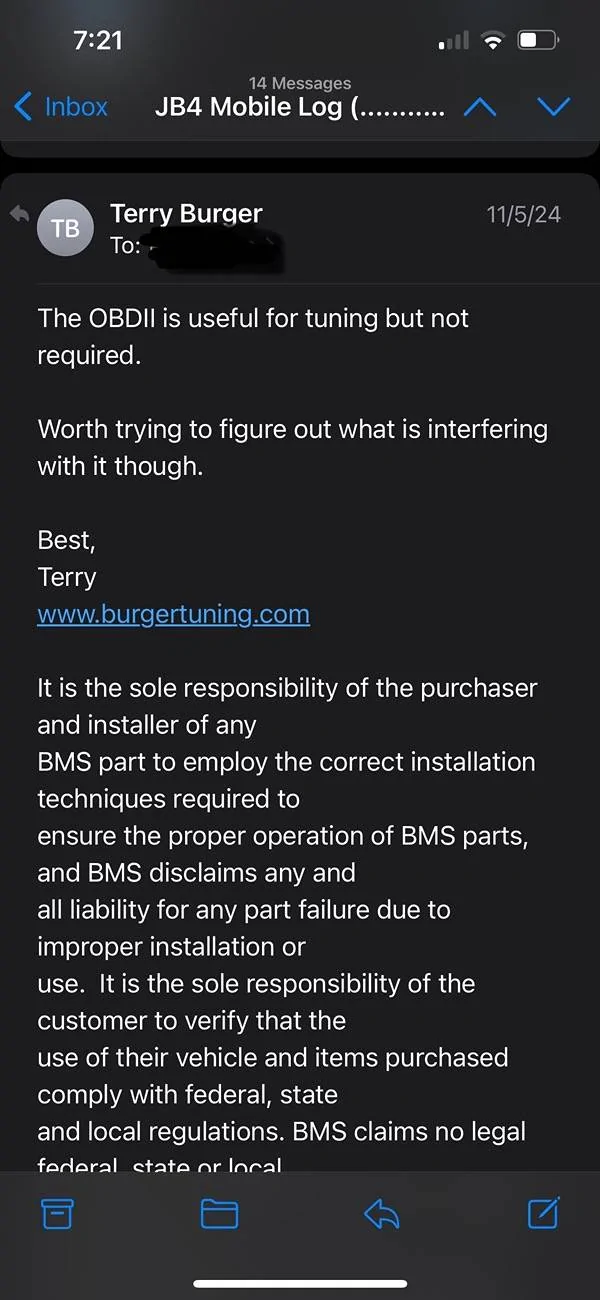

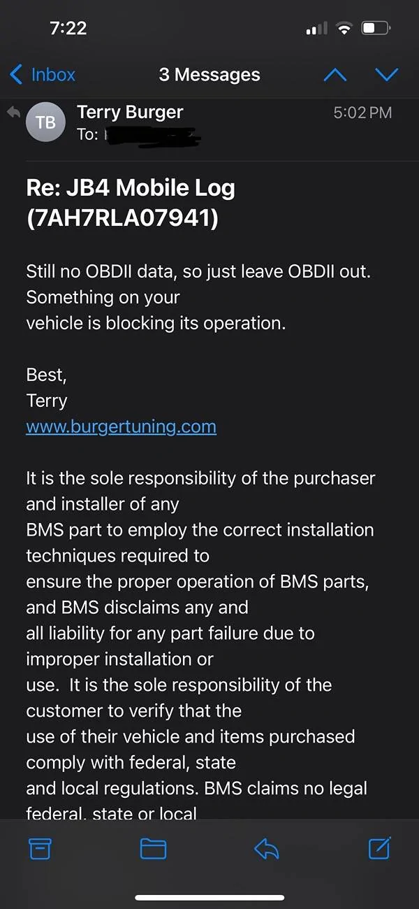

Terry states that the tune stays on via Bluetooth and does not require the cable.
