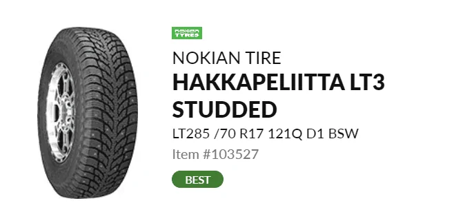

My Bronco I am running a goodyear Duratrac studded in 315/70R17 and my raptor is on Nokian Hakkas in the same size.
The goodyear is a good al season that is winter rated and the studs help on ice, but its not the same performance that you get out of a true snow tire. like the Nokian.
looks like there is a nokian and a copper avalible in your size:

Thanks, @Mikerider! The nokian hakkas look like a good choice. Now to find them locally….seems like they’re on backorder. Appreciate the feedback on true winter tires too, other posts I’ve read have said the bronco can be a bit slippery in the winter so I think true winter tires are the way to go.
