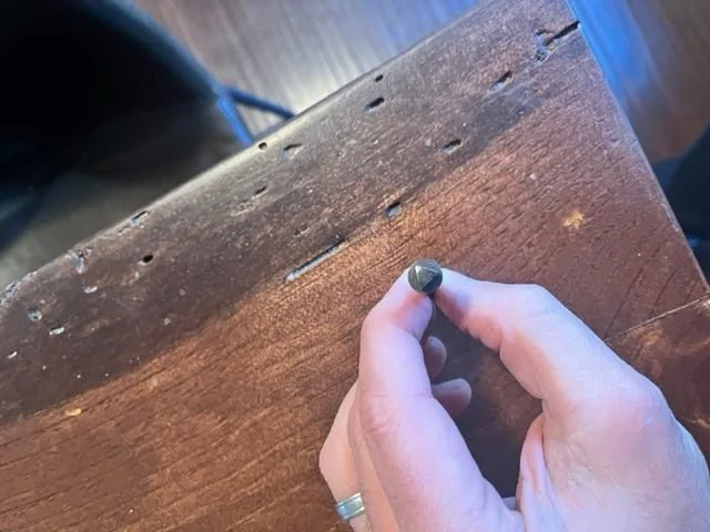

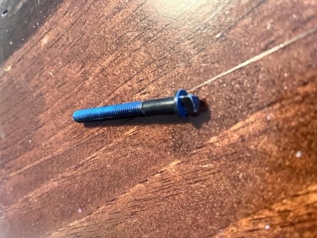

thanks again for our help. I'm going to attach a couple of pictures showing the bolt. hoping this helps if you are using the same type. again this bolt is located in the rear bracket to secure the clamp to the roof.

Anyone have the exact thread pitch and length of this bolt handy?

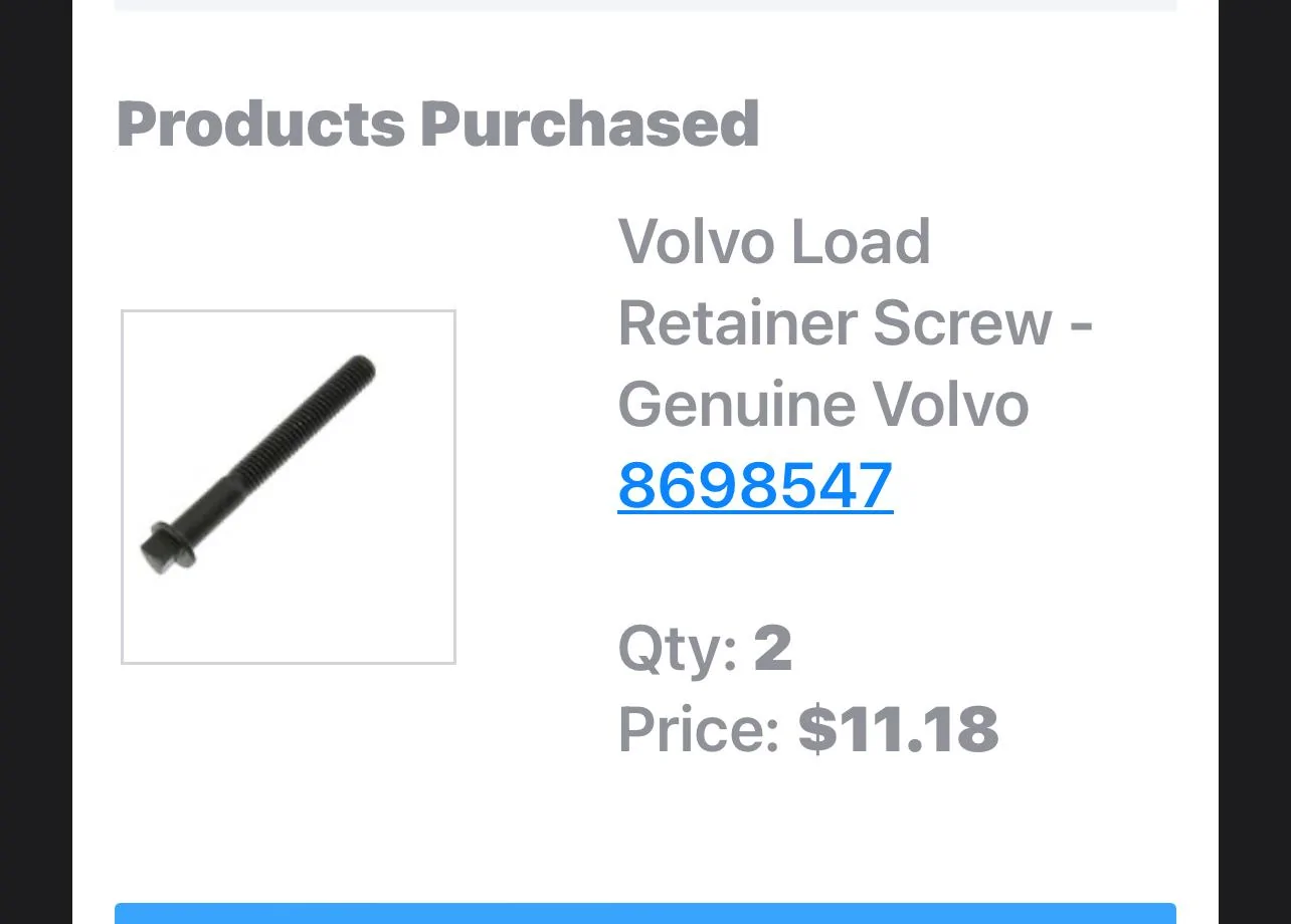

Someone on another thread purchased this Volvo one and said it worked. I just ordered two that will arrive in about a week to see. OEM Volvo Part # 8698547

https://usparts.volvocars.com/p/Volvo__/Roof-Rack-Bolt-SCREW/42820143/8698547.html
Just received and yes. I ordered two from some store named euro online as they were cheaper. Triangle special head and just installed fit perfectly. It’s a pain to install. Best to take off the one bolt cover so you can see the cylinder it has to screw in to with a little screwdriver to make sure it goes in straight as it spins.

FCP euro is where I ordered from when I googled the part number

Apparently you can get It on Amazon too. The number in the title isn't the Volvo part number which is confusing. In the description it says that the Volvo part number is 8698547 which is the part needed.
Volvo Genuine Load Bar Replacement Mounting Bolt - 31463574
